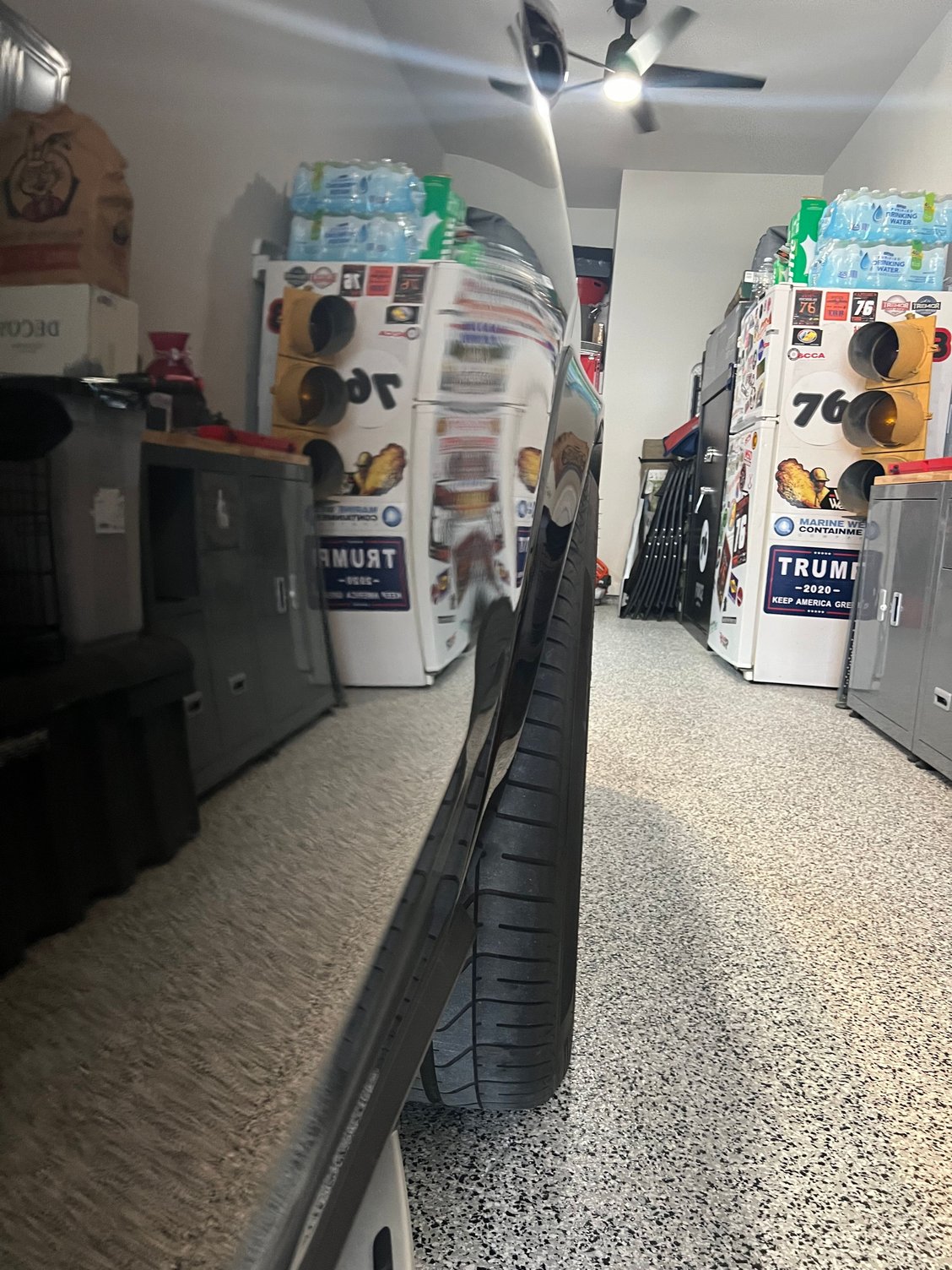

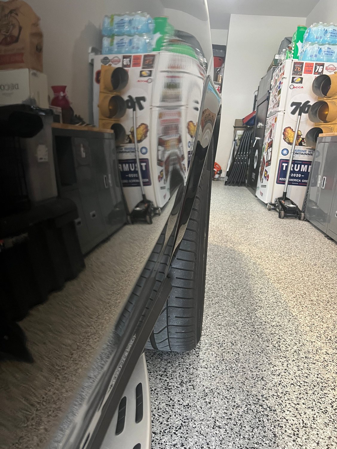

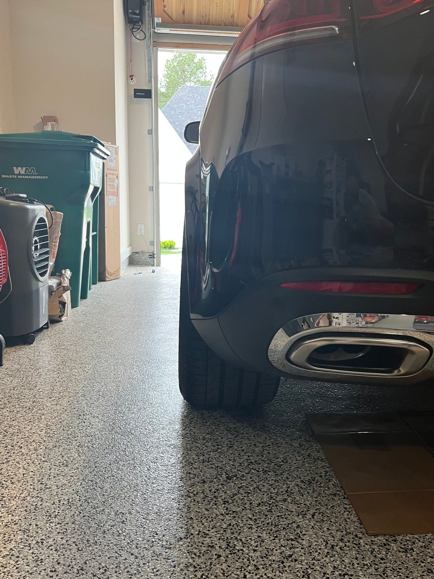

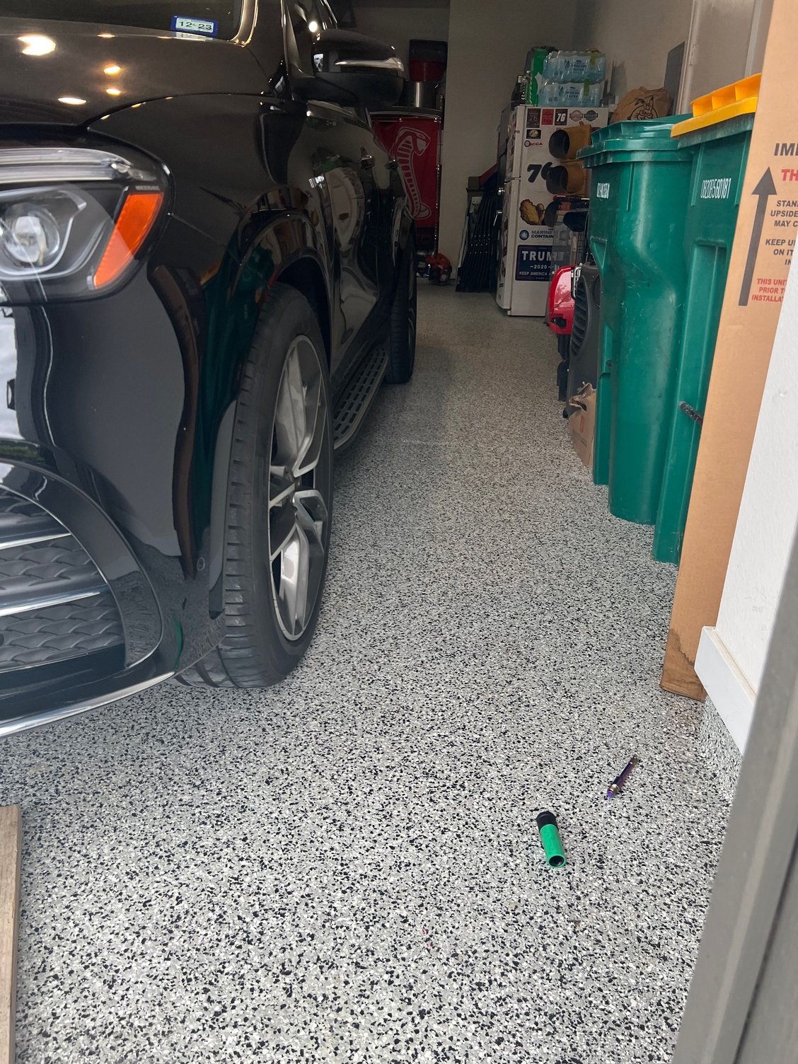

Tire walls are now flush with fenders
https://modeautoconcepts.com/
Front:
MODE PlusTrack Wheel Spacer Kit 12.5mm for Mercedes Benz AMG SUV inc. GLE-Class GLE53 GLE63 W167 GLS-Class GLS63 X167 & Maybach GLS600
5x112 / 15x1.25 Ball (OEM Wheels) / 66.6
Rear:
MODE PlusTrack Wheel Spacer Kit 18mm for Mercedes Benz AMG SUV inc. GLE-Class GLE53 GLE63 W167 GLS-Class GLS63 X167 & Maybach GLS600
Stock
18mm Spacer
Stock
Front-12mm / Rear-18mm
18mm Spacer
