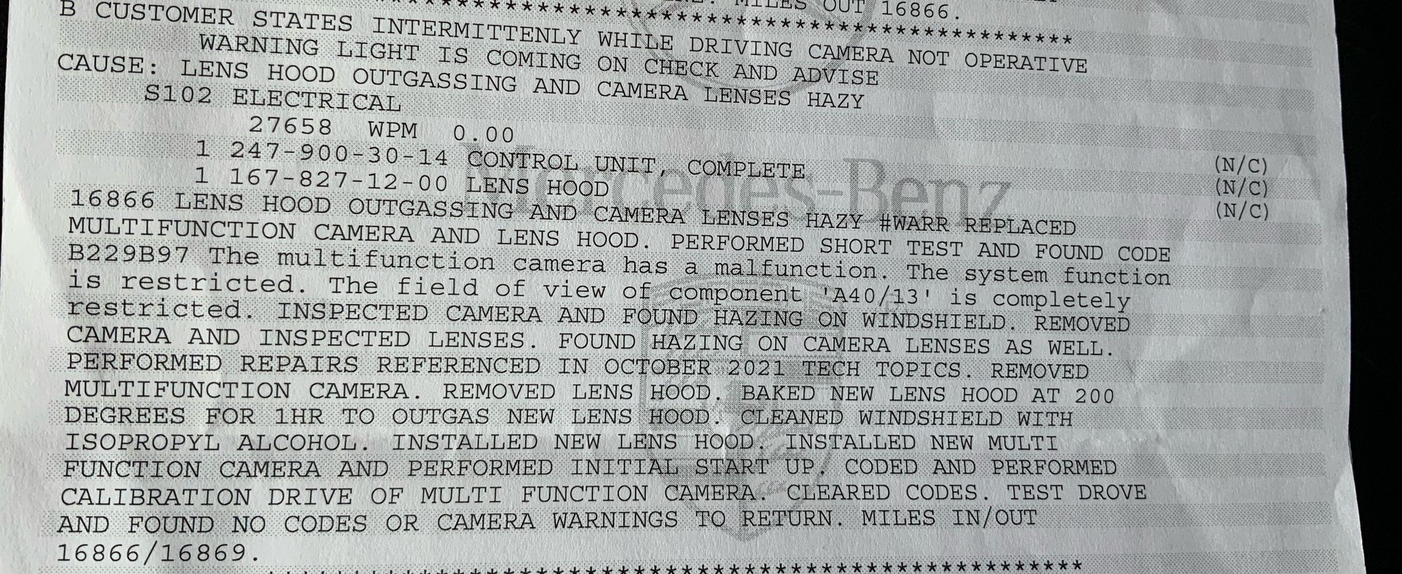

It might be coincidental with the door. The other symptoms are similar to mine and others with the camera housing Outgassing and clouding the camera lens.

Thanks for the info but dont think it was the camera. The car tracked the road edges OK (Lane keeping assist) even when other "active assist" functions were inoperative. I am guessing that the problem was related to an interlock safety system that sensed that the "locked" back door was not fully functional. Maybe a software bug? All works fine again. A very complex system with all the "assist" functions. Will keep your experience in mind but hopefully will not experience it.

It never had any noticeable affect on drivability…just got the messages, some that didn’t seem relevant to a front camera.
