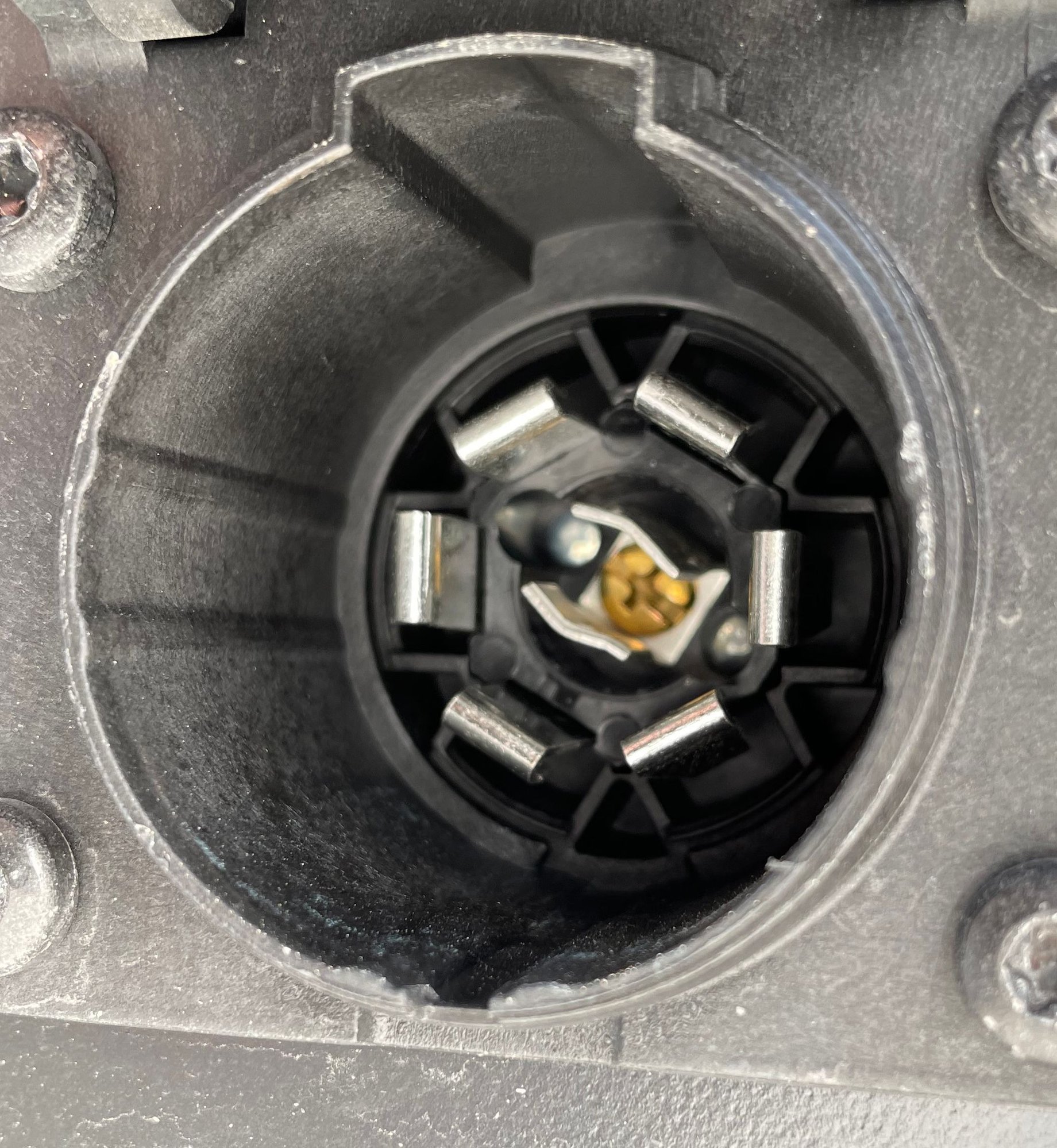

I'm usually active on the E63 forum as thats what I drive but I just picked up a '22 GLE350 for wife and I was hoping to find an answer on this forum. I am curious to find out where i can get a hitch plug to connect the lighting off my enclosed trailer. Looking at the plug close up its like nothing I've seen prior as its a 6 plug with a center pin. I have not been able to track down any vendors offering a workable connector and I haven't been able to find any previous discussion here. Has anybody found where one can find a plug so I can connect my traditional, straight 4 pin trailer connector? Figured I'll have to go through the dealer to get something but thought worthwhile to ask others for possible options unless the item I found on Amazon would work?

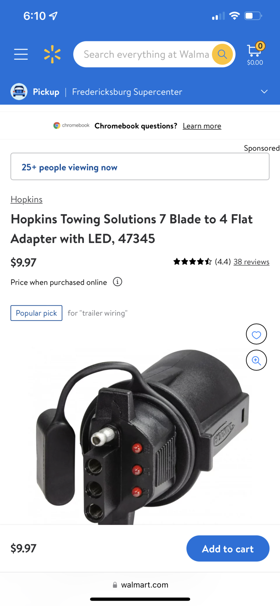

You can buy a 7 pin connector to a pigtail connector at a local U-Haul store.
You can also order one on Amazon. Looks like Walmart and AutoZone sells them too.

If you have LED trailer lights there is one with a resistor to simulate incandescent lights. At least this used to be necessary. Here’s what I used in my GLE. The 5 pin also works with a 4 pin flat.
