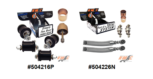

Amazing but true - On the GLE the often quoted re assuring Full Front & Rear ‘4’ wheel alignment IS NOW ONLY BASIC TOE “DIRECTIONAL” ADJUSTMENT !
THERE IS NO LONGER - Front Camber and Caster or Rear Camber essential to adjust tire contact angles spread load more evenly. New car industry’s best kept secret.
Ex-factory Camber is now set at showroom height. It is all to do with cost cutting and ever increasing speed of new car assembly lines. The onus back on owners to fund premature tire replacement.
Nothing to cater for day to day commuting encountering excessive edge tire wear through load carrying or lowering. Or excess passengers side edge wear through high cambered roads. Fitting wide profile tires or just having ongoing adjustment capability for curb knock damage.
SEE SPOILER RE W167, V167, GLE, GLS FRONT & REAR BOLT-ON KITS.

GLE V167 “FULL ALIGNMENT” IS NOW ONLY “TOE IN OR TOE” OUT (DIRECTIONAL) ADJUSTMENT !
Background is last 40 or so years obtaining Camber, Caster adjustment has been quite labor intensive. Requiring time consuming removal of control arms. Pressing out suspension bush. Then pressing in a replacement offset bush at a particular clock setting Example 1 O’Clock for one degree. 3 O’Clock for 1.5 degrees.
Refitting arms / trialing on alignment rack. Then having to repeat entire procedure if setting change needed.
GONE ARE THOSE DAYS K-MAC CHANGED ALL THAT. UNIQUE PATENTED DESIGN BREAKTHROUGH - bush extraction / insertion tools provided and with no other special tools needed, or for arm removal PLUS EASY ACCESS ULTIMATE PRECISE SINGLE WRENCH ADJUSTMENT ACCURATE “UNDER LOAD” DIRECT ON ALIGNMENT RACK !
Whether catering for excess passenger side premature edge tire wear through high cambered roads. Rear wheel squat through load carrying or Lowering height / Roll center for improve handling / safety.
