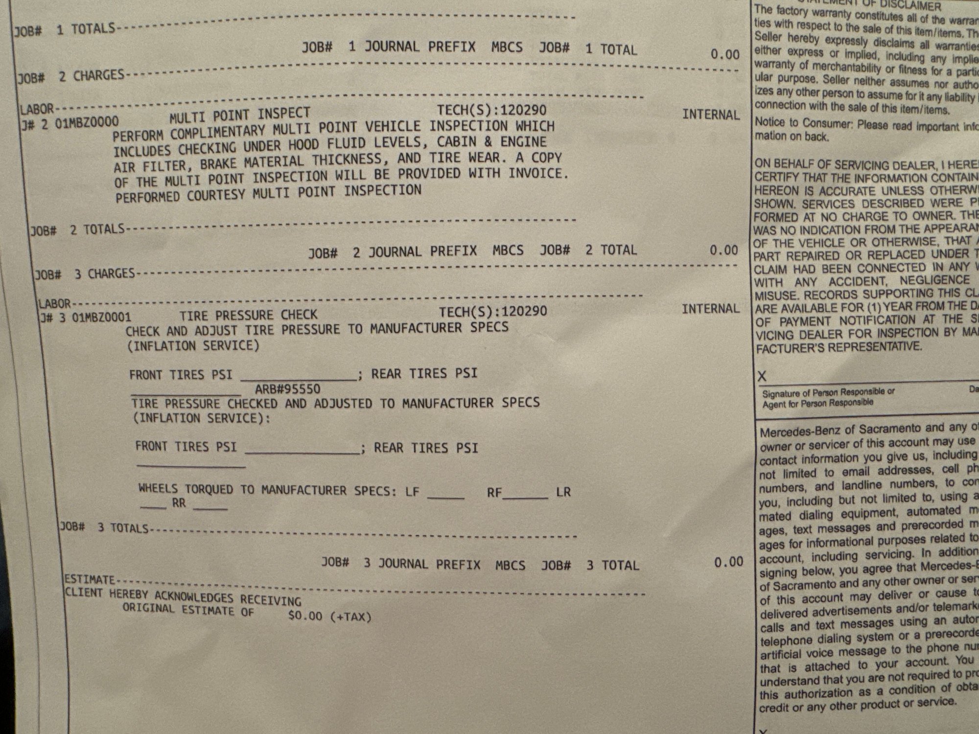

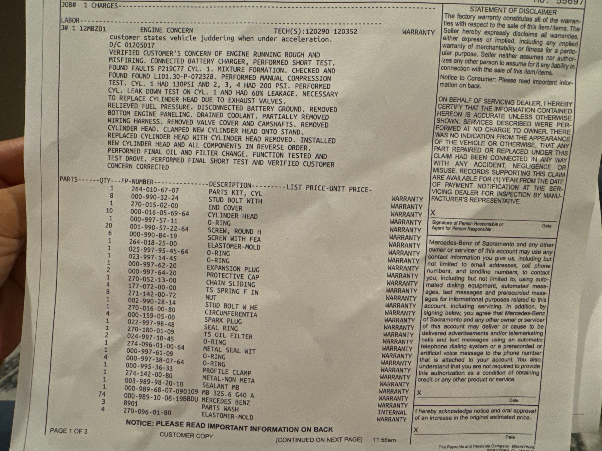

Just had cylinder head replacement on 2021 gle 350- work order attached
I didn’t know this car had the same issue across the board until I started researching it because it happened to me. I heard the service advisor say it was $15k in repairs but thankfully I have an extended warranty.
attaching what they actually did for my car. If anyone knows anything was this all necessary?
Also… they never test drove it bc it was same miles in and out so idk if everything they did was necessary also.
Also… they never test drove it bc it was same miles in and out so I just question the integrity.

I didn't read the work order but I'll make a general statement.
The repairs wouldn't have been approved by the warranty company unless they had been justified.
