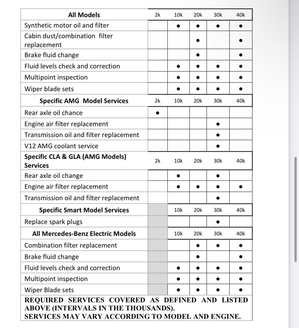

What changed? We are talking about rather specific vehicle, GLE 450 (v167). The PPMs mirror maintenance schedule, so they are 4/40 and not 4/48, the current ones at least. I got the PPM in Dec 2023 and I believe it’s still the latest revision, there is no plugs or transmission oil changes for it, which is in line with the document I referred to earlier.
See the screenshot.
See the screenshot.

Yeah, it’s possible that v167 service schedule is different from other models. The screenshot is from my actual contract. I shared full copy (less page 1) of it earlier here: https://mbworld.org/forums/gle-class...ml#post8899456

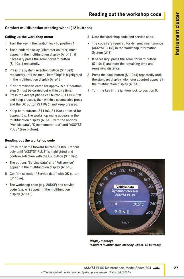

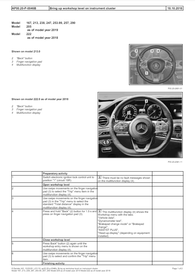

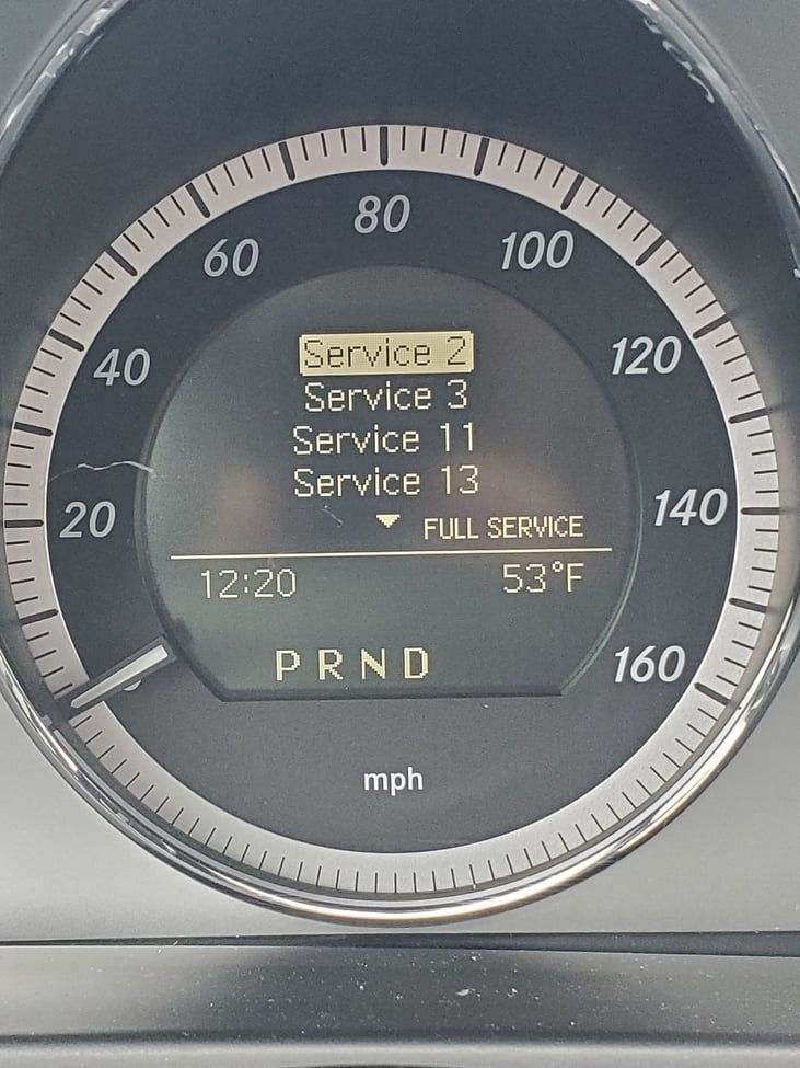

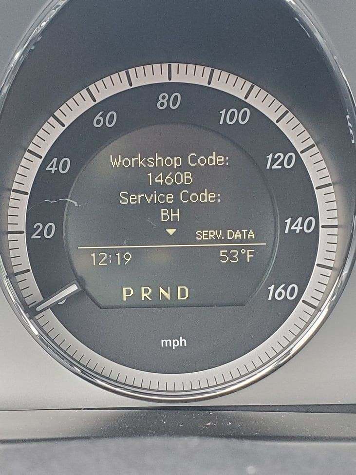

Go into your cars menus and see which service codes are showing. I dont have a GLE so maybe things are different but in my W204 the service reminder started popping up its due, it says Service BH. When I look what service that is it lists them, my case its service 2, service 3, service 11 and service 13. These services make perfect sense because my car just hit 150,000 miles and the Maintenance manual that came with the car shows on top of Service B the fuel filter should be replaced along with the coolant at 150K.
I have heard the service codes are the same for all models but not positive.
Heres what shows when starting the car:
I followed these directions to get into the menus. May be similar for other models, who knows.
Heres what mine looks like when I go into ASSYST PLUS menu:
Scroll down and it lists all the services due.
List of what each service is:
