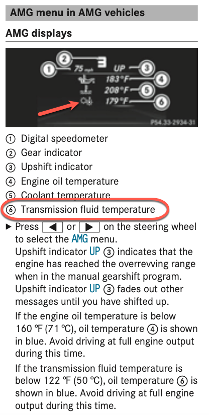

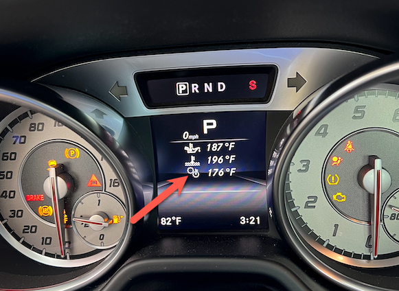

Sometimes you can. This was added to my SL400 (non-AMG) by @BenzNinja .

I see but to clarify I meant from stock when it was sold.

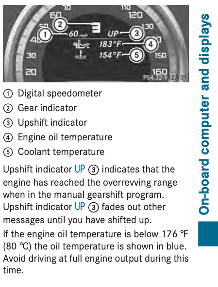

This is from my SL's Operator's Manual and my C-Class Operator's Manual. So, maybe the AMG menu for the SL is different.
SL Operator's Manual Transmission 722904
C-Class Operator's Manual Transmission 722906
Yes it should be different.
