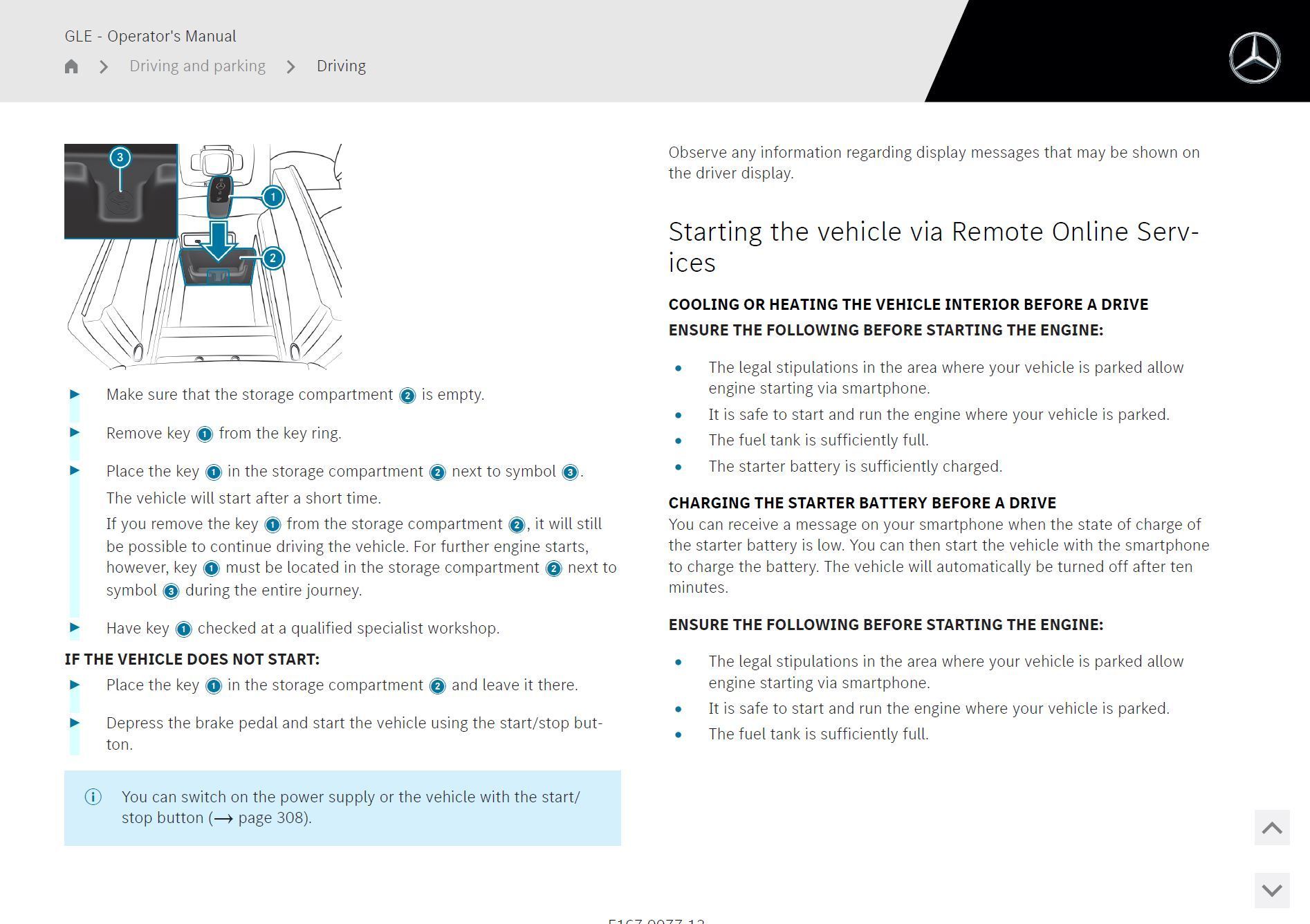

Where is the NFC pad in the 2025 GLE 580?
Just picked up my 580 yesterday and the salesman didn't know where this was located, or if the car even had one. It's the place you put the SmartKey to start the car if the fob's battery has died. It's a flat surface with a key logo embossed on it. Thanks for any tips.

Check the very front of the center storage console. On my 450 there is an indented area to place the key in.

You mean in the bottom, under all the crap I store in there?

Yup.

Thanks, GregW. For the benefit of others who may someday have this problem, I took a photo (below). There's a little sort of cradle for the fob to sit in (at the top of the photo, nearest the front of the car). You can just barely make out the NFC logo in the cutout.

I finally found the relevant page (p. 312) in the manual:
