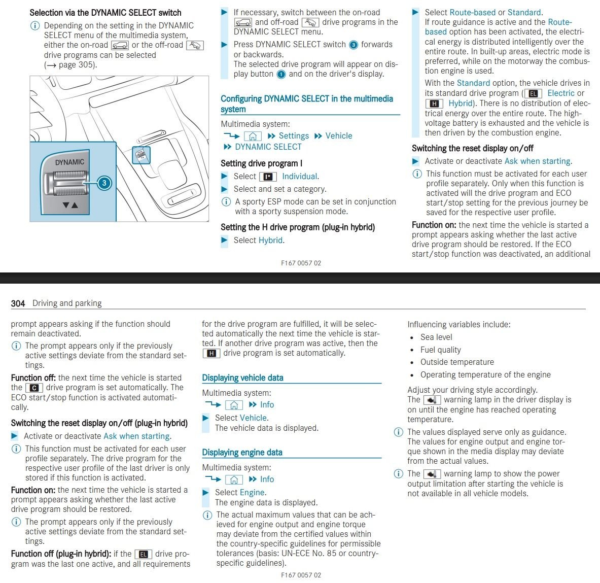

Originally Posted by Elvisfan0108
There is no option to start in a previous mode on a GLE that I’m aware of.
Originally Posted by G63GT63SE
OP said he has and changed the setting. Unfortunately it takes forever to ask you to start in the previous mode.
That option has never come up on my wife’s car. I’d certainly like to see a screen grab of that option on a GLE.
Actually there is that option (please see the attached manual: "Ask when starting"). But it is totally useless, because you have to tap the screen each time you want to select previously used mode. From my opinion, selecting that mode using Dynamic Mode Select Switch is much easier.
Note: "Function off (plug-in hybrid)" doesn't work in my GLE. In any case electric mode is started.
