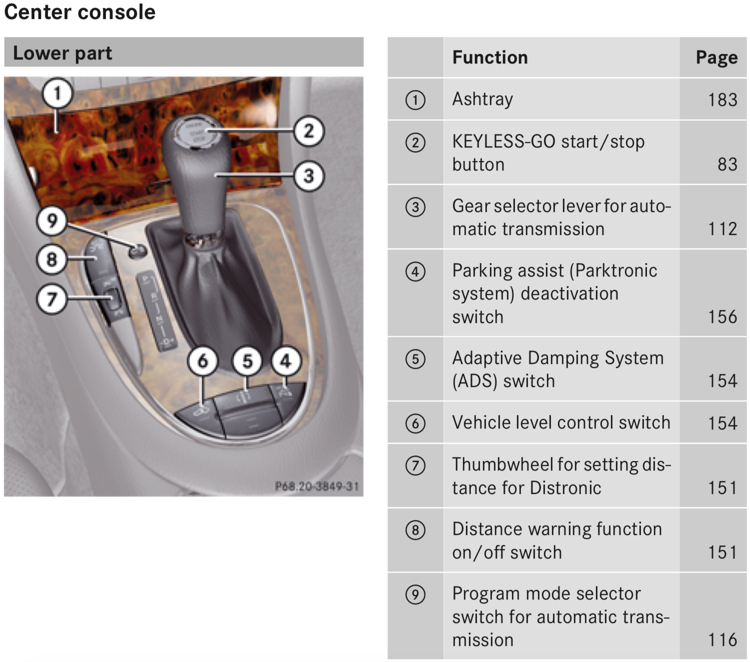

You can get the manual in pdf, online. This is from a 2009. Took about 30 seconds to find it
