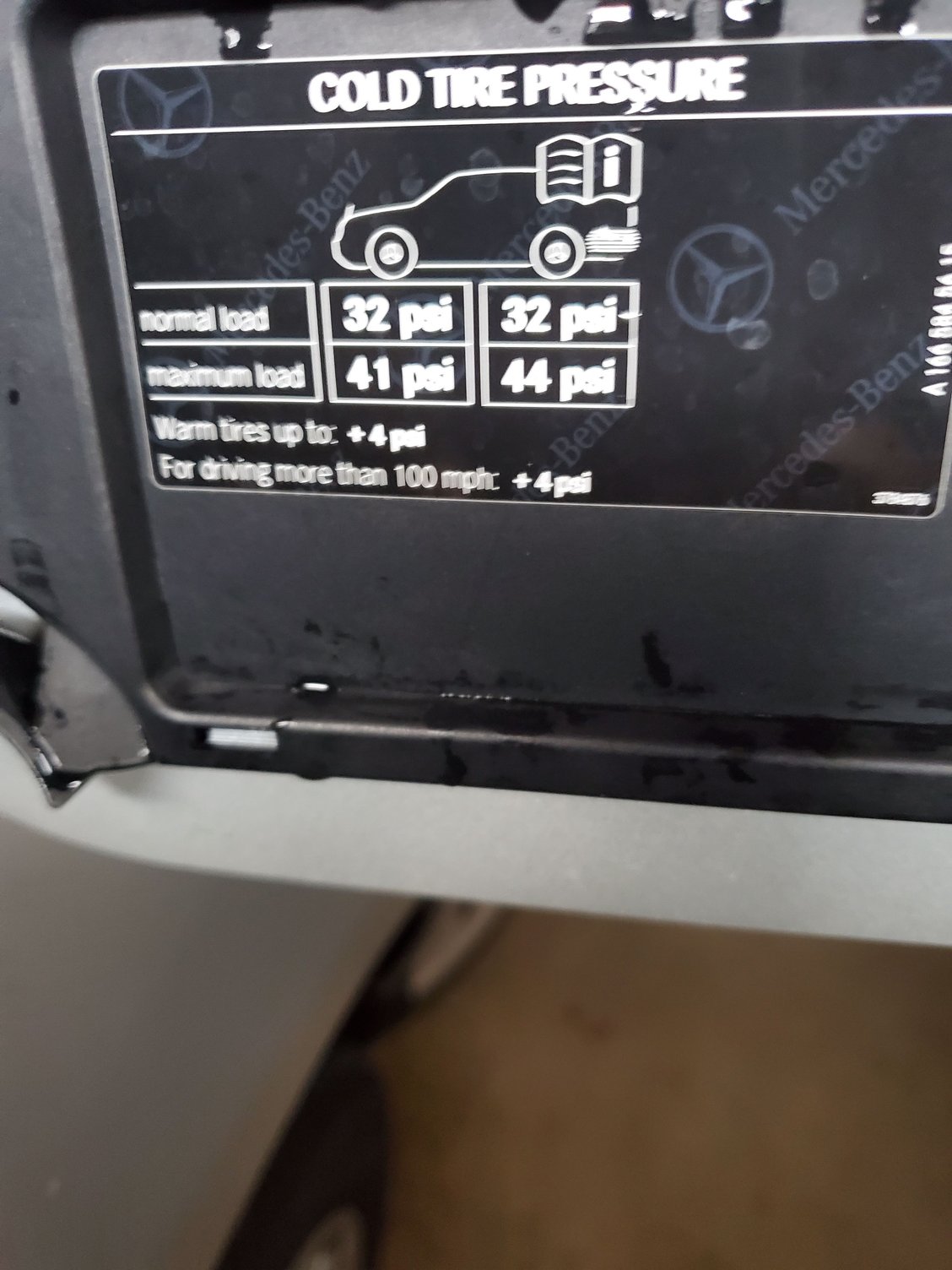

The gas cap and the driver door tire pressure labels on my GLE have different recommendations. The gas cap recommends 32front/32rear for a normal load and 41/44 for a max load. The driver door label recommends 45/48. Which am I supposed to follow?

Gas door - normal load. Unless you are fully loaded with max. passengers and cargo/luggage with a full tank of gas. Those are cold tire pressures btw. Note at the bottom +4psi hot. The door jamb is max gross weight, add that 4psi to the max load on the gas door cold and that equals the door jamb. Why? German engineers.

My dealer told me to follow the fuel door placard as daily operating information (somewhat to the point of the manual icon shown) with the door jam information relating to maximum vehicle capability for reference.
