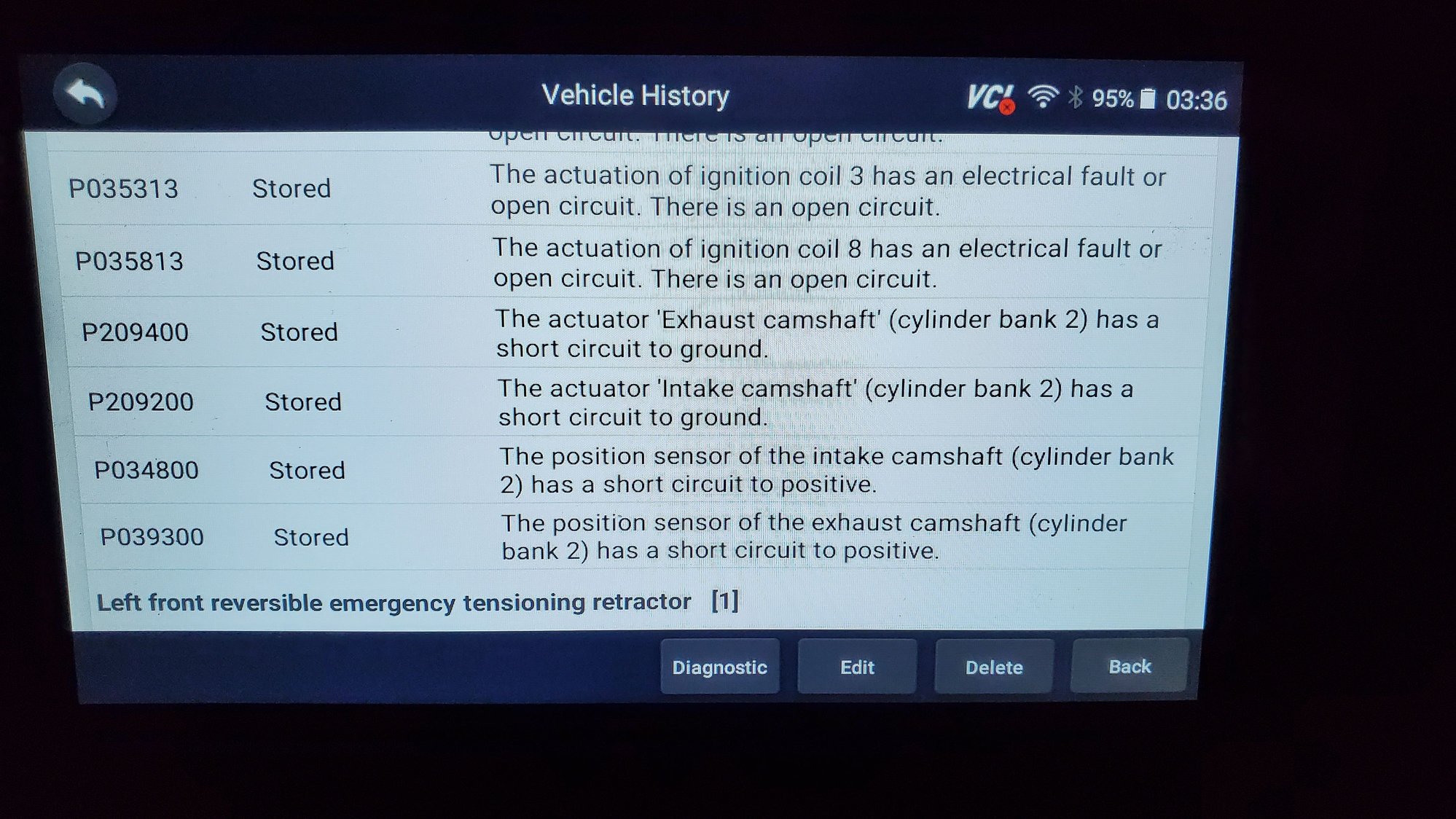

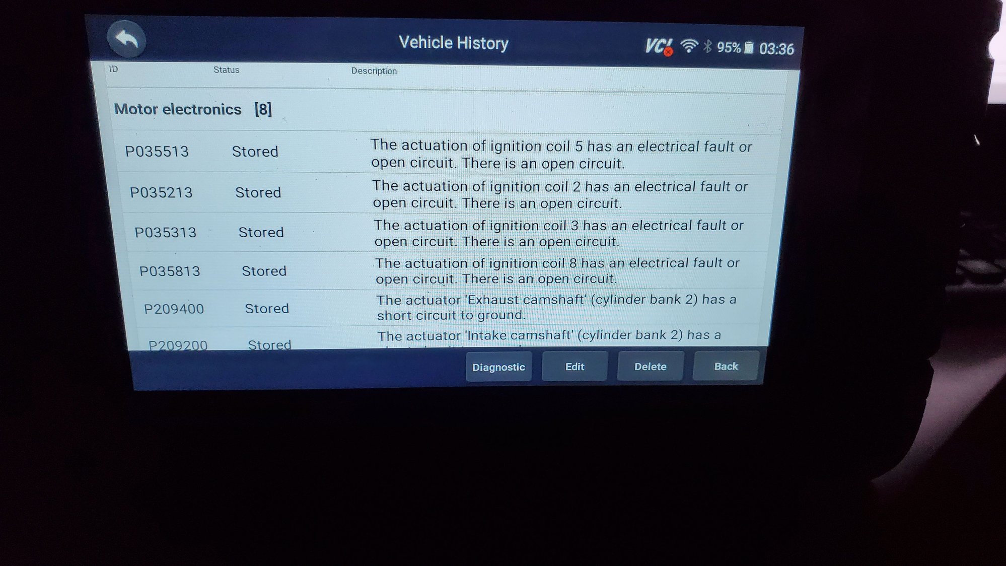

Hello , I was hoping for a expert opinion before I trailer this to the dealer . 16 gle 63amg 71000 miles , Car ran perfect before i parked it in November i haven't driven or started since. I decided to put my android touch screen in over the weekend everything is plug and play no splicing wires. i didn't disconnect the battery because multiple installation videos don't show doing that . I started the vehicle after install and it has a terrible miss and idles extremely ruff. I will supply the codes , I replaced the battery thinking the voltage was to low from sitting but that didn't work still getting the same codes and i cant get the B codes to reset.
I'm thinking there is a fuse or rely that is bad because all the codes show circuit open fault ground.

the 2 codes P209400,P209200 when i try to erase those wont reset you can here something under the hood like the PCM click like its trying to close the circuit for reset but stays open and the codes pop back up and wont clear,

None of the codes is active, meaning what you display can't create problem with bad running.
Most likely those codes were generated when you had battery low, or maybe 5 years ago when something else happened?
Clear the codes and recheck after some engine running.

Update, This why i hate and dread going to the dealer, the told me my #5 coil was shorted out.. which if it was i would have had misfire codes not low voltage codes .. 585.00 dollars to replace . I personally replaced all spark plugs and coils 1000 miles previous to this happening . I was given a supposedly the faulty coil back which didn't match any of the part numbers of the ones i put in because i still had the boxes of the ones i bought. So I asked the mechanic how he knew the coil was bad he said he had to replace a fuse that was blown.
I knew it was only a fuse or rely that popped when i was unplugging and plugging in radio connections because the command system displays the sport and sport +changes and the timing of the motor changes when you turn the dial which makes sense if something got a power surge and i was getting the cam codes .. So car had 3/4 of a tank when i dropped it off and only a half when i picked it and paid 585.00 dollars for probably a 15 min diagnostic and fuse replacement and a hour joy ride to use a 1/4 tank of gas and beat on my car.
