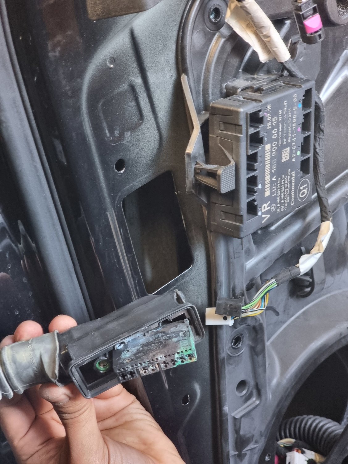

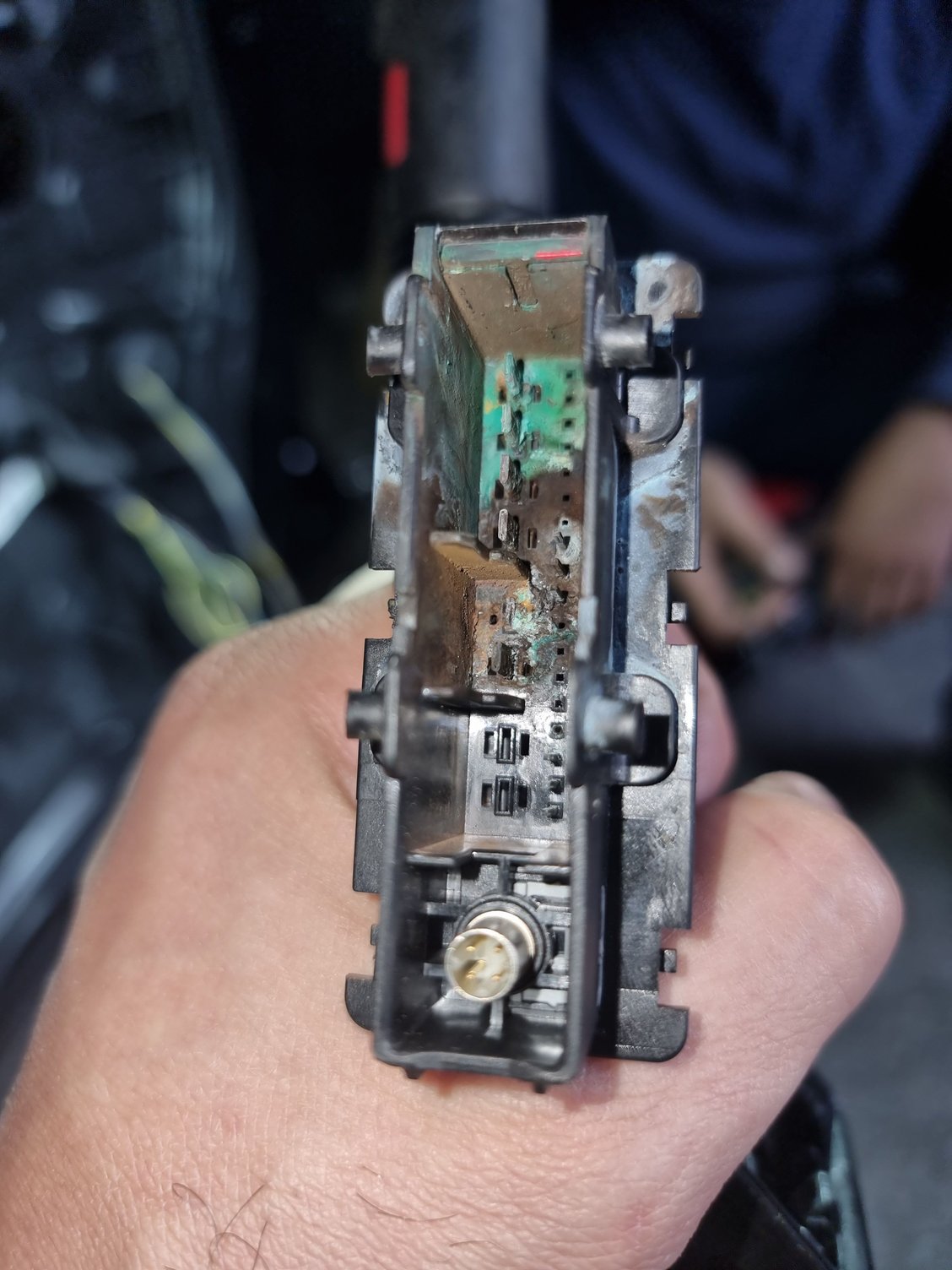

I have a 2016 GLE 63 AMG and a couple of weeks back all of a sudden i noticed i couldn't lower the passenger door window.. figured it might be the window motor but then noticed the lock didn't work either. interior lighting on door panel off. tried adjusting the seat and controllers not responding and last but not least, got the "Blind spot assist inoperative" error on dash.
Any insight on this issue?
I'm in Mexico and dealership shop is packed, got appointment 5 weeks from now & don't really know any good electrical shops.

could be the wiring harness

Issue resolved.. turns out it was the harness.
