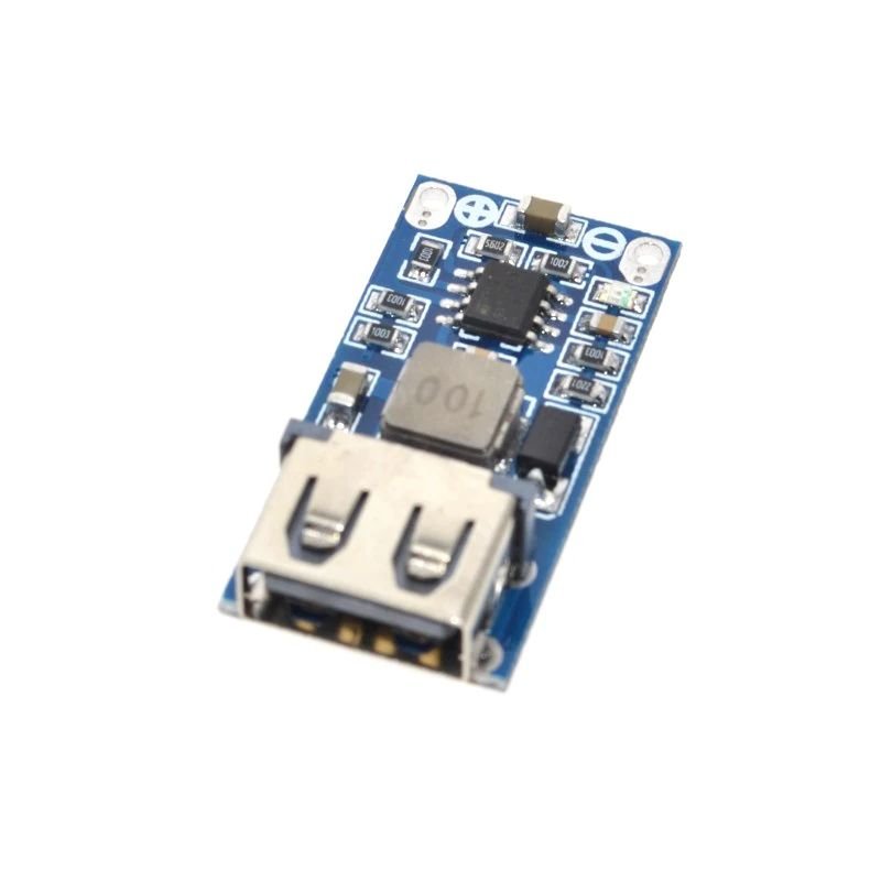

I built a usb port in the overhead console behind the rear view mirror of my SLK. I purchased a few of these power supply modules https://www.aliexpress.com/item/3281...636ef19cvIrmXk
They can be powered by 9, 12, or 24 volts to provide 3 amp USB power. This was a small 2 hour project requiring disassembly of the OH console. You tubes are about for this procedure.
Small usb power module
