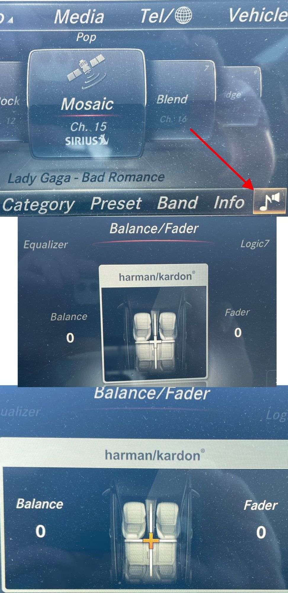

Could you (or someone else) have accidentally adjusted your fader control so only the rear speakers are working? You can check by accessing the audio controls using the music note and speaker icon on the right side of the bottom menu of your display (see top image below). Select it, then scroll to "Balance/Fader" (middle image) and select that. You should see something like the bottom image. You can adjust the back-front and left-right balance using the command knob on the console
+1
check fader
