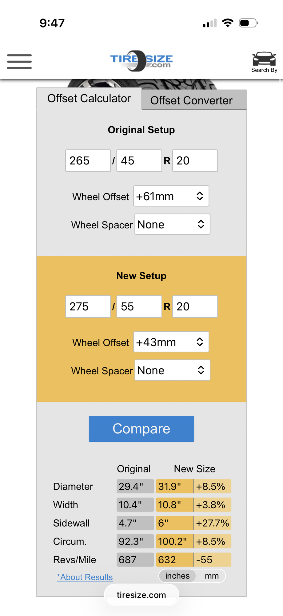

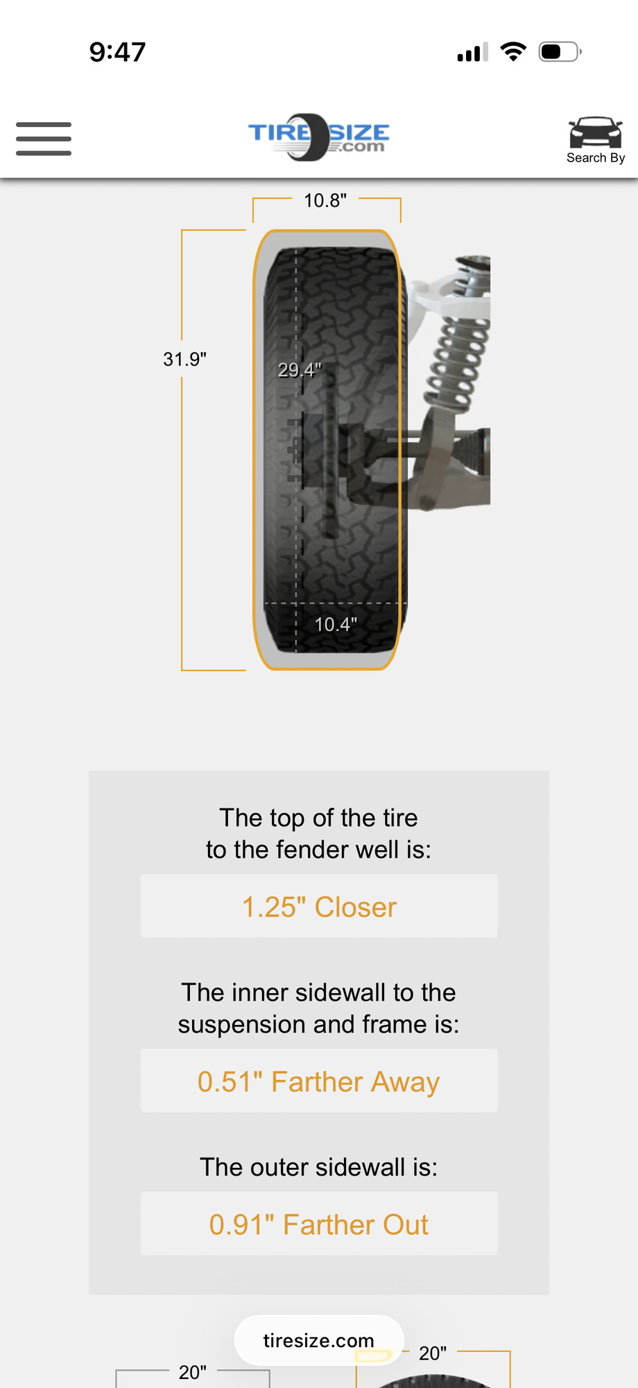

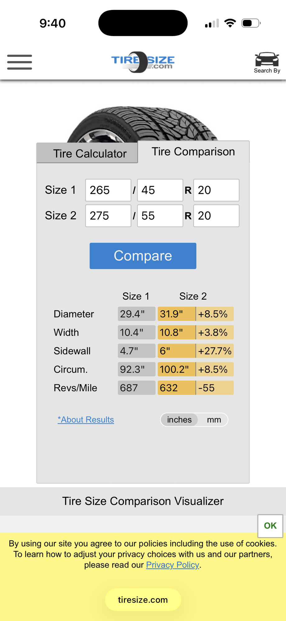

The best size and the most comfortable and ground clearance wojld be 275/55/20. At least I am going to do this setup this summer when I install new tires.
Also, I do drive a lot on gravel roads and even on the highway the 265/45/20 is too loud and rough. I hate those thin tires.
when I get tbis setup if they dont fit ( i am pretty confident they will), I will either get spacers or get a different offset - probably a + 43 wheels. Currently I believe theyre +61 so bringing them out about 20mm will be perfect.
Either way, play with tiresize.com a little bit and it should give you an idea. Below is an example.
Also, go to discount tire and they will test fit tires for you for free.
