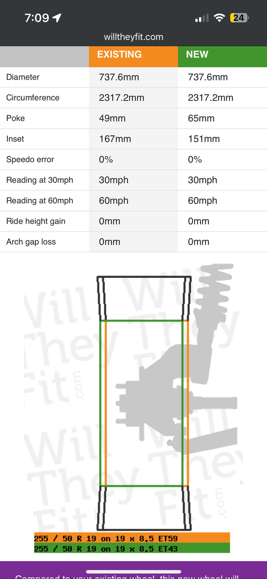

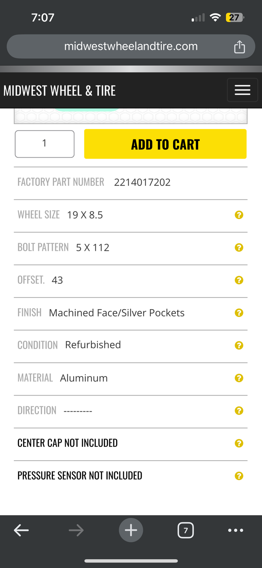

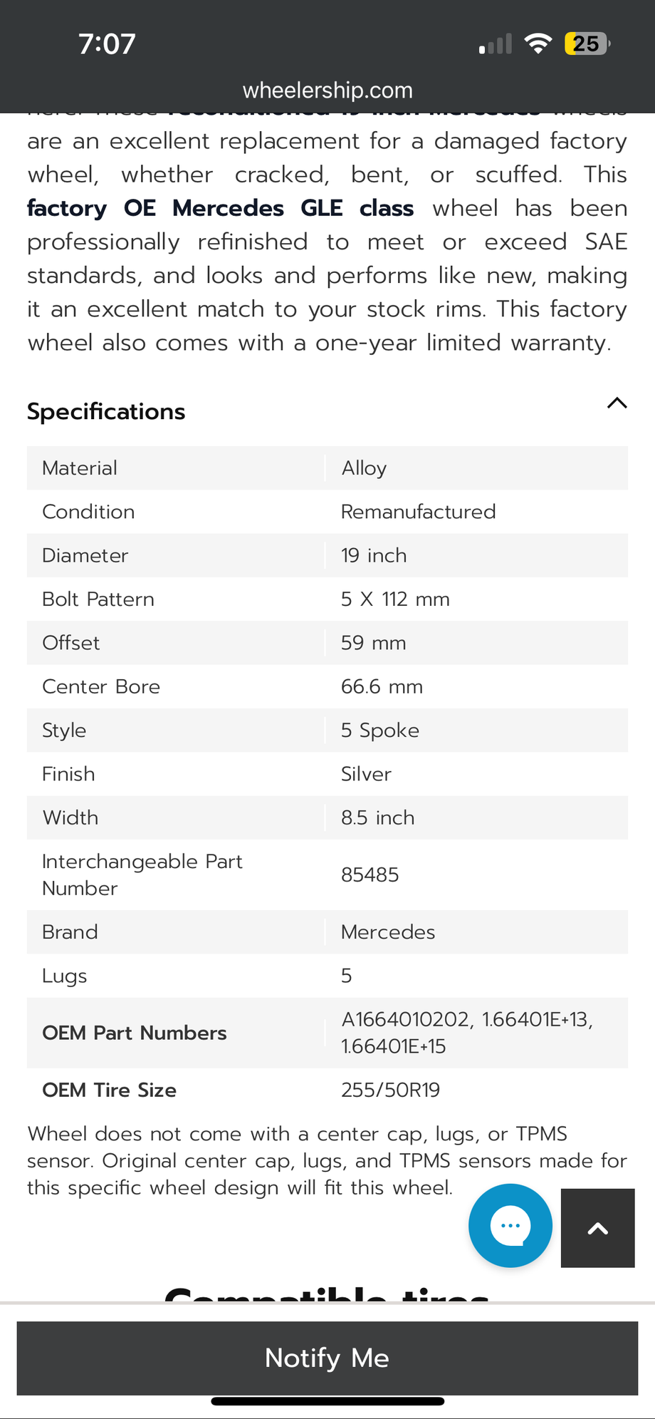

Would these wheels from an S class work on my W166 GLE? They are both 19x8.5 and they have slightly different offsets. My assumption is that they’d work but want to be sure. TIA

The peeler style wheels will definitely work on the GLE. I am using GLK rims (8.5" 45 offset) for winter setup and it fits nice.
