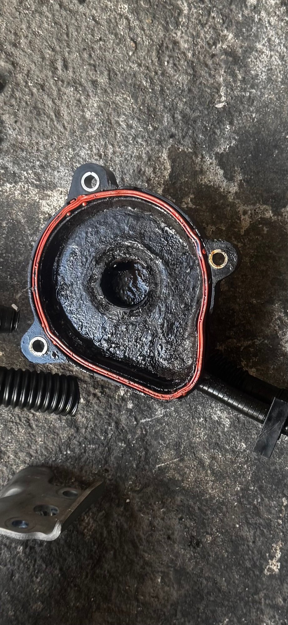

Thanks for the support, I hear your concerns, the reason I’m considering a flush is cause the PCV looked really bad, like really bad…. But the engine oil does indeed always look good after each change I just feel if the PCV was so damn bad maybe there will be a benefit within the engine to do the flush….
here’s how the PCV looked 😬
again as scary as this looks, every oil change at 5k oil was as it should be, no smell, no particulates / sizes of any sludge in the engine / pan / filter….
soley based on how the old PCV looked at 120k is why I’m considering the flush… but maybe PCVs at 120k catch all the **** and when it’s at its life’s end they look like this? Past its life ofc…
What do you guys say? Do it the flush before oil change or just keep sticking to new oil changes and let the oil do its thing?
EEEEK!!!! hot tamales! maybe pour a can of seafoam on that motor while you are at it.
thats kinda just what it looks like. Also welcome to the based oil gang. There is a huge difference with switching motor oil. Motul is very good stuff. If you think you can't feel oil use whatever youre recommended and switch to Amsoil/Motul/Pennzoil Platinum Euro and it's absurd how much stuff it cleans out and improves your idle/mpg/throttle.

tbh I believe the cause is due to lack of oil changes and sitting idle a lot. Previous owner showed no love lol….
im also thinking of replacing the waste gate, just haven’t looked into where it’s actually located and what that adventure entails, any info would be appreciated 😅

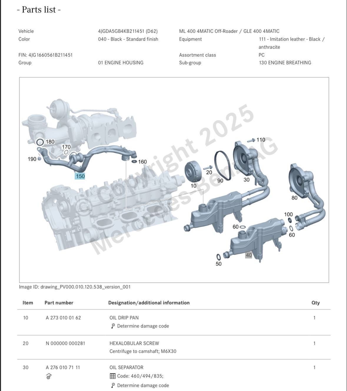

Regarding the centrifuge, are you referring to #10 in this diagram?
Yes. That might indeed be it.
yeah its that stupid thing, again no reason to suspect its not working. Usually your engine starts acting up and huffing and puffing at idle when its not working or breathing excessive oil at high RPM. Dont mess with the turbos. The turbo stuff lasts pretty much forever, what you need to do is take care of your oil which takes care of the turbos. Cool oil cool turbos.
