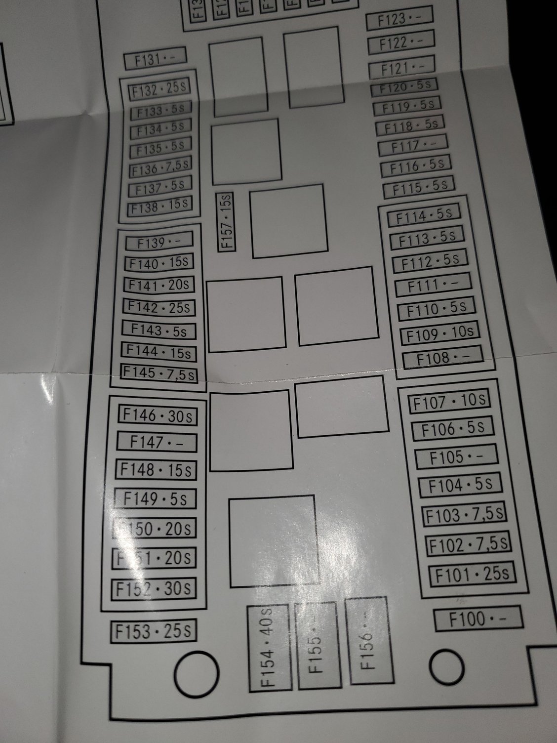

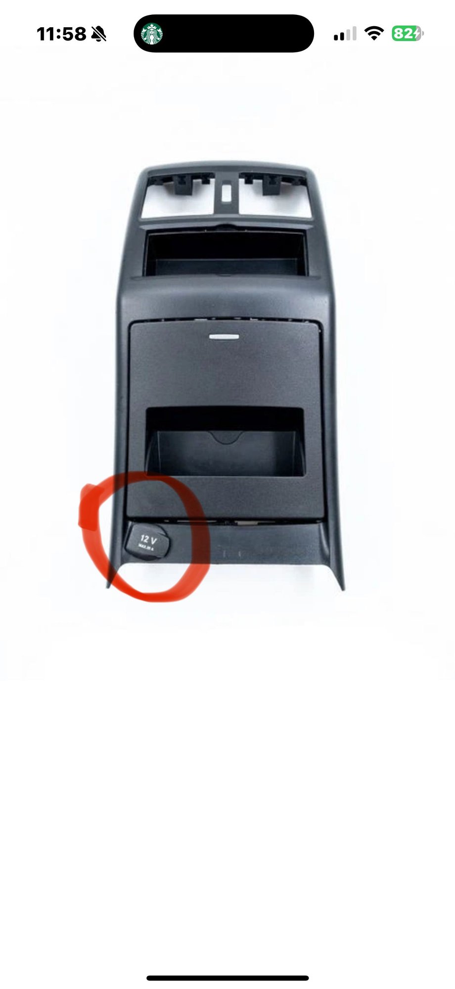

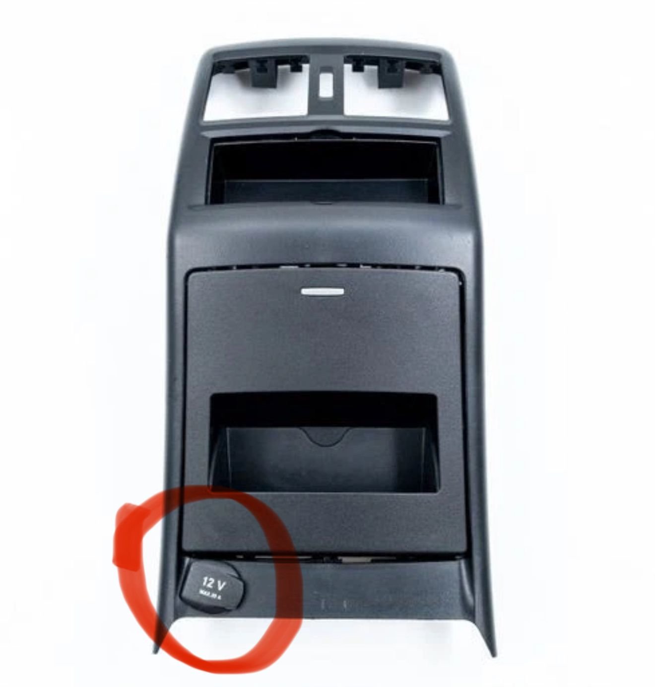

Hello, Can anyone provide information regarding the specific fuse assigned to the 12v socket situated at the back of the center console?

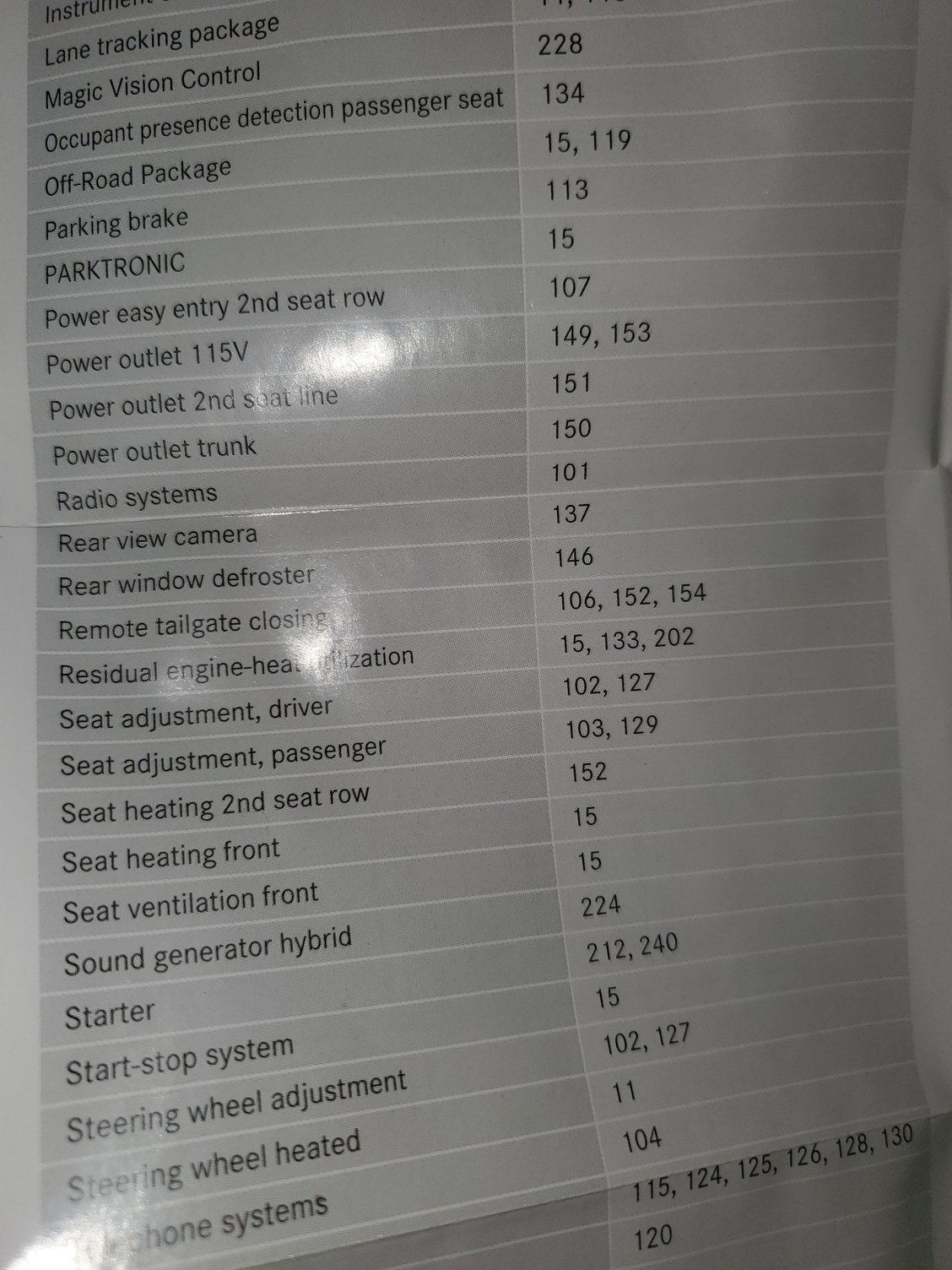

On the 17 model it is fuse 151.

Thank you very much for your help. I was able to fix it with your help.
