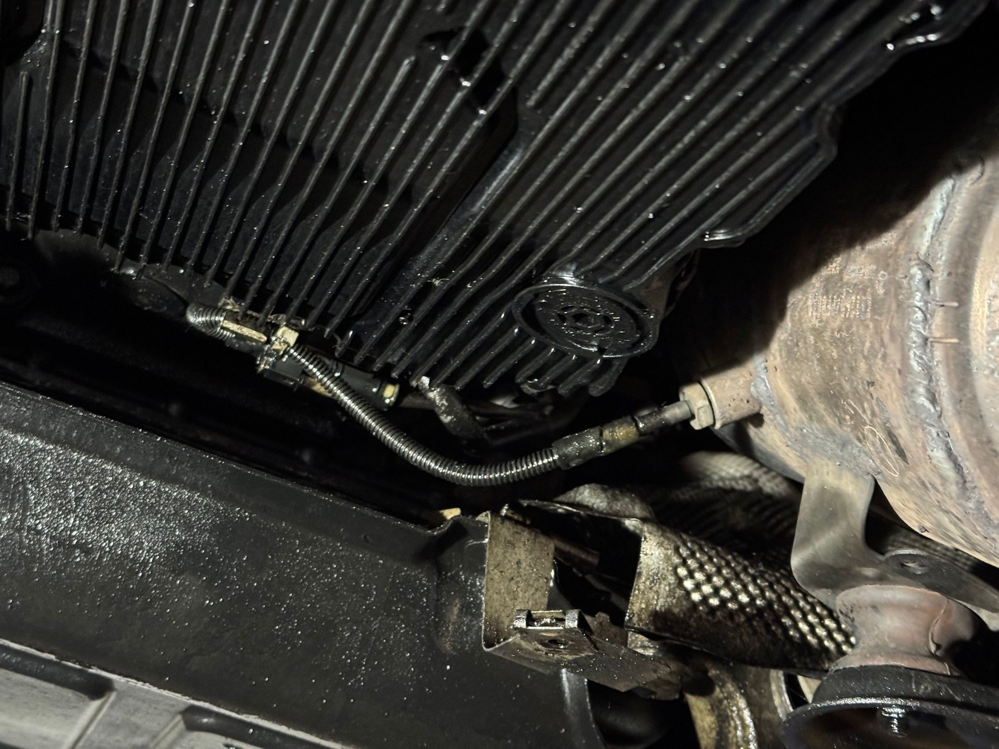

When I was trying to service the 9G transmission on my GLE250d, I notice fluid leak around the housing. Especially there is one pipe which appears to be leaking but I am not very sure what pipe it is and how I can fix it. Would someone know where I can get a new pipe or just fix the leaking part? Your advice is much appreciated. Thank you!

To determine which pipe it is, the online EPC may be useful. Insofar as repairing/replacing it when you find out what the problem is, go to a trusted independent mechanic or a Mercedes dealer if you're not able/willing to do it yourself.

Thank you for your reply. Yesterday I have spent some time researching on it and found that it may be A1665000800, which costs £75 just for the line. I am going to take it out and see if I can use some alternative to save the cost.
