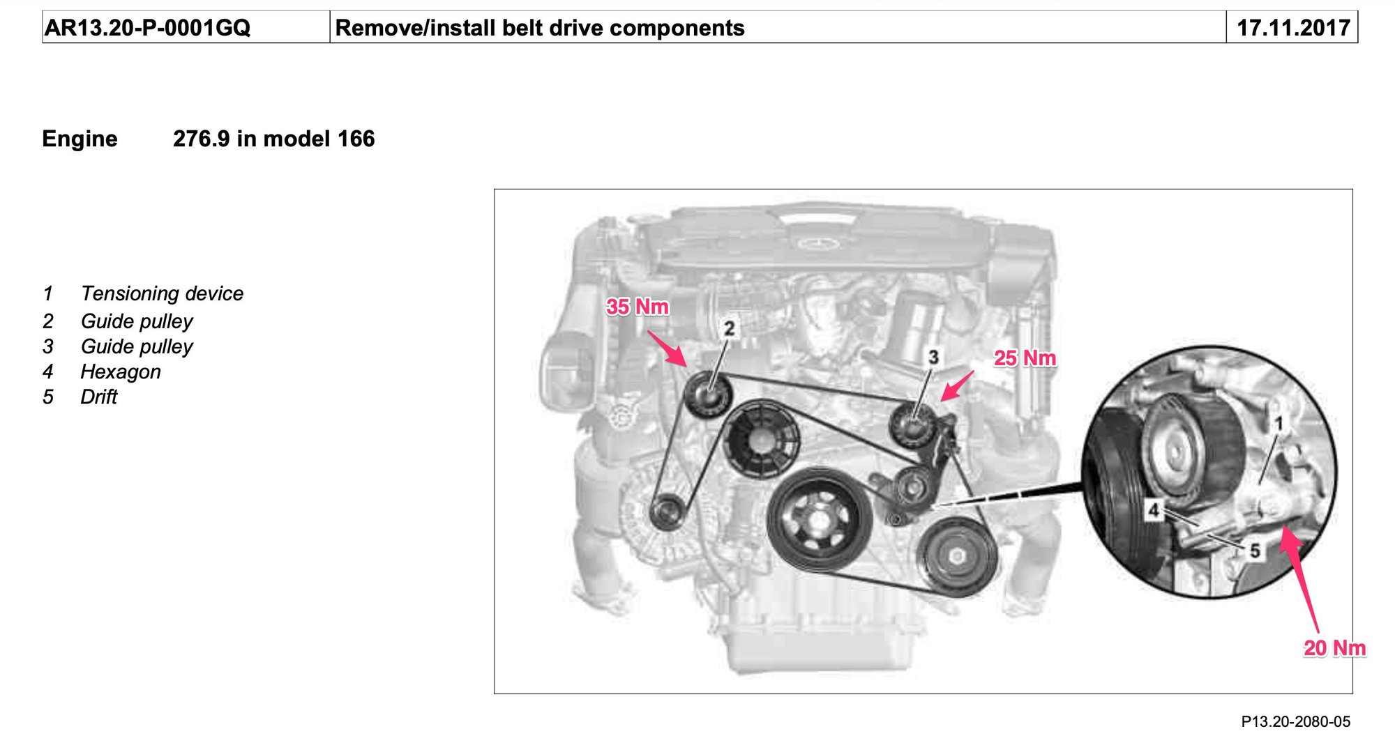

So for the 2017 GLE-350 4MATIC M276.955 engine (non-AMG), what are the torque specs for the idler pulleys? From document AR13.20-P-0001GQ, I have:
1) Screw/bolt, poly-V belt tensioning device to timing case cover, 20 Nm. I believe that this is the two bolts holding the tensioner;
2) Screw/bolt, guide pulley to carrier, 25 Nm. I assume that this is the one to the right when facing the car;
3) Screw/bolt, guide pulley to coolant pump, 35 Nm. I assume that this is the one next to water pump pulley, to the left when facing the car.
My confusion comes from the fact that the two idler pulleys are identical, but one has a higher torque of 35 Nm. Is that correct?

2017 GLE-350 4MATIC W166.057 A89 276.955 722.906
Thanks Chassis! Actually I got the document from your post.
So this is my interpretation, please see if correct.
I am nervous on this, because I have had tensioner bolts broken before (on Honda). After the Dealership fixed my work, the bolt broke as well after a few months. And they did it again under repair warranty, and it has stayed put so far.
So apparently some parts have a very narrow margin of error.
I decided to go down this rabbit hole a bit further. Assuming that the drawing from MB is true to proportion / scale (the pulleys still look round to me), we can measure the angle of the belt routing.
The idler pulley #2 will subject to ~20% more lateral force than #3, which translates 25 Nm to 30 Nm. So it is in the right direction.
As to how lateral force translates to bolt pre-load, especially when pulley bearing sits in a small "pedestal" *boss* of half depth, I have to look.
