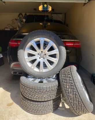

20" Genuine Mercedes Alloy Wheels with Pirelli Scorpion ATR 275/50R20 tires.
These Wheels and Tires set up was purchased online directly from https://www.alloywheelsdirect.net with EXCELLENT customer service and top quality balancing on the wheels. They took a few weeks to get from Germany to the US. Total price was over $4k and I only paid $160 in customs fees. Buy it locally and spend at least $3k more with tax. Best deal ever from these guys. They only sell Genuine wheels and tires.
There are only 4 sets of wheels approved by Mercedes for the 2017 GLE 63S Coupe. We couldn't find any wheels on the market with the correct offsets that match this vehicles wider rear stance. We also did not want to use wheel spacers. The selection for three of these wheels is very limited. The fourth setup Mercedes provides for Winter Wheel setup can hold many more types of tires, such as the Pirelli Scorpion ATR which is also used on the current AMG G63 with All Terrain Package.

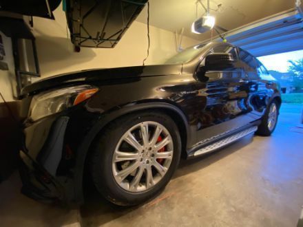

With this Winter Wheel setup, the tires are all the same size unlike the other wheel setups, however the Offsets are different still. The rear offset is smaller (pushing the wheel out more), so the Rear Wheels will align to the front wheels because they are of the same size tires, unlike the other rear wheels which provide the much wider stance. These rear tires are about 2" narrower than the stock setup wheels and tires.
I am not used to the look, as it takes away from the AMG design, but imagining the next offroad adventures, it's perfect. I already curbed my car today without scratching my wheel at all. These tires protect quite extensively around the wheel, unlike the 21" and 22" wheels.

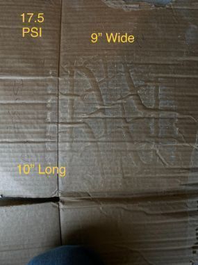

What about PSI's in the tires?
You probably will never ask yourself, "What PSI should I lower my tires to?" This is why most Range Rovers and BMW SUV's fail offroad. That and that they are not G Wagons... Tire Pressue is quite important to drive offroad and in sand. During the summer time, in the heat, sand gets loser, so expect to get stuck. ALWAYS have your recover gear. Winch, MaxTrax's, Ropes, water, food, and more.
Here are a few photos of the difference in Tire Pressure and Surface Area that will help you gain more traction while offroading. By putting chalk on the tire, and lowering the tire, I was able to measure the surface area based on the PSI. The bigger Surfact Contact, the better for sand and most offroad situations.
As you can see, with the lowest pressure, you get 11.5" in surface length. You get much less with 37 PSI which is 7.5"
BEFORE DRIVING IN SAND, lower your pressure. Don't think you can get stuck, and then lower it. You open yourself up to more issues then.
NOTE! Although the G wagon Owners Manual says don't lower your tires lower than 17.5 PSI, no other Manual states this. 17.5 PSI is the amount of pressure that will SAFELY hold up a GLE Coupe based on the Tires' Index Load Specification, Pressure per tire, and weight of the vehicle and its occupants & luggage. A lot of AMG Academies and Offroading has helped me become a tire expert.
