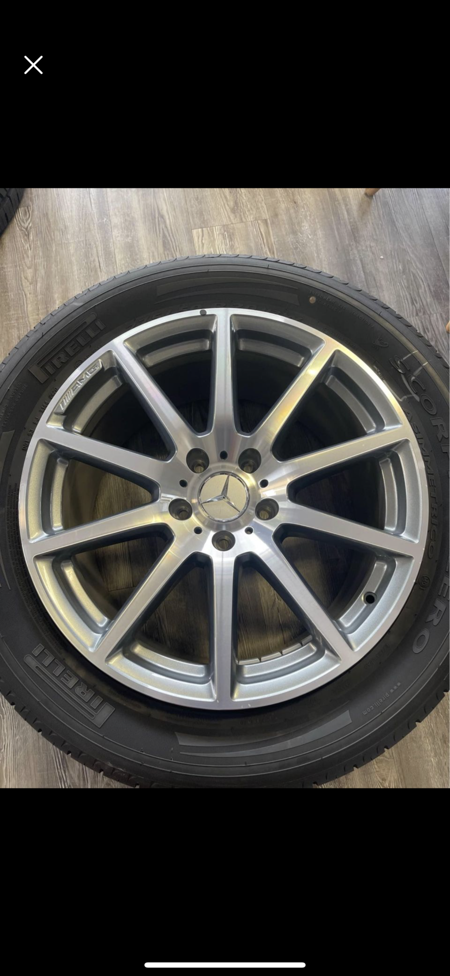

I’m thinking on swapping my 20” amg rims that came with my 2018 GLE 350 with the amg package for the new 2022 amg 20” rims. These rims come with tires too which i desperately need. My tires at them moment are 265/45/20 and the tires on the new rims are 275/50/20. Will I have any issue if I install these rims and tires? Most importantly, will they fit?

The 2022 wheels will fit no problem, but if you like the low-profile look of the current setup you’ll need to get new tires. The 275/50 will be a little taller but about the same width.
