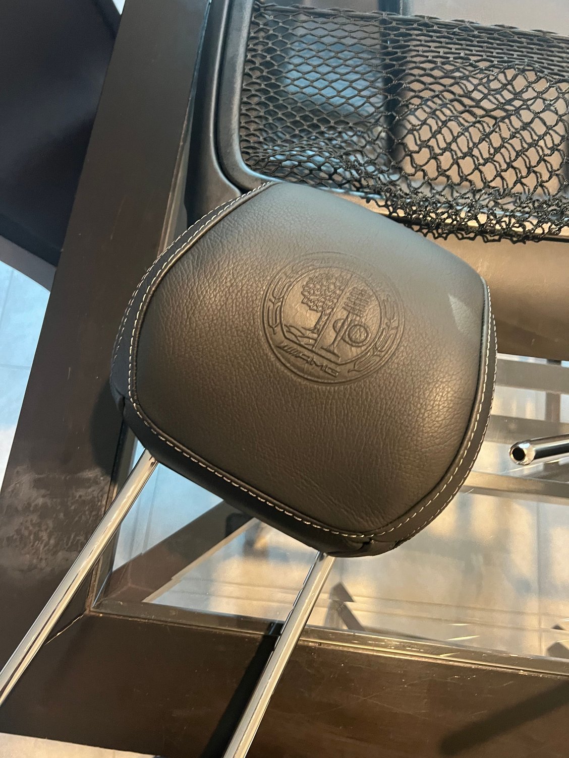

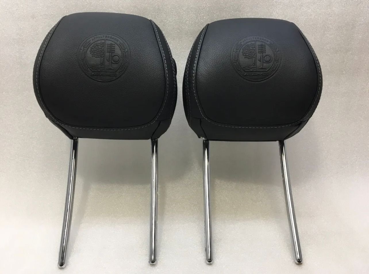

I have a 2016 63s coupe that has the multi contour seats. I came across the AMG embossed headrest and wondering if I can simply swap them out?
Embossed headrest, will be swapping out hopefully
Current headrest in car

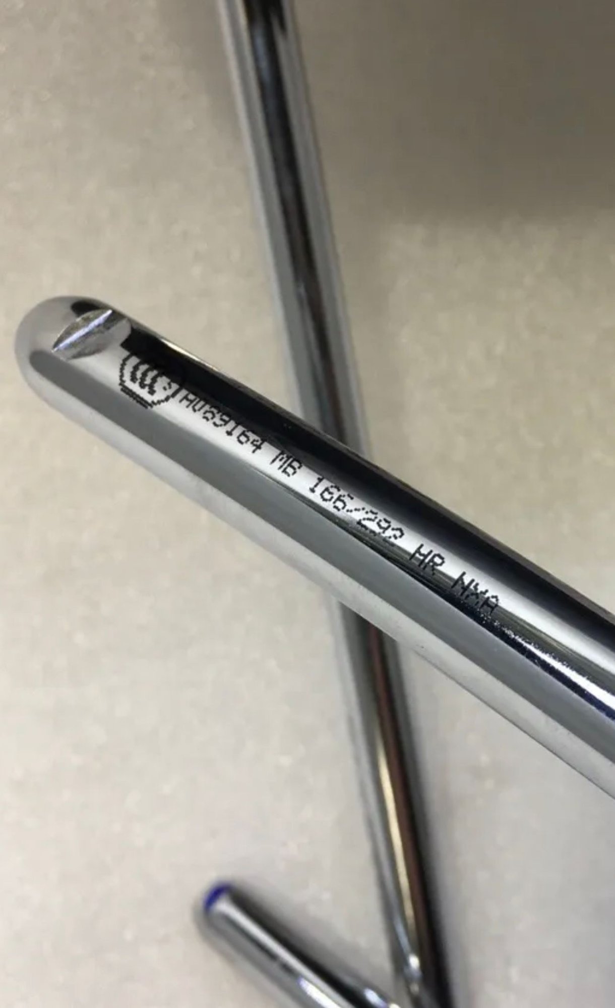

Embossed headrest part number

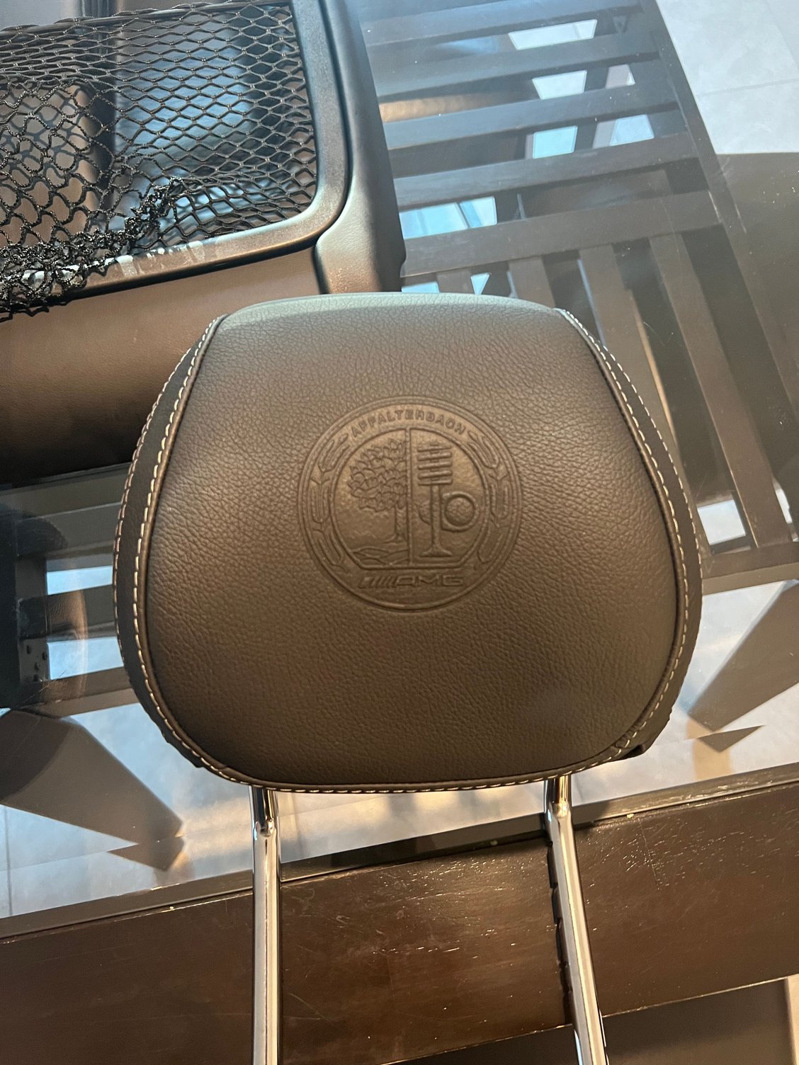

So I received the new headrest… but completely forgot my seats are smooth while the embossed headrest are textured… but anyway I’m still going to pop them in.
New headrest
New headrest

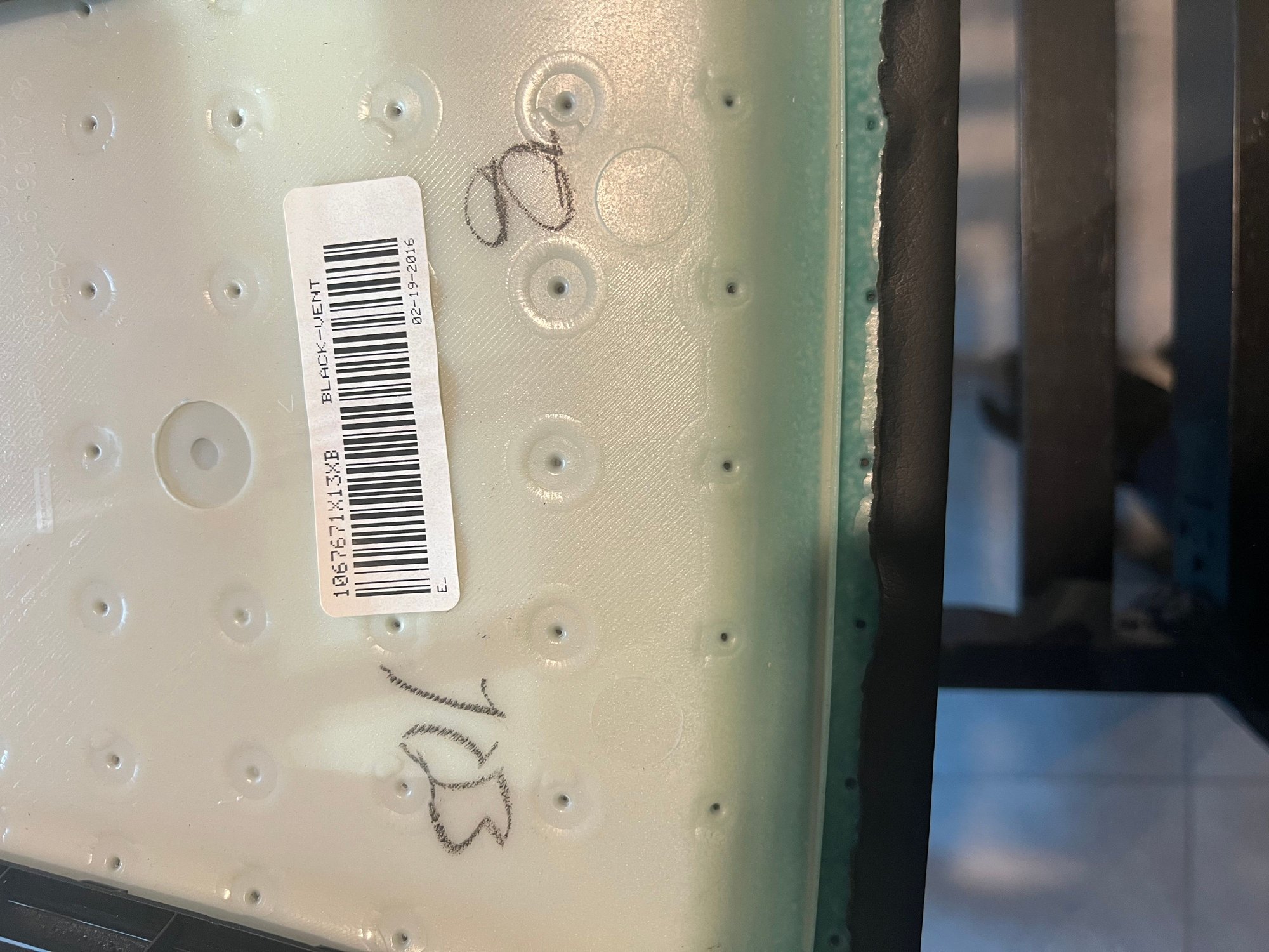

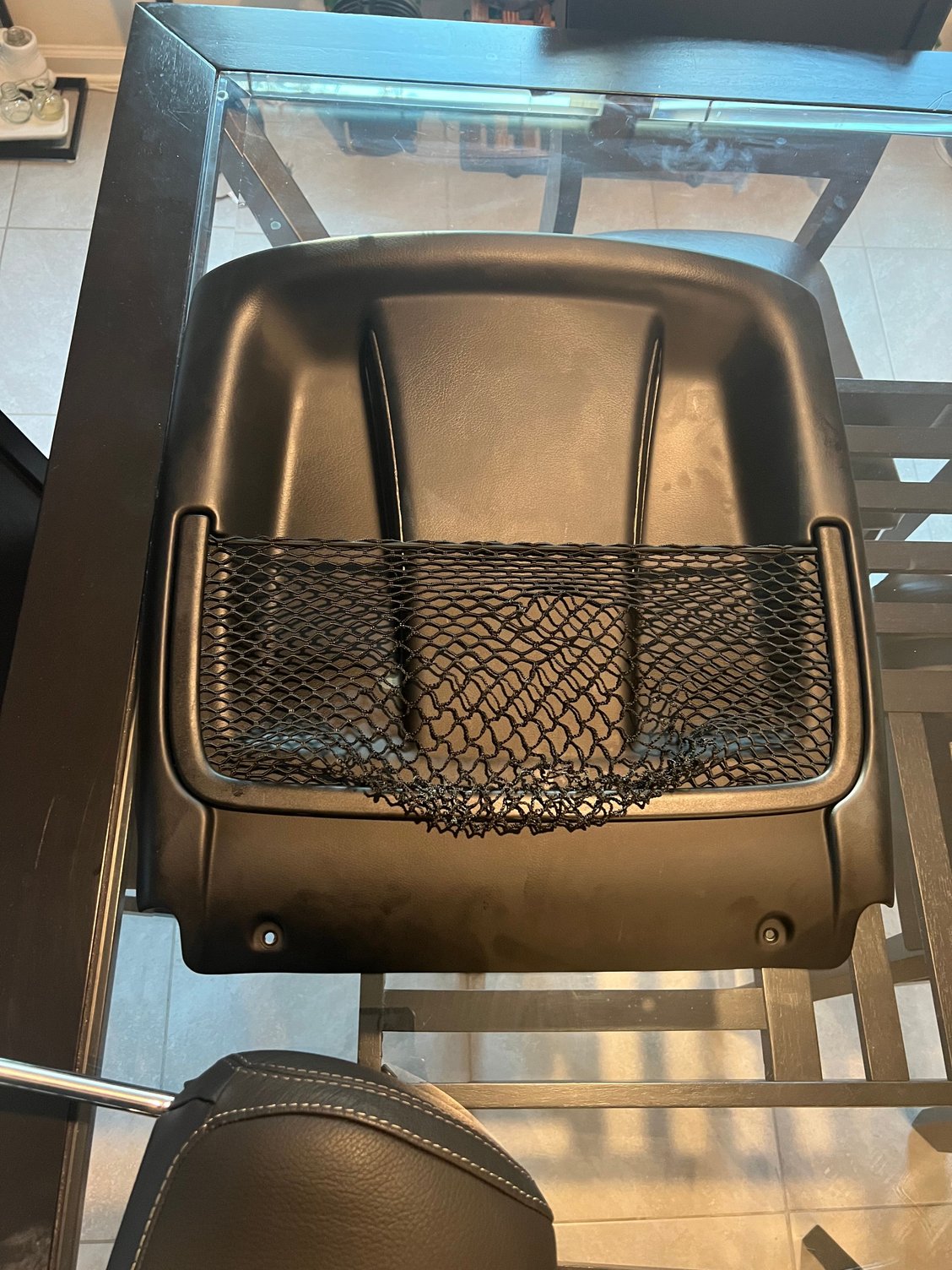

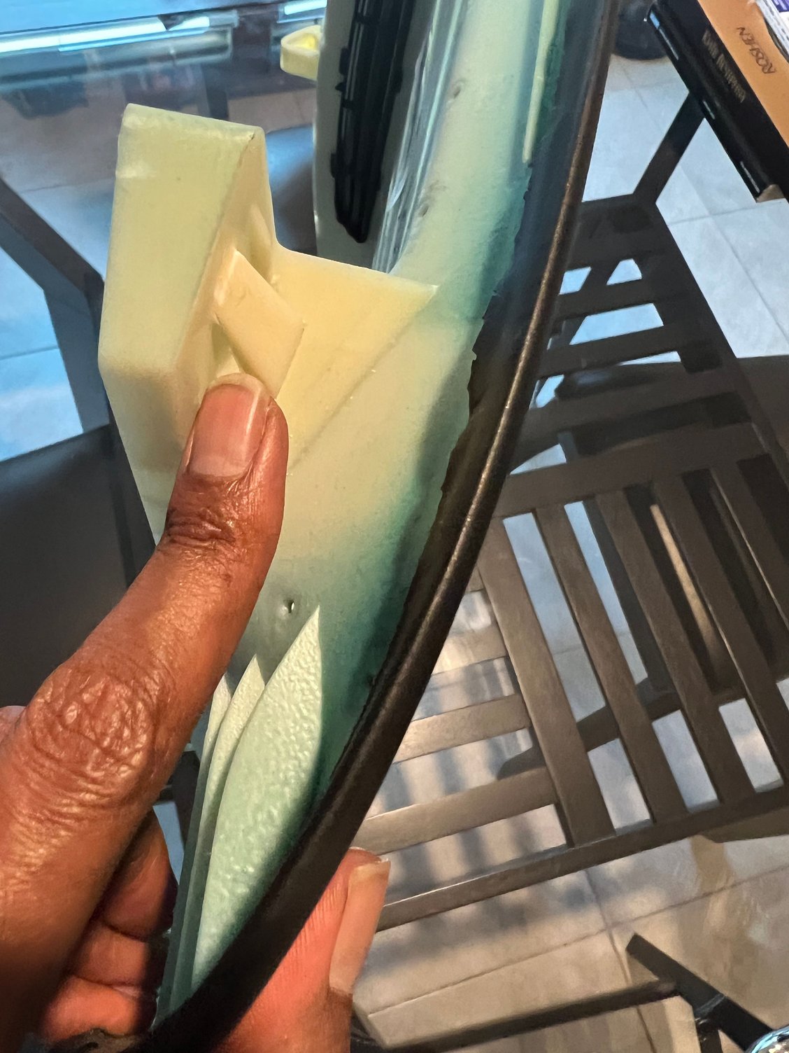

Front passenger back panel To remove lean seat all the way forward, remove two screws at bottom. Grab bottom left corner and pull repeat on opposite side (felt like I was going to break them) do not pull down until bottom section is free
Back side of back panel
One of my top clips broke
This one almost broke
In case you need the part #

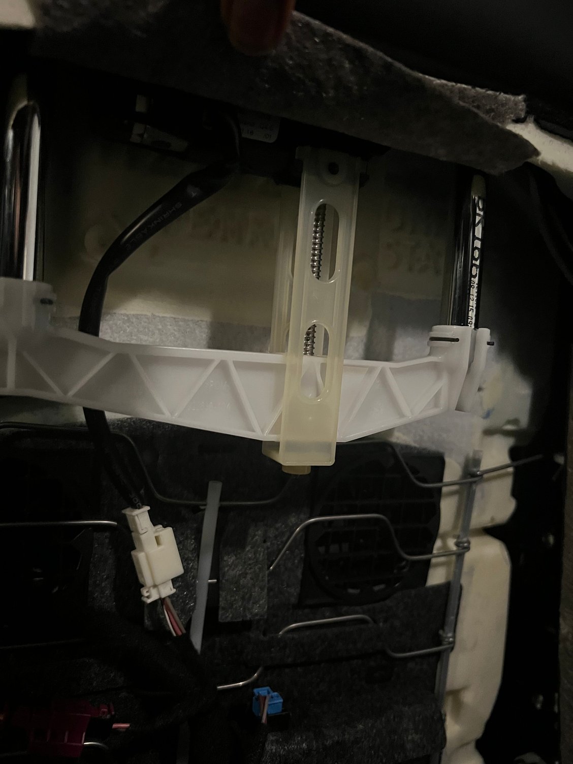

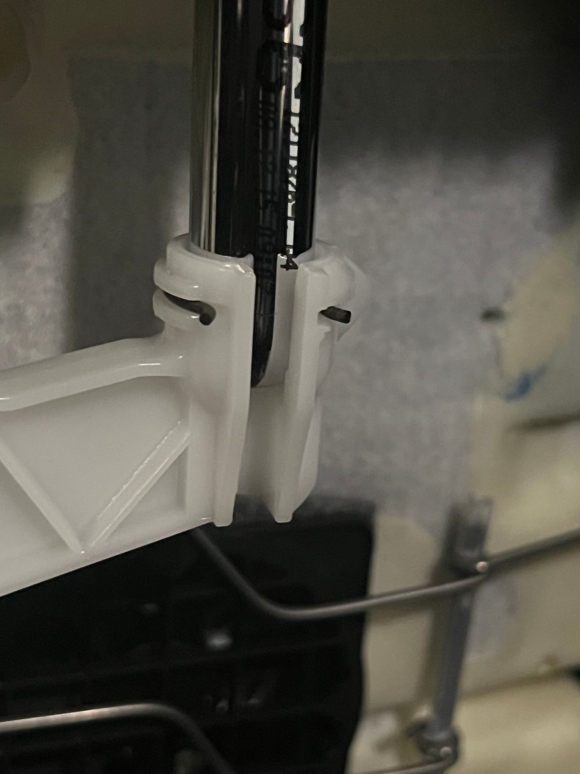

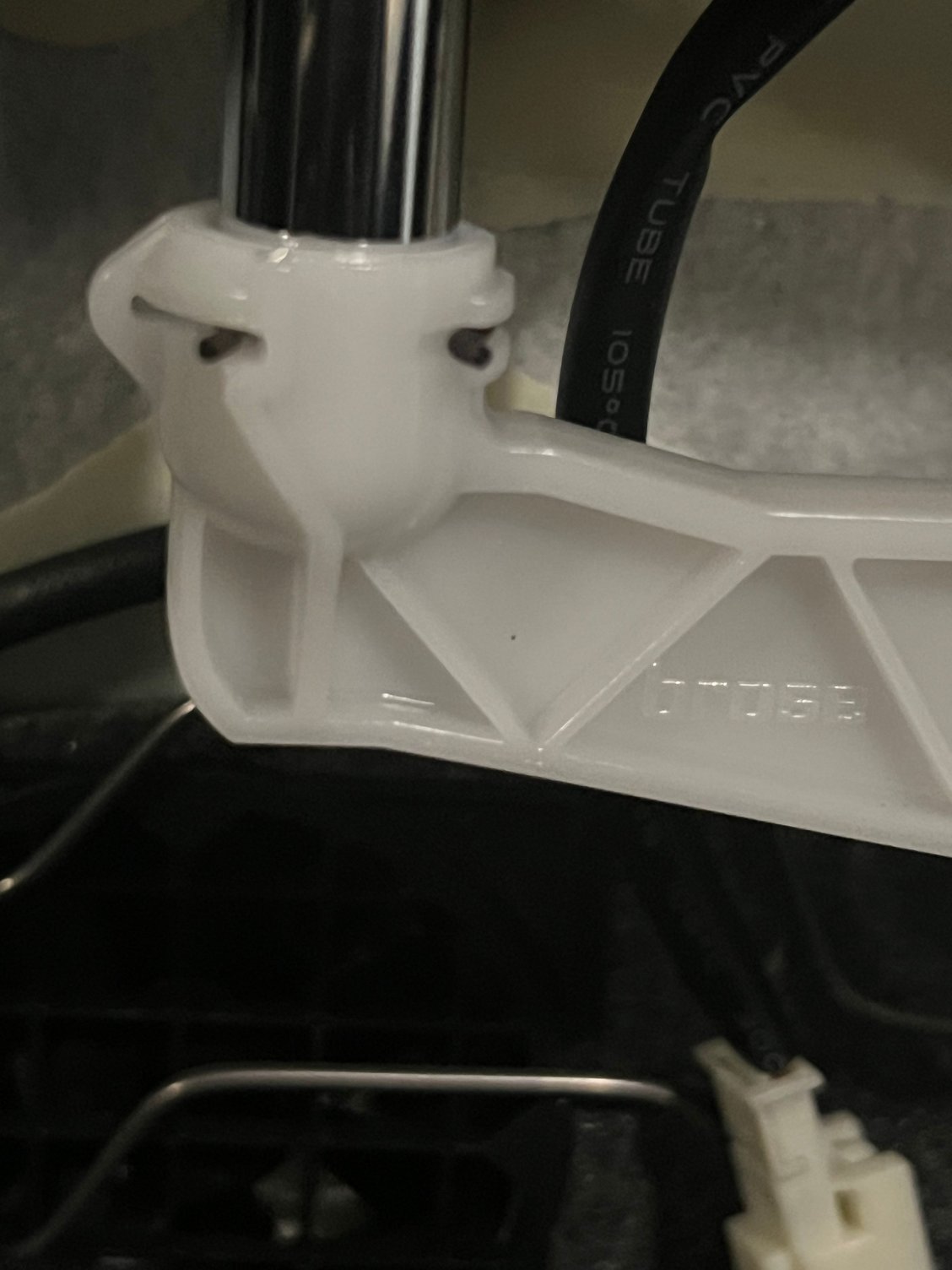

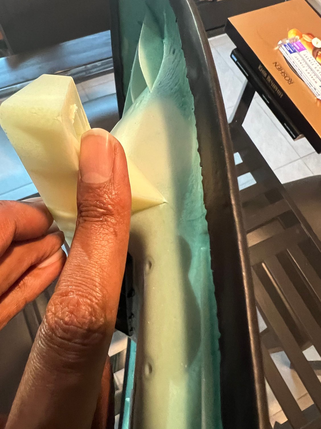

On to the headrest itself… it seems there’s only clips holding it in place within the motorized lift
Same on both sides
Headrest motor is behind grey flap… just follow the wire

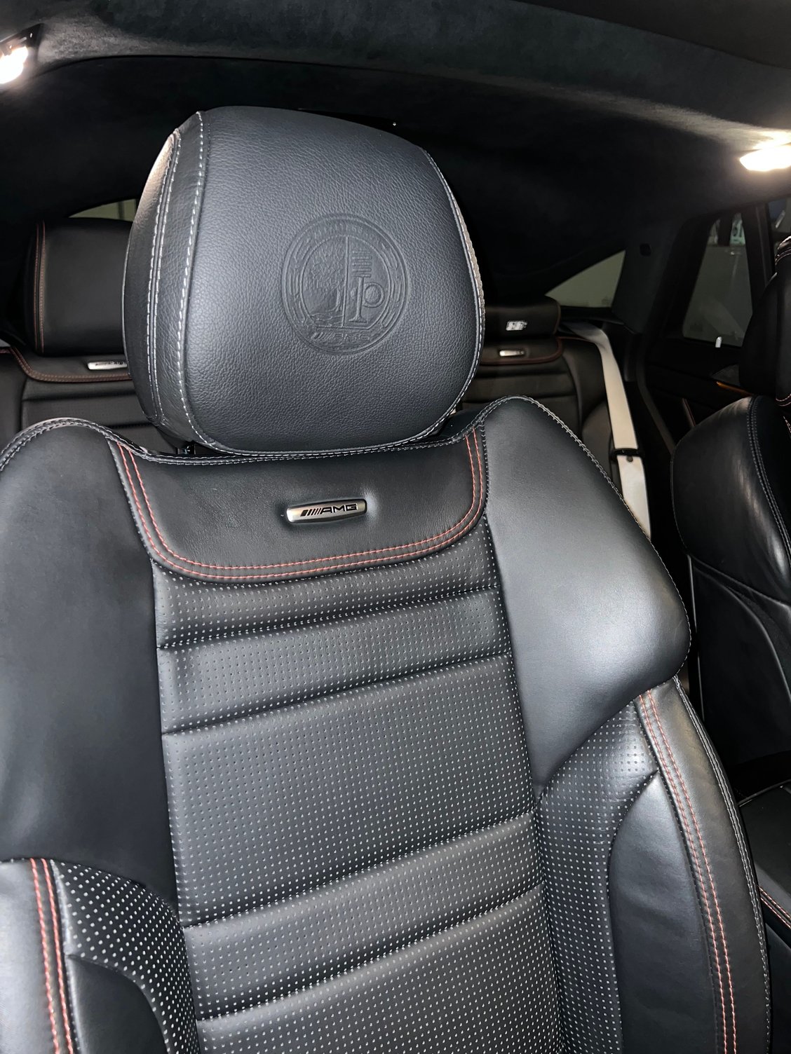

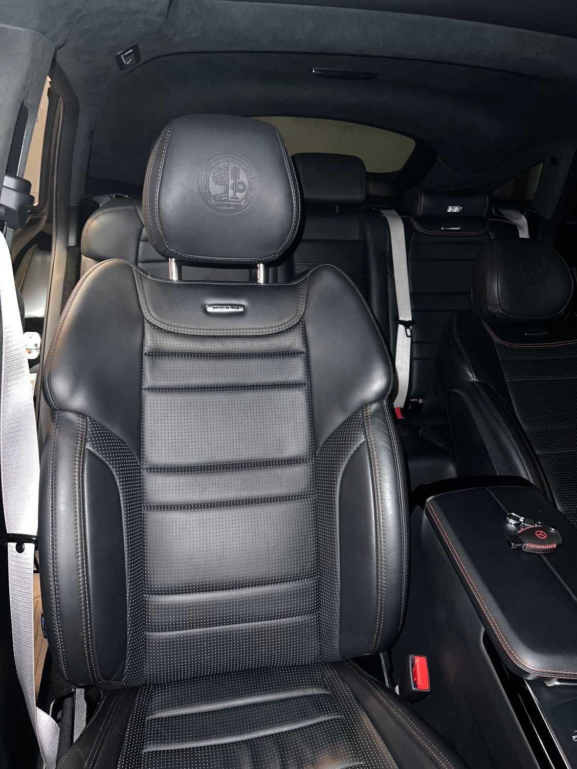

Test fit
Be careful not to lose the retaining clips when removing they will pop and fly away
Driver seat with factory headrest
Passenger seat with AMG Embossed Headrest I’ll color match it later

how did you make the stitch color red?
Old Oct 29, 2022 | 06:50 PM
Coupe_Lyfe's Avatar
Joined: Sep 2022
Posts: 30
16 GLE 63s - C292 - M157
I used a red fabric marker… color didn’t hold as well as I would have liked so I blacked it all out
