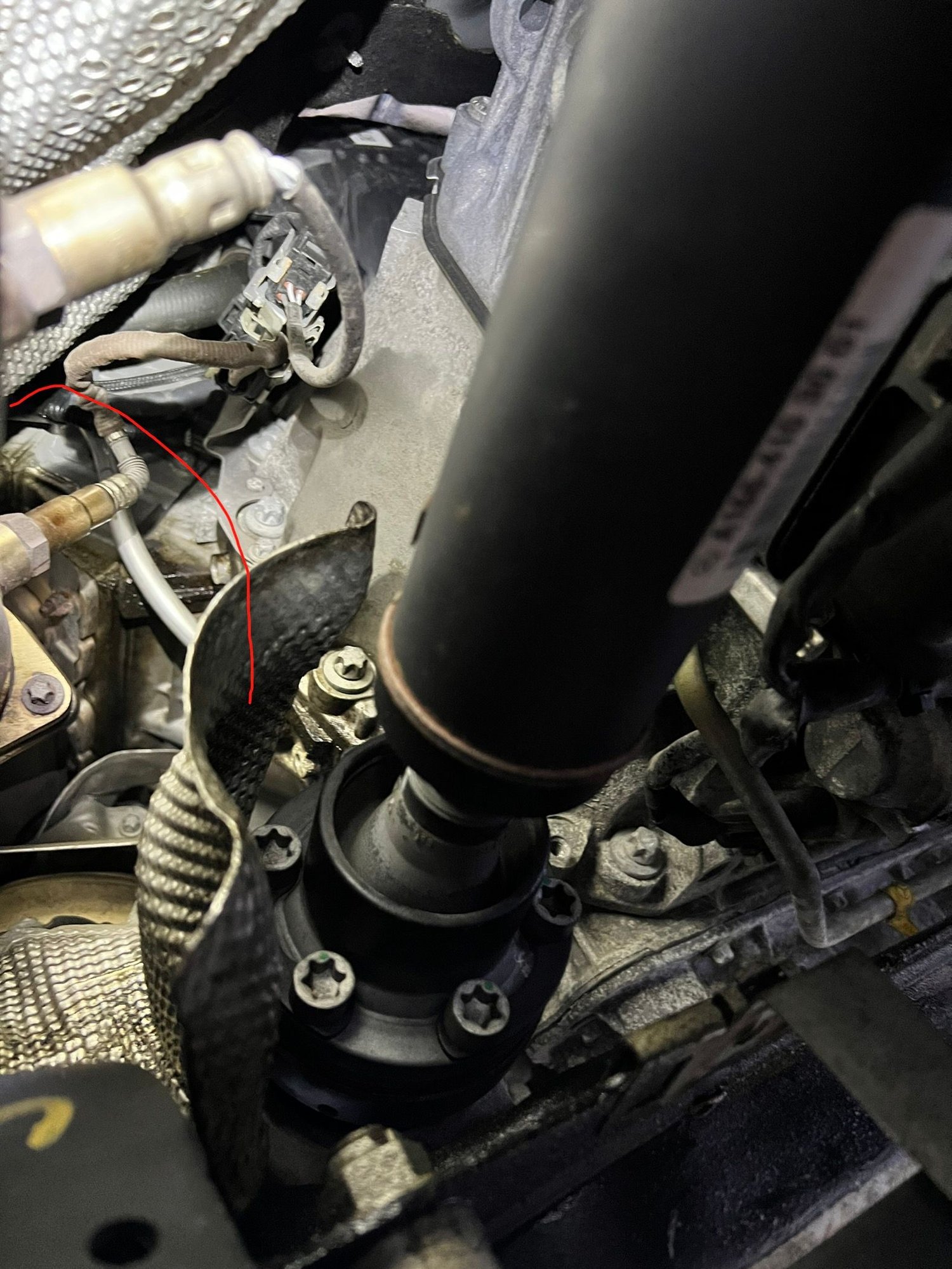

I have had my 17 GLE since October, but within the last couple of weeks I have caught the smell of burning oil, typically when its driven aggressively, but smelled it the other day with the windows down house shopping with the wife. I am not smelling while moving, only when I come to a stop. I crawled under neath, removed the plastic cover so I could see more of the engine and I saw some evidence of a leak on the back of the block on the driver's side. There is a definite stain on down the head, down the block. I am thinking valve cover given its location but not sure if that is a common issue on the M157 or if there is another culprit possibly on that side that I am missing. I did a search of the forums and didn't find anything specific to this but on a comment someone said that an oil leak on the catalytic converter was common but there was no detail to what was the root cause of that. I attached a picture of what I found. Any help is appreciated.

valve cover gasket

On my 2018 GLE 63s coupe when I had it. It had the exact same symptoms. Oil leaking down onto the drivers side cat causing burning smell. It took the dealer a few tries at it to get it right. Thankfully it was covered under warranty.

I appreciate the input. I figured it was most likely that given the location of the leak. It goes to the dealership next week for recall work and I am having them inspect it and get me a quote to fix. Mine unfortunately is not under warranty any longer.

Would it be possible that it is leaking from the camshaft sensor? Or was it just the Valve cover gasket ?

Any update on this? Having the exact issue on my 2018 gls and am hoping its the rear cover and not the valve cover.

My 2017 GLE43 AMG had an oil leak. The dealer repaired the timing cover that was leaking oil onto alternator and a/c compressor
