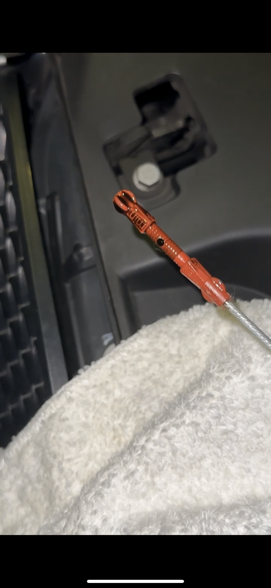

Can someone help out & tell me if i’m safe or not, not sure if there should be more oil on the middle mark where the liquid reached. Add 1 Quart warning came on my dash, thanks.

It will be pretty hard to get a good reading when you turn the dipstick upside down.
It's best to keep it oriented and the same direction as it was removed, and maybe you could clean it better before inserting it.
The oil looks pretty dirty too, how many miles do you have on it?

Oil level should be in between the groove in between where it says min and max. Your oil level is in upper end of that range.
If the oil hasn't crept up the threads in that orientation, you are correct.
