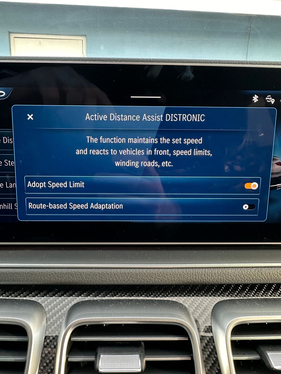

I attempted to change this and it seemed to work for about a week, but then it started automatically changing the speed back down to the speed limit even though I thought I had turned the feature off.
Can you show us a picture of your settings page? Maybe you're missing something.
These are the settings I had them at. I was confused when I first looked at them but I switched them just now. What is Route Based Speed Adaption? I feel like they both do the same thing?

Yes! It is annoying and dangerous, and I disabled it. On my 23 GLE, it's in the assistance menu under "Traffic Sign Assist" then drill down to adaptation.

Route-based speed adaptation is another entirely different thing which I don't think relies on cameras.
It relies on its knowledge of the road, based on the most recent map update.
Which means that it anticipates the next corner and the next speed limit and the next corner speed warning sign, according to the navigation route you have set and your GIS position.
In practice this means driving at the speed limit, slowing a quarter mile before the lower speed limit ahead, slowing to the posted warning speed for the next corner, which is 10 or 20 mi an hour below where people normally drive.
There are two systems that, in my opinion are equally infuriating, and I turn them both off in the menu.
One is route base speed, and the other is speed sign recognition (or similar wording).
I still don't fully understand what route-based speed does, because I still slow in corners, even though I don't have a destination set - thus no "route."
I'd be curious if you have them both turned off (as I do), because I don't think your experience should be happening.
Route-based speed adaptation automatically slows down in curves, and as you approach intersections or roundabouts as well as highway exits if you activate the turn signal ahead of the exit. These work even w/o an active route. If there is an active route, then it automatically slows down for turns and exits that it knows you are going to take based on the navigation route. So instead of having to signal that you are going to exit the highway, it already knows it based on your route and starts slowing down for the exit. It also automatically slows down for other things such as toll plazas etc. They are all listed in the owners manual and the function is pretty well explained there.
The route-based speed adaptation and speed limit adoption are separate features and options as shown above and can be turn on/off independently. I have the automatic speed limit adoption turned off, but I left the route-based speed adaptation turned on. A nice feature is that you can always manually adopt the current speed limit by pressing RESUME while DISTRONIC is engaged. I use that to set the initial speed for DISTRONIC based on the current speed limit and then manually adjust up for the usual 10-20 mph over. I never actually use the SET function to take the current speed as the DISTRONIC speed.
Thanks for your clarifications.
My experience is similar in some ways, but definitely not when Route Based Speed is disabled but Distronic enabled.
In my case, the car slows in corners whether I like it or not. If I'm following a line of cars on a curvy Road, the line leaves me behind as we go around corners.
It's more than scrubbing off speed, because I see my regen green line in the instrument cluster indicating Active Regen (retarding, slowing). With the cruise set at 60, it might slow to 56. I become a moving obstacle.
These observations are my for my 21 GLE 53.
Separately, ​​​I absolutely detest route-based speed navigation.
Wherever possible I drive two-lane blacktops. Most often, the speed limit is 60, with occasional slow corners marked 35 mph. Normally I would probably slow from @75 and take those corners at 60 or 55 mph. However, the car slows me to 35 mph about 1-2/10th of a mile before the turn. If there's anyone behind me, they charge right up on me because there's no reason to slow that much, so soon.
I hate it.
Also I'll add that the "adopt the current speed limit by pressing RESUME requires a double press on Resume. I'll do that when the radar detector goes off. Maybe.
