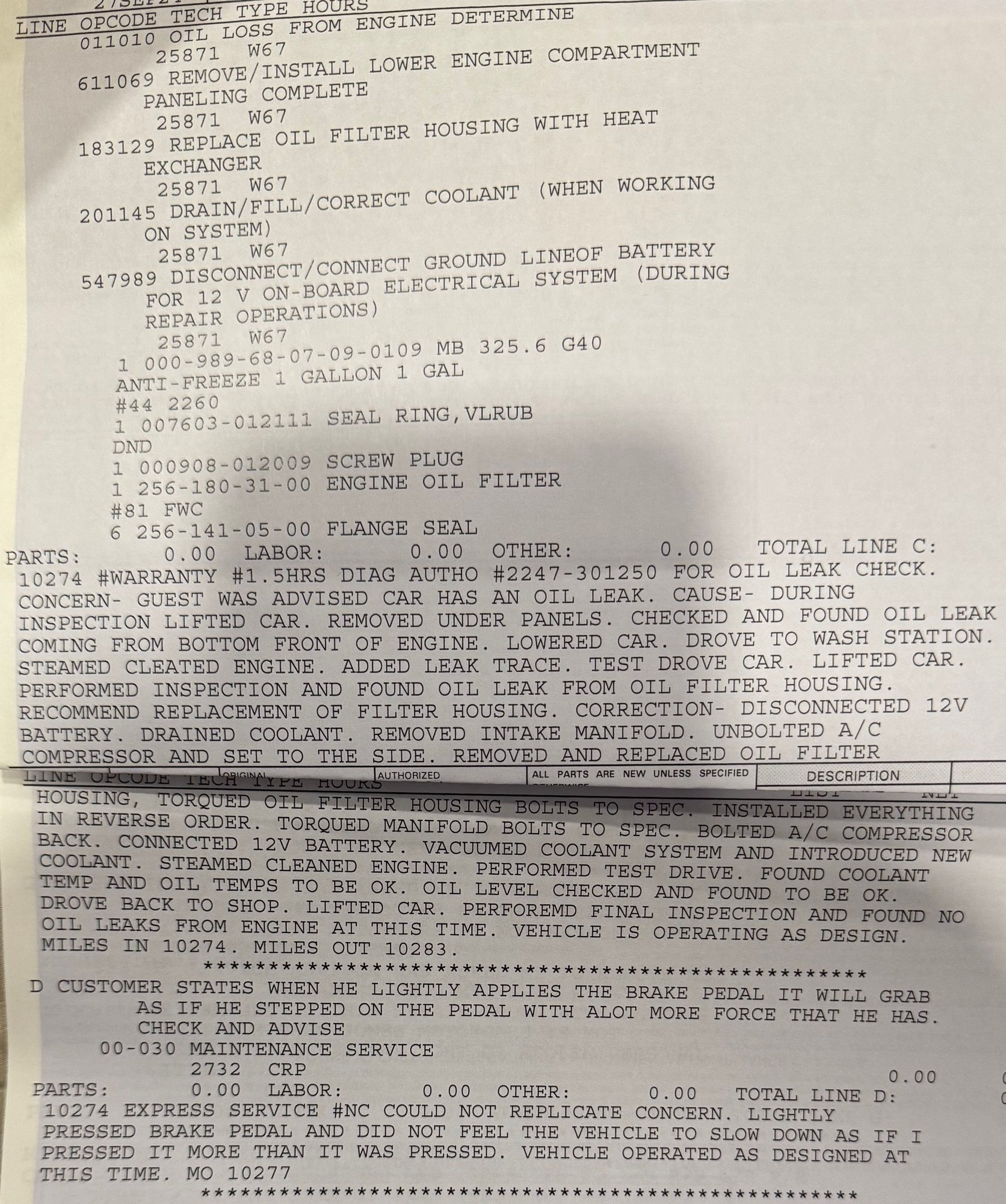

Oil leak in 2024 AMG GLE 53 within 9k miles? Oil leakage in this new AMG GLE is this normal?
I am surprised to see this massive repair within a new car that not even ran 10k miles? I am worried if this is something that repeats very often?

Looks like maybe it was just the oil filter housing? Curious as to why they drained and replaced coolant. I am not a mechanic at the least so maybe someone with more wisdom can chime in.
Can I guess? Wait, have you seen the Meow scene on SuperTroopers? I know first hand service advisors who will have contests to sell "services" to people that their vehicles just dont need....
https://cimg7.ibsrv.net/gimg/www.mbw...f00609840.jpeg
Agree. Certainly strange they have to touch the coolant and a/c compressor to replace an oil filter housing? What am I missing?
