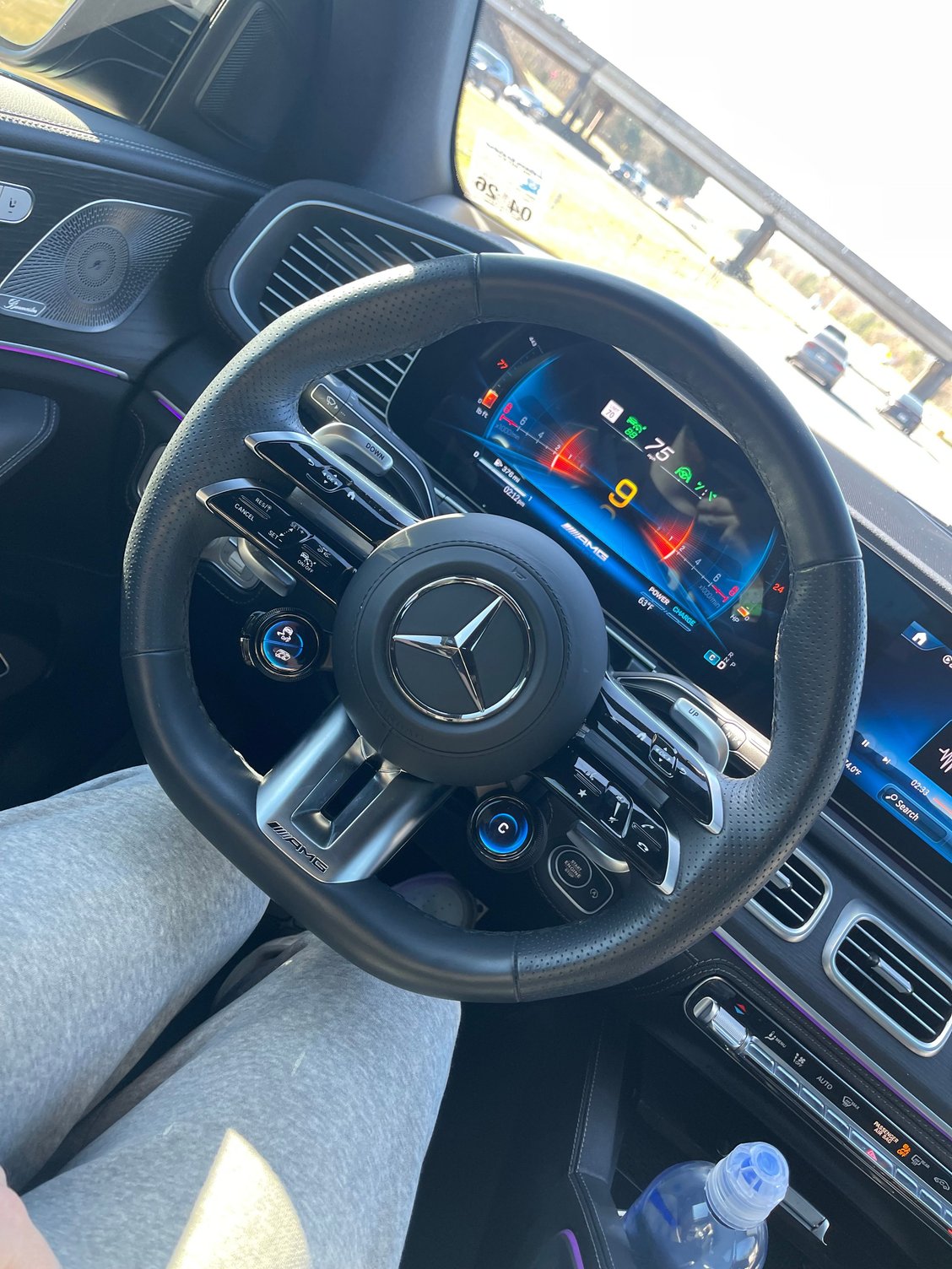

Every couple days I enjoy putting it in sport + after it’s warmed up and really pushing it. I love the feeling of taking off quick and feeling that initual pull/ push. I know it’s normal to have quicker accelerations and for it to vary depending on certain factors, but I feel like half the time I can’t feel the electric tourq at all/ you wouldn’t even know it was a baby AMG & really feel like my 2019 e300 on sport + takes off quicker and is more aggressive right off the throttle. On the other hand (the other 50 % of the time) it really makes me smile, you get that instant boost and it takes off like you would expect it to take off. I know this isn’t a 63s but the fact that this car does perform like I expect it would makes me question why half the time it doesn’t. Of course everything looks good and no lights are on. Is there any way to tell if something is wrong? I have watched the performance screen a few times when pushing it and all the HP & Torque #’s look like they are where they should be (to me at least).

The ISG is only used for "fill," not continuous power. You can see it's effect in your instrument cluster, or set a separate display. The The instrument cluster display is at the lower right, and also shows regenerative braking - the green portion.
