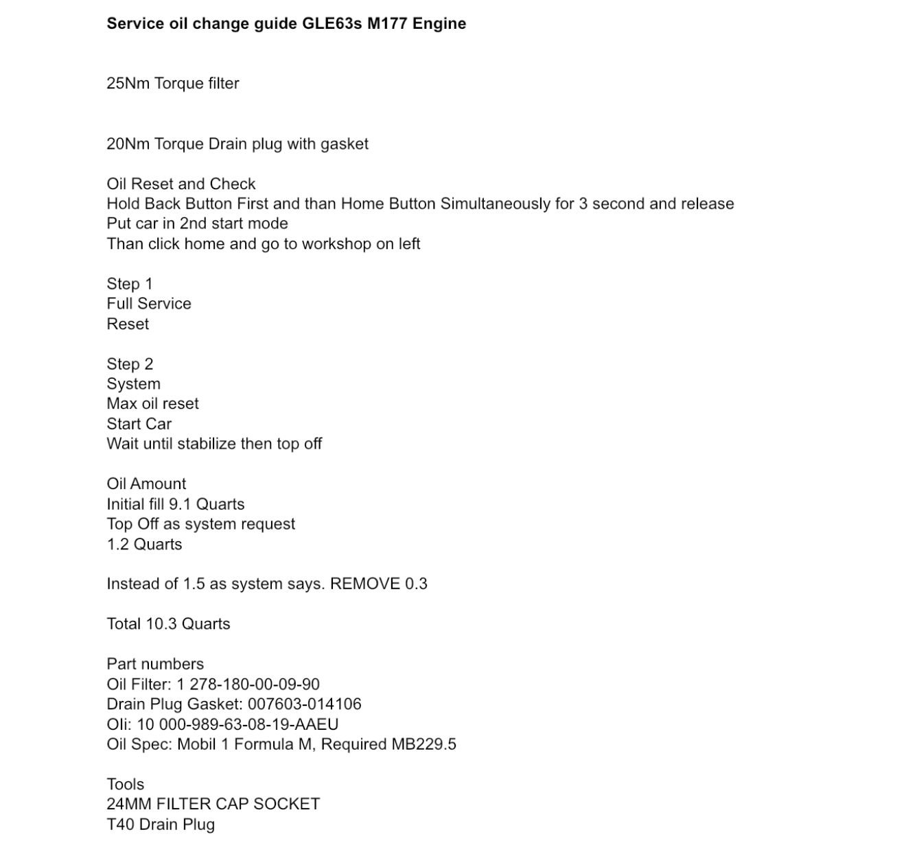

The 63 is down the thread a little
https://mbworld.org/forums/gle-class...hange-oil.html
And another
https://mbworld.org/forums/gle63s-gl...sing-size.html
