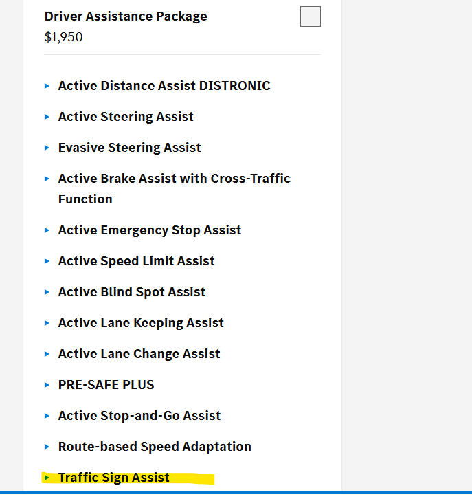

I just checked out benzninja site - interesting concept - they actually let you rent needed tools and you do it yourself? Hmmm m
But good news it looks like it can be done:

Yes, you can get TSA (Traffic Sign Assist) working by remote coding in most of the countries. To code this TSA, you need buy a coding tool (OpenPort 2.0, $30-40). Or other tools. And a windows laptop (borrow or buy a $99 one in Walmart, if you don’t have one). and fast internet.
Expensive tool, which is not necessary like c4 or c6 for a quick coding job.

It was included on my 21 GLE63S SUV as either part of one of options either the Drivers Assistance Package Plus or maybe the AR navigation or maybe the HUD. I do not see where it listed in the brochure under which option though. Not sure I would miss it of it wasn't there as the camera does not always see the signs or interpret them correctly. Example in SC minimum speed posted with the maximum limit on the sign...

I was looking for speed limit display which is apparently comes with Driver Assistance Pkg as an option
