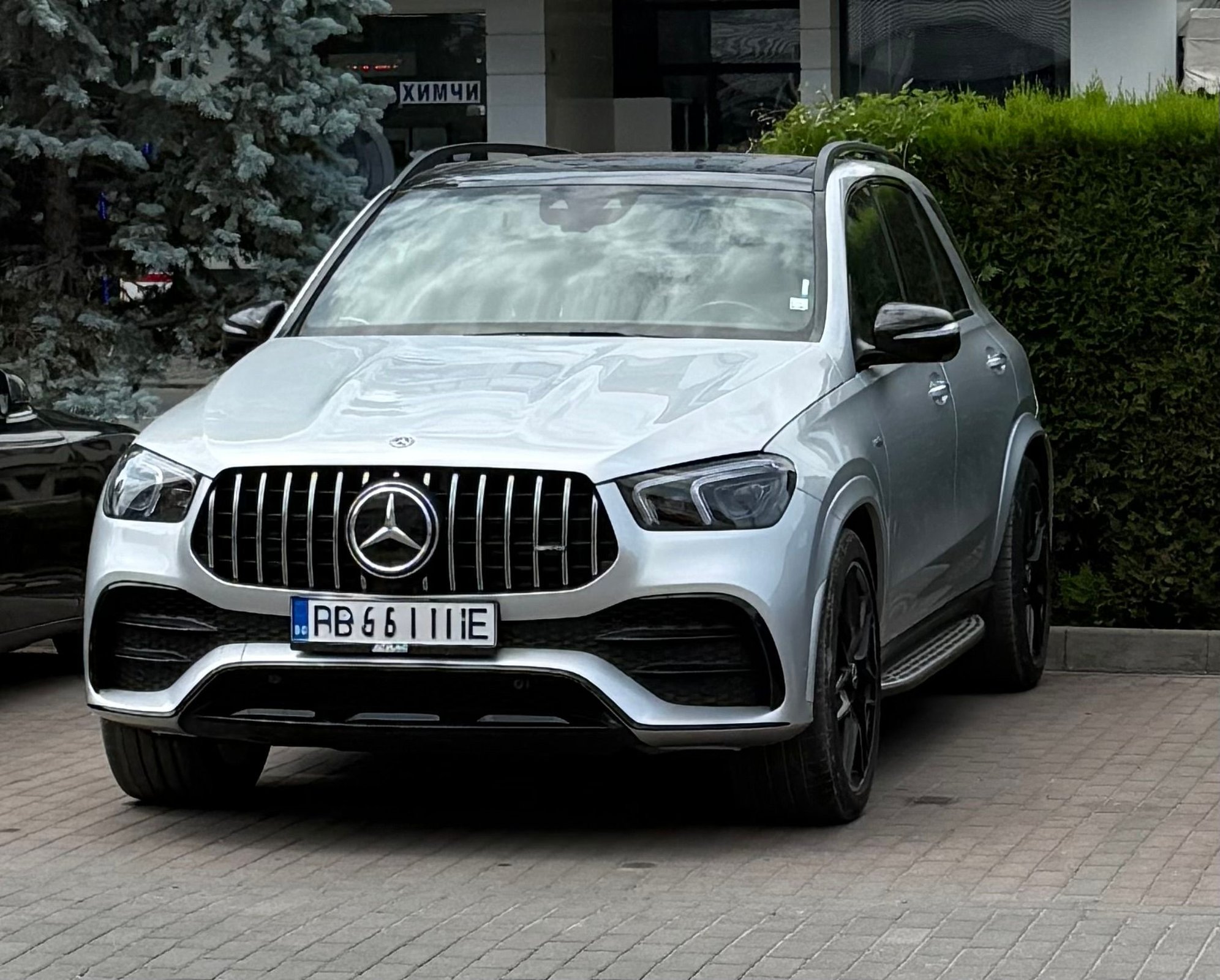

P.S. Here’s a pic of the beauty.

Stick with the MB229.51 oil. The .5 is an older spec and isn't optimized for your GLE53's engine, especially with its gasoline particulate filter. Using it won't cause an immediate catastrophe, but long-term, the .51 oil provides better protection for your specific engine. Don't risk it for a minor difference; use the correct oil. Sweet ride, by the way.
