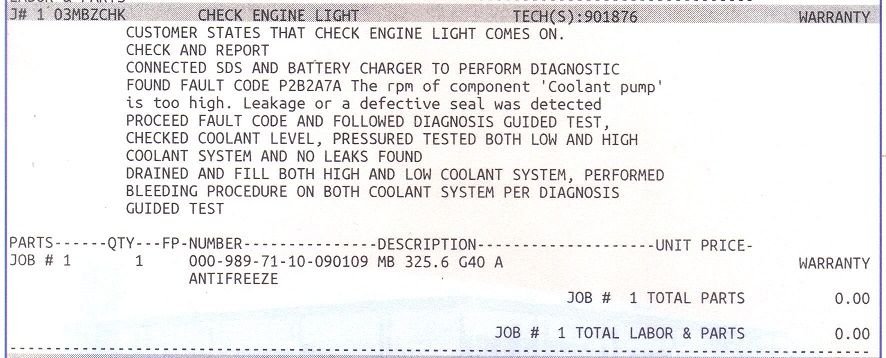

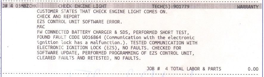

I've had 2 CEL since buying the car. Neither are related to Recall:
CEL May 2025 - 1,664 miles:
CEL Apr 2026 - 2,939 miles:
