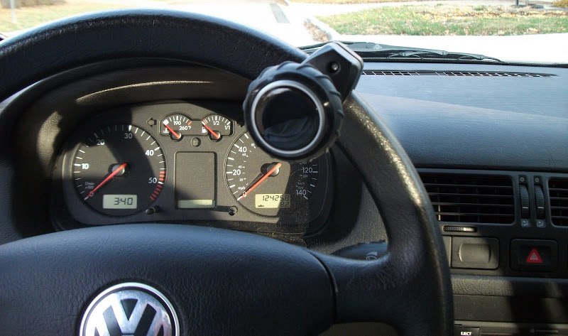

Brodie knob?

3.5L, we used to call them suicide knobs. Haven't seen one in ages.

Funny, We use to call them ' Necker Knobs". You could drive your '58 396 Chevelle with you left hand and be 'necking' with your right arm around your girl. Of course that was back in the bench seat days when all she had to straddle was the Hurst. Until you got to the dive-in.
Seems we could leave figure 8 tire tracks with the knob. No problem-O
