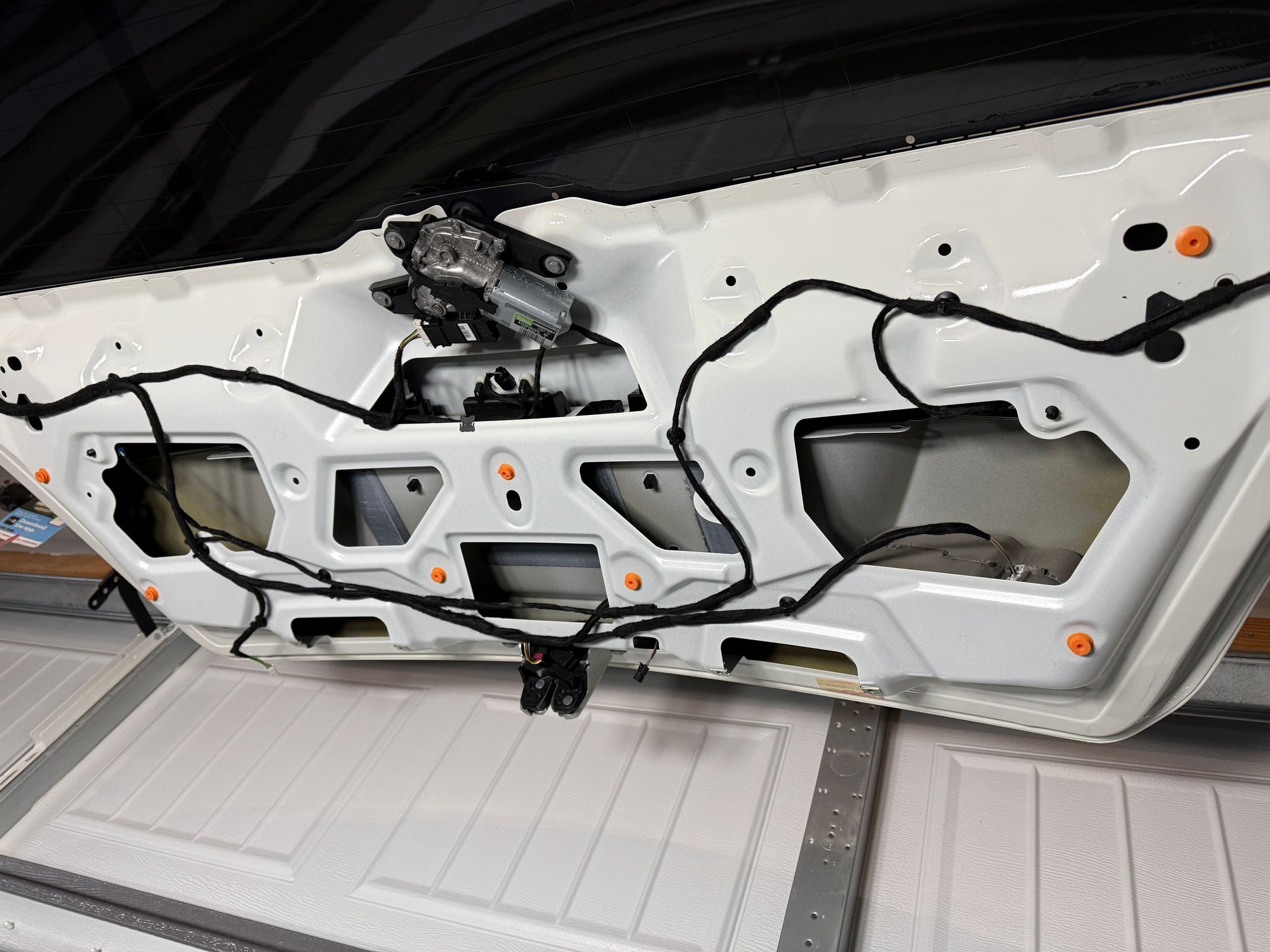

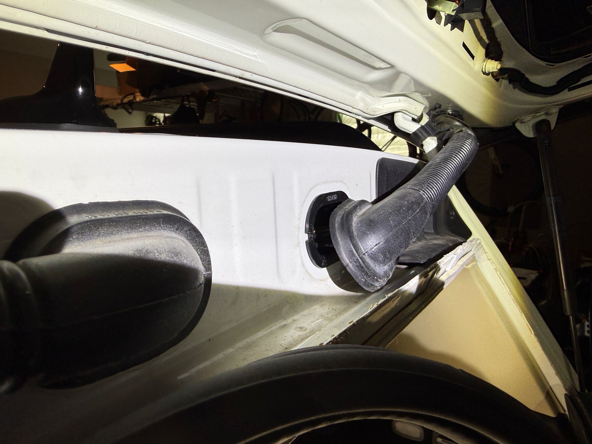

REAR DASHCAM WIRING:

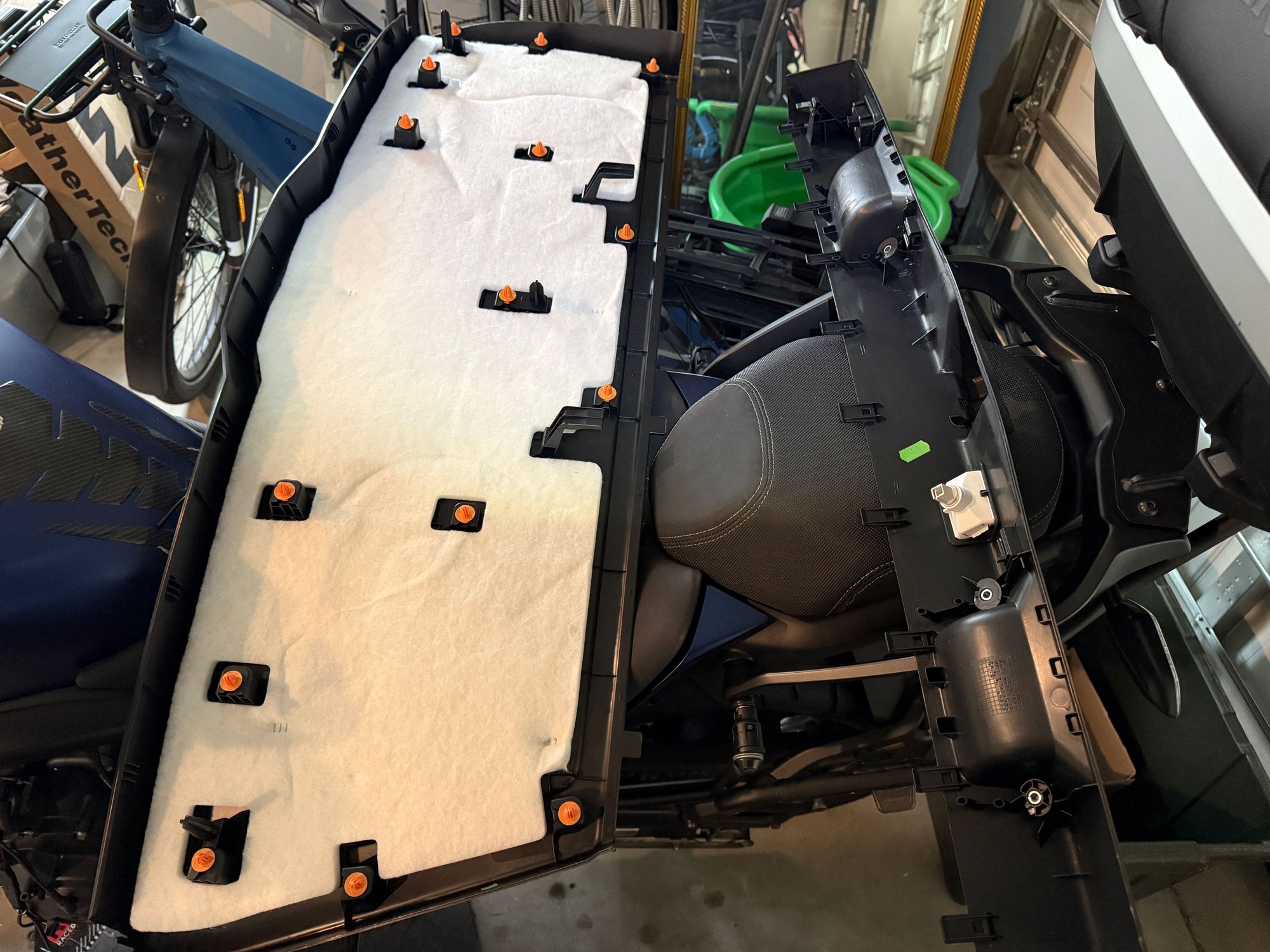

  • 1st challenge: Getting the rear trim off the rear trunk/boot was NOT easy. Broke at least 2 trim removal tools trying to remove the black plastic at the bottom of the rear trunk, the rear trunk big plastic section, and the passenger side of the plastic trim cover right by the rear glass. You need to have a metal trim removal tool in addition to knowing you're probably going to break a few of the plastic trim tools because the leverage needed to get the trim panels loose from the fasteners was quite high.

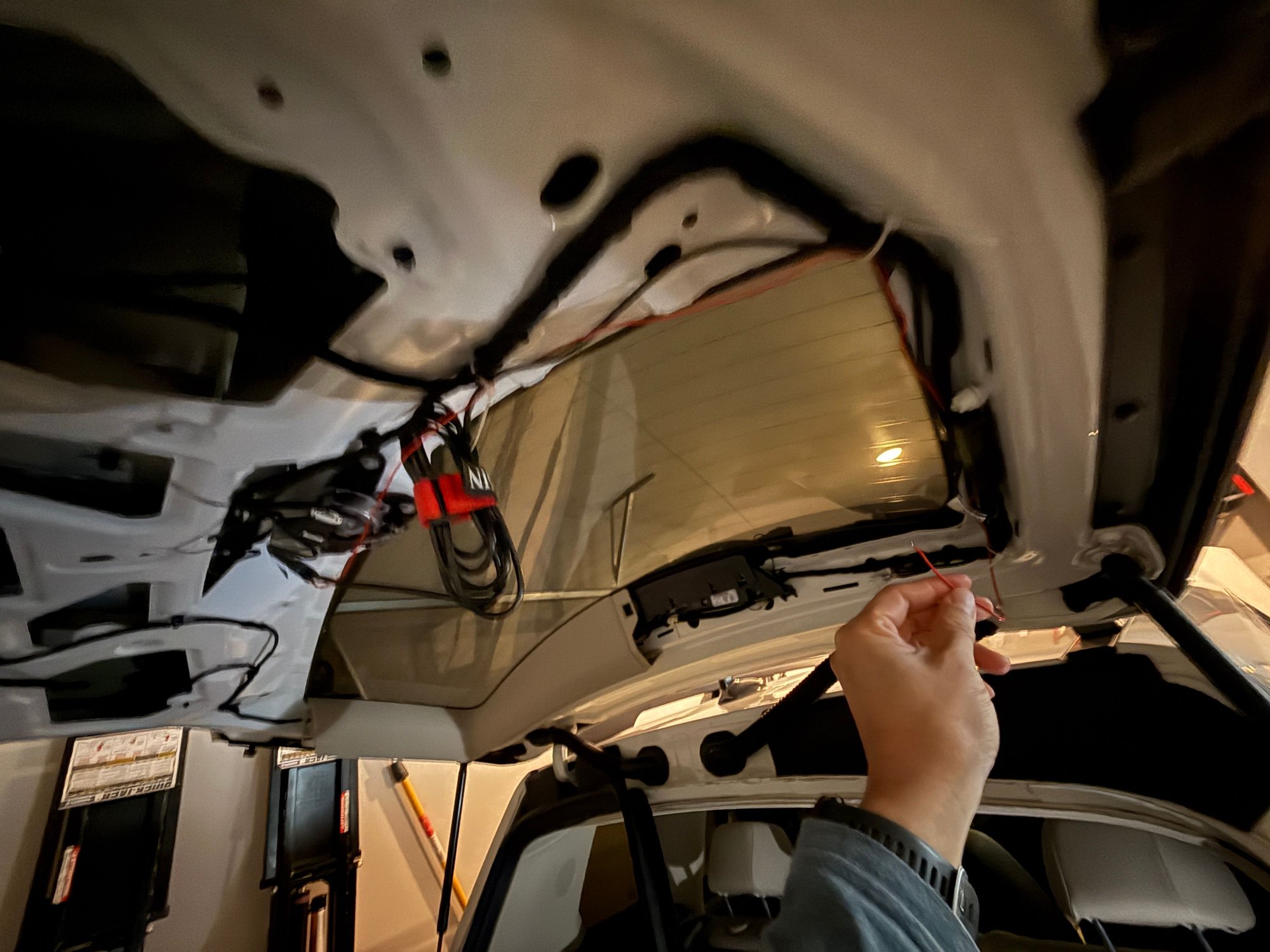

  • 2nd challenge: Trying to run the cable through the protective rubber boot located at the top of the rear trunk. The rubber boot has a very thick pre-existing wiring loom in it and it was challenging to run the dashcam cable through the tight boot without it getting snagged on any of the current wires. Initially tried using a toilet snake but the snake tool was too big and kept catching on existing wires. Ended up using a long flexible grab tool and taped over the grab hooks and then used liquid wrench / WD40 to lubricate it before sending it through.

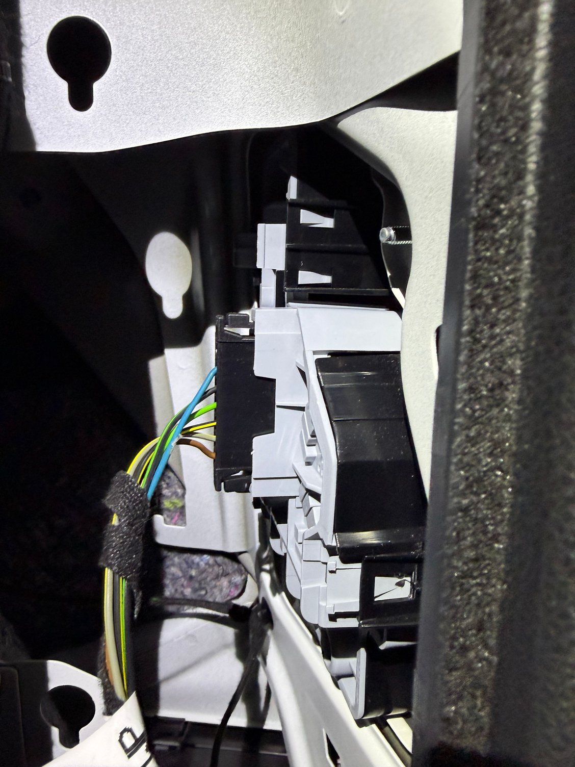

  • 3rd challenge: After I finally got everything through the rubber boot I then encountered difficulty trying to reinstall the rubber boot back into its grommets. You CANNOT just shove it back on because one has to remove the plastic cup in the 2 grommet holes first (and there is a special technique for that because they're are 4 retention tabs on each of the cup grommets that was not initially apparent).
  • 4th challenge: After I thought I was done with that, I realized that the rear dash cam also has a red wire used to connect to the wire that goes to the reverse lights. When connected correctly to a reverse light wire, this red wire sends the signal to the Wolfbox mirror display to activate reverse lines in its rear view display. The mirror display works as a regular rear dashcam if you don't connect this, but one of the key reasons I got it was specifically to assist with backup parking. This red wire must also be extended and routed back through the same rubber boot, between the rear headliner, and then channeled down to where the wires go to the rear taillight in order to take advantage of this function.

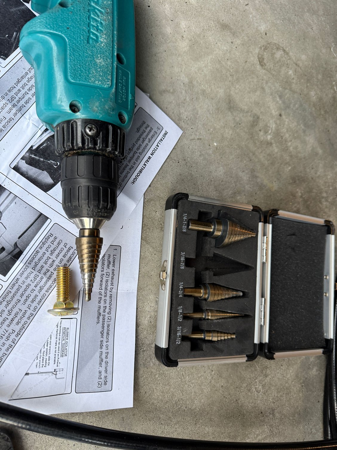

  • 5th challenge: Mounting the rear dashcam, I had to take out the rear popout cover beside the license plate area and drill as passthrough hole for the rear dashcam wiring. Not particularly difficult if you have a drill and bit that can cut through hard plastic, but it was messy - plastic shavings everywhere. Strongly recommend you do this over a trash can and not over your kitchen sink where it might cause a clog.

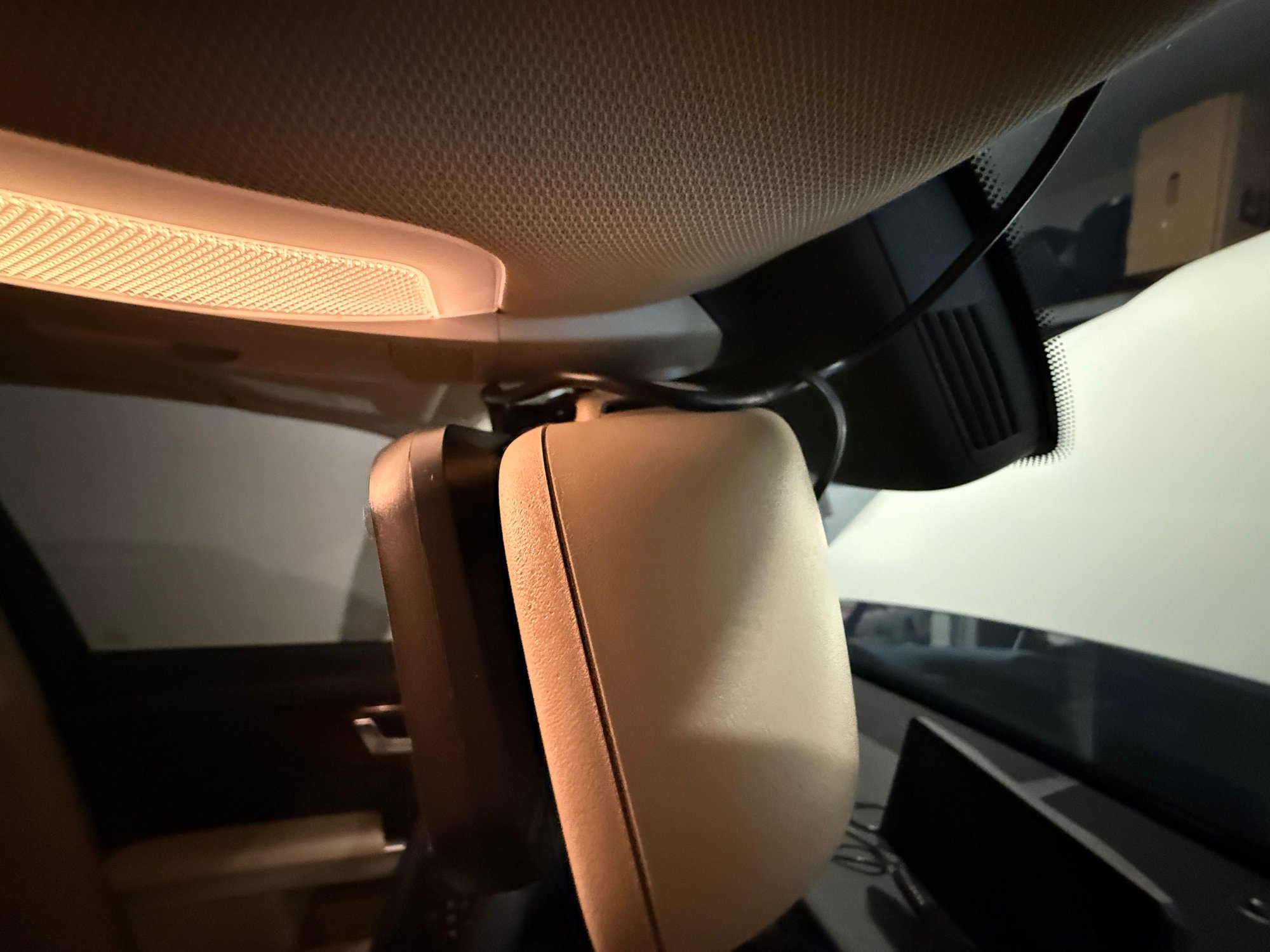

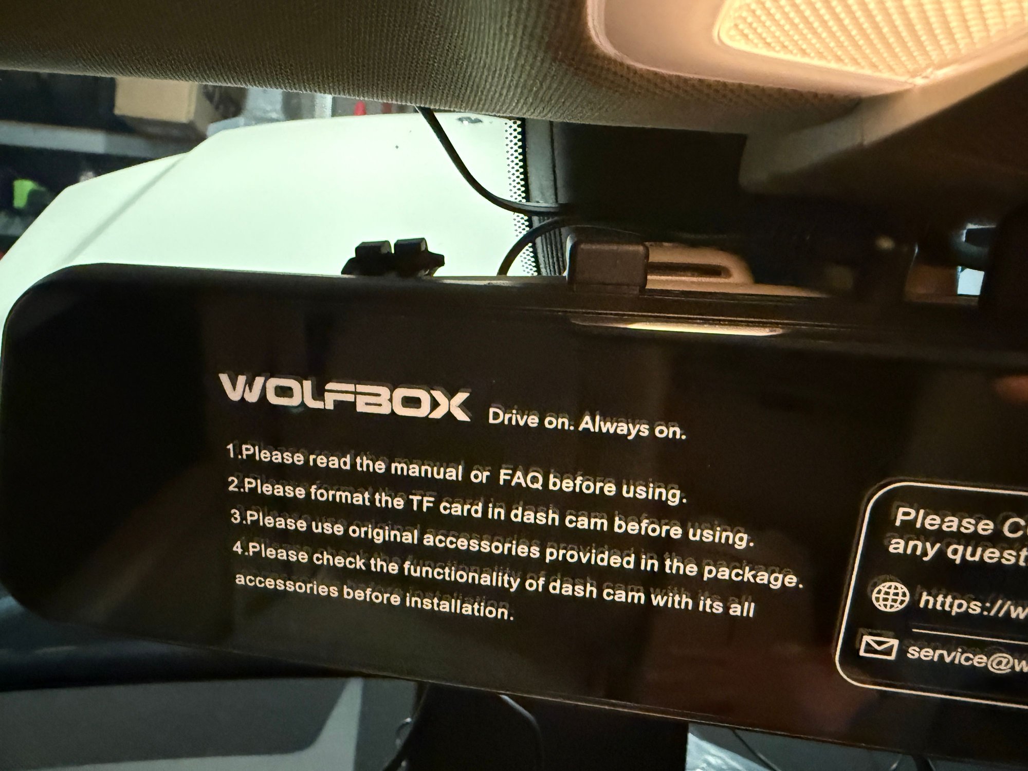

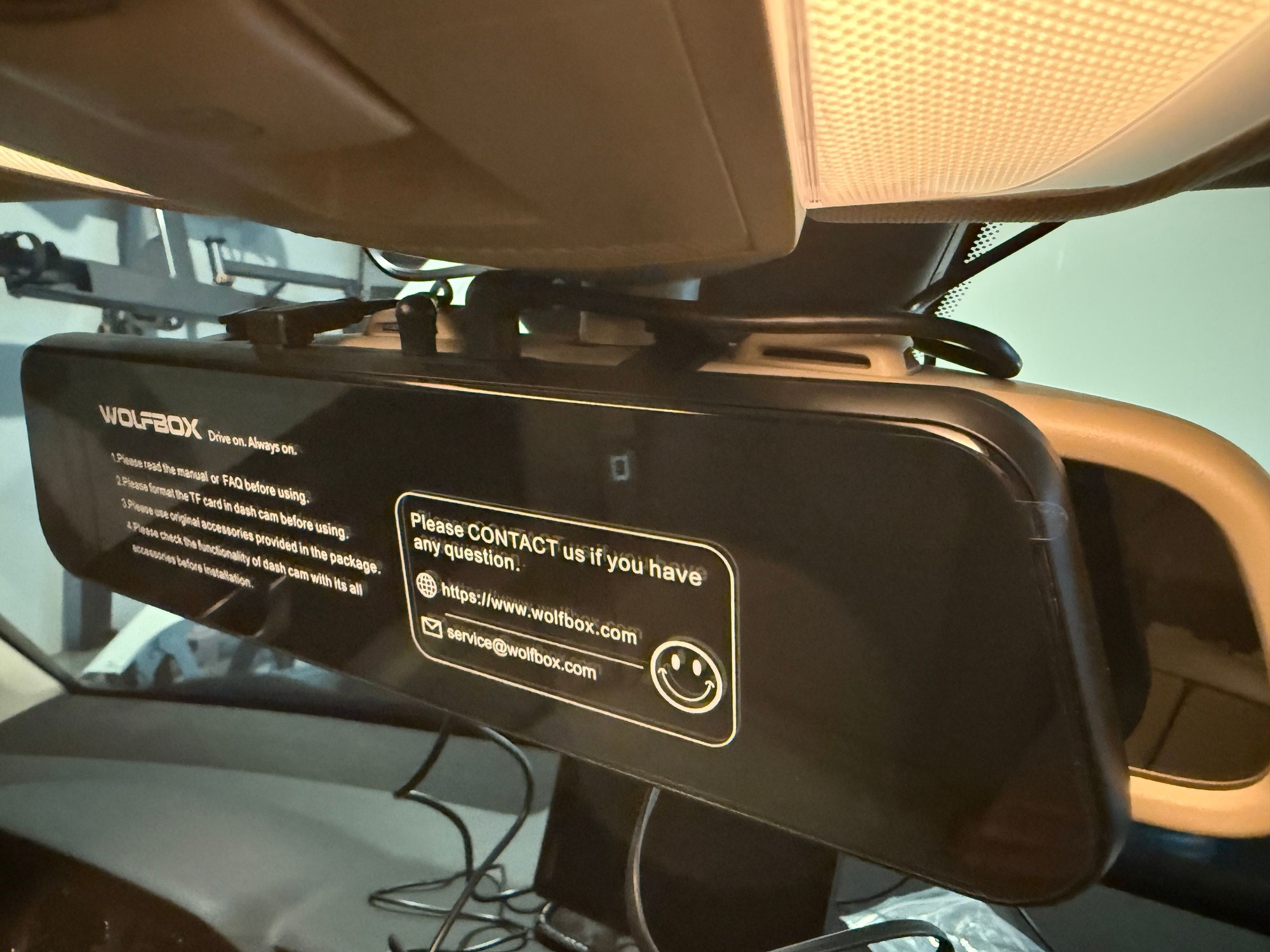

Challenge 1: The Wolfbox G900 Pro front dashcam mirror install fits "ok". I'll explain why I say that.
Now I knew beforehand that the mirror itself would have to be offset some to the left of the existing mirror for the front facing dashcam to be unobstructed.
What I didn't expect was that the existing 2 large bumps on top of the mirror would also force an offset of the mounting. The existing straps longer provided IMHO feel beyond a normal stretch limit for rubber and I believe that they are a little too short to fit directly over the 2 top bumps ot the stock 2012 GLK350 mirror. The Wolfbox G900 Pro mirror dashcam offends my personal aesthetics somewhat because it looks super bulky mounted on top of the chunky stock 2012 GLK350 mirror, but because I didn't want to lose my Homelink garage button capabilities in the bottom of my existing mirror and replace the stock mirror in its entirety with a replacement mounting kit that came with my Wolfbox Pro, I had to accept it.
On the 2012 GLK350 the 2 large humps on top of the stock rear view mirror are considerable and I had to use the larger rubber retainers for the Wolfbox mirror to even have a chance at being secured. I felt as though the stretch of the 2 longer rubber retainers exceeded my comfort level when trying to fit the Wolfbox mirror directly over the 2 top bumps. The stretch seemed more acceptable and not quite past the point of too much if it was offset slightly towards the driver without the rubber directly over the bumps. I know other owners that have managed to mount directly over the stock bumps - will depend on whether you're comfortable with that.

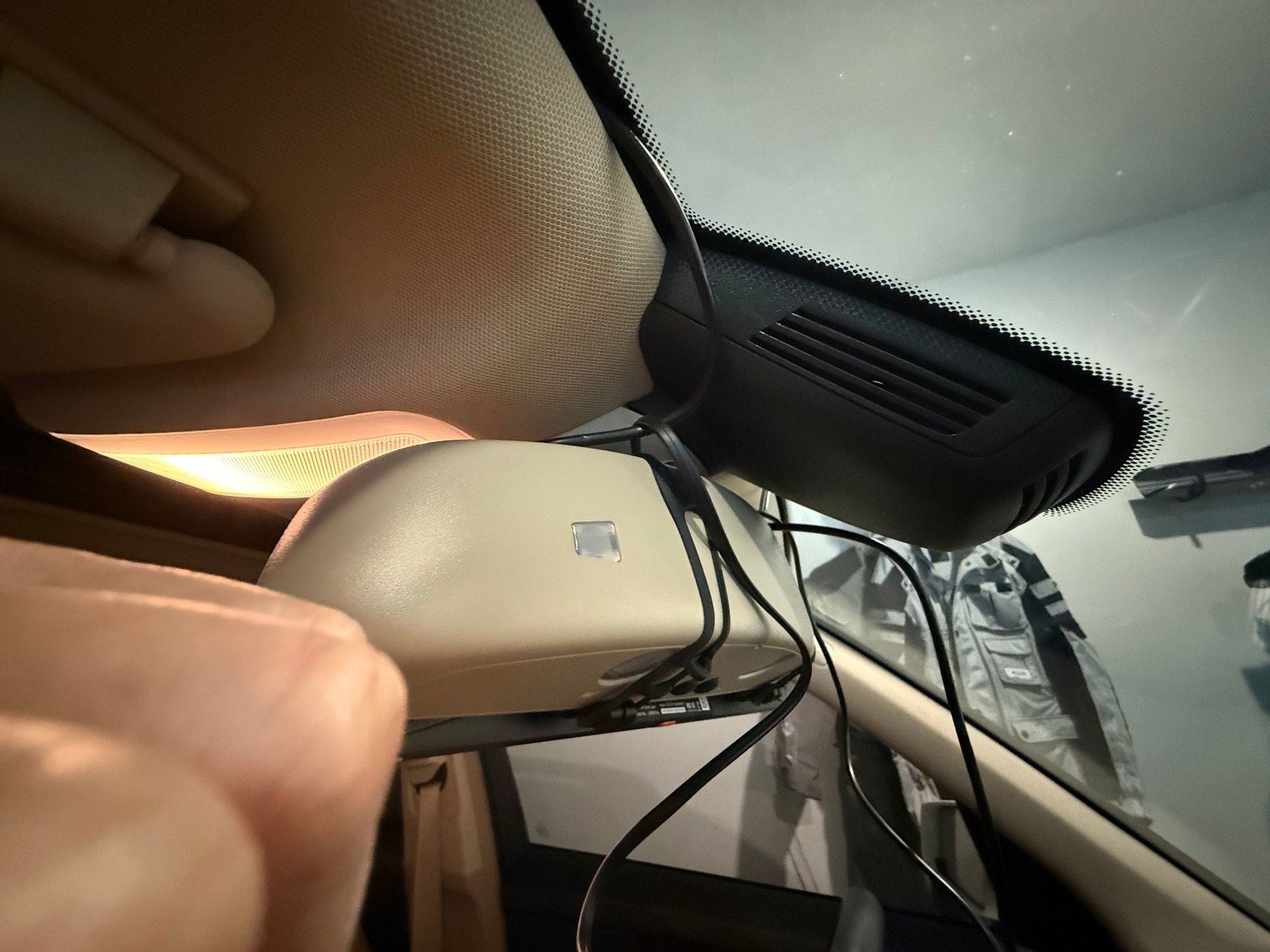

Easiest part was hiding the cable along the upper passenger trim from the front mirror to the rear. This part took relatively little time and was easy compared to what it took to get to this point.
There are 3 sets of cables coming out of the Wolfbox G900 Pro to be routed during install:

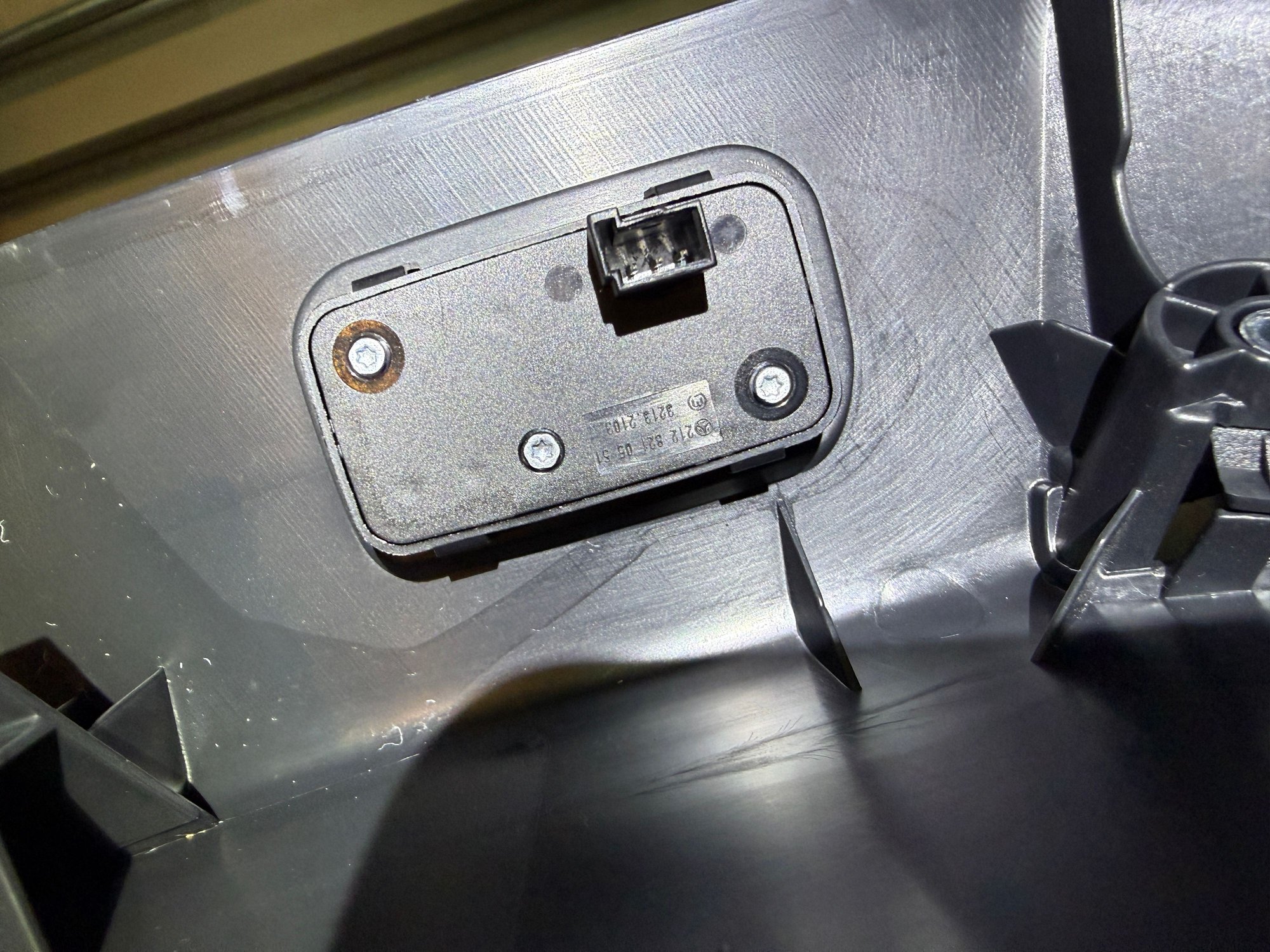

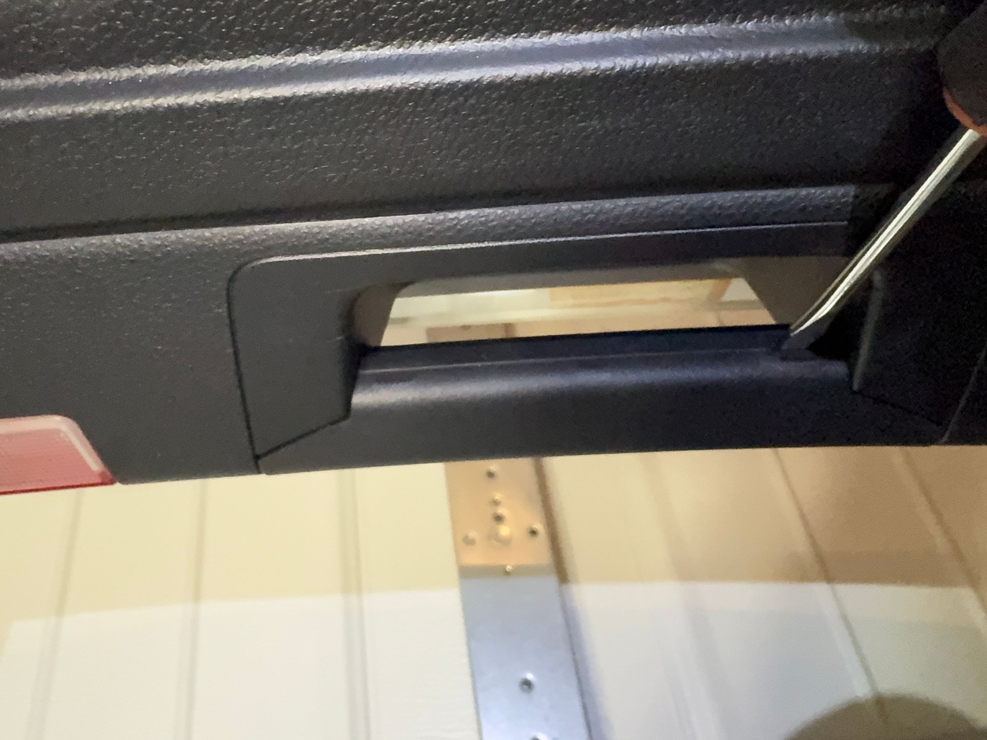

Trunk handles have to be pried off with flathead screwdriver first to access the 2 screws to be removed.

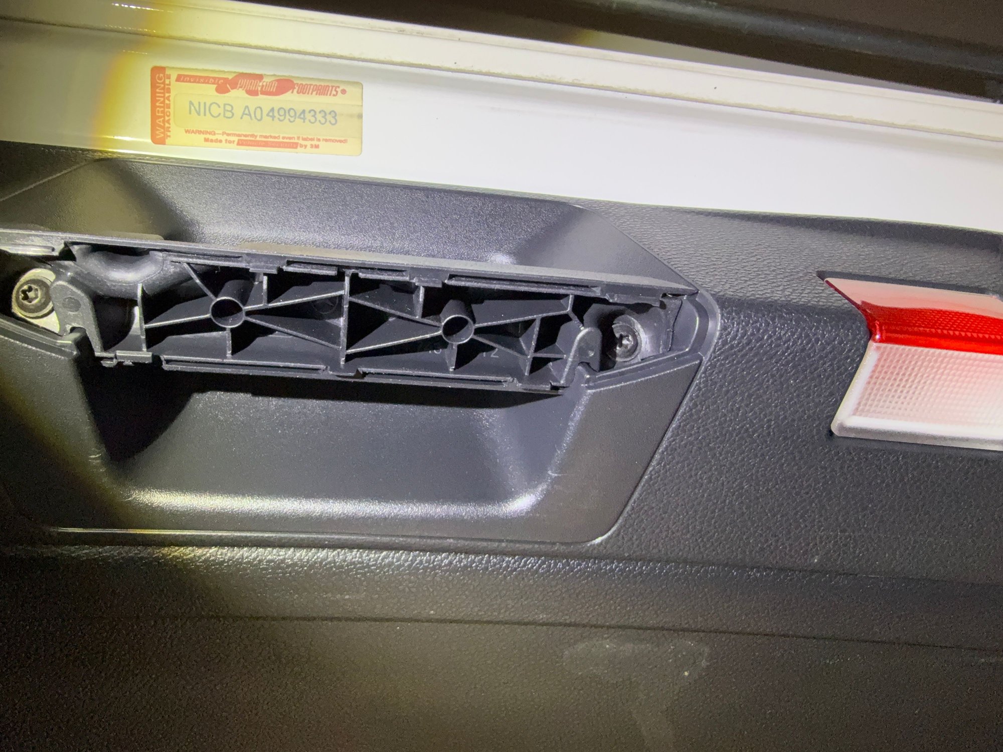

2 screws to be removed once handle covers are pried off.

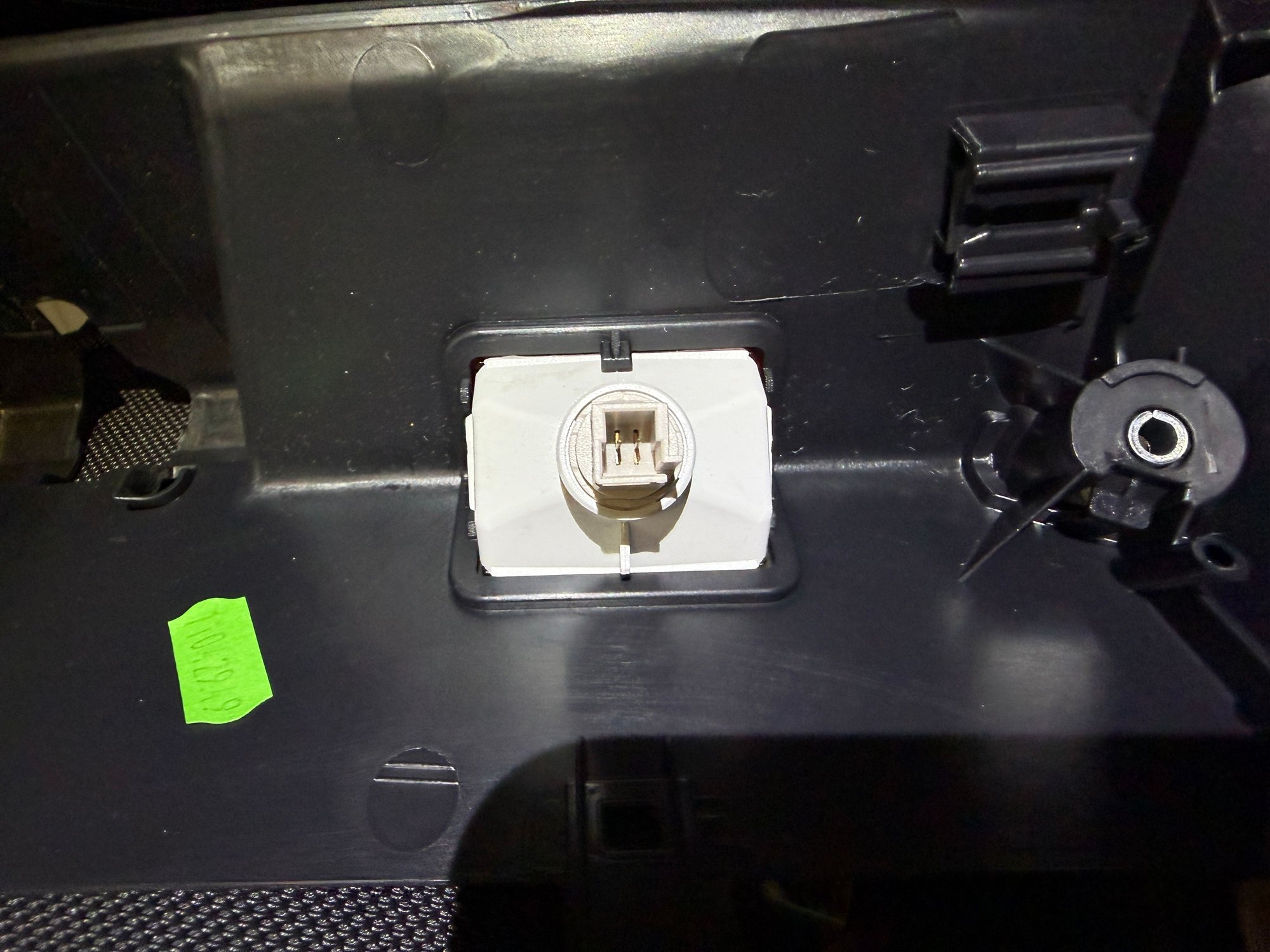

Trunk/boot light wiring to be disconnected.
Trunk/boot power switch wiring must also be disconnected to remove rear trim.
17 interior fasteners (orange) that have to be loosened in order to view the rear trunk lid/boot interior.
15 interior fasteners (orange) that have to be loosened in order to view the rear trunk lid/boot interior.
After the rear panels’ 17 orange fasteners have been pried off this is what you see for the rear trunk interior.
After the rear panel's 15 orange fasteners have been pried off this is what you see for the rear trunk interior.

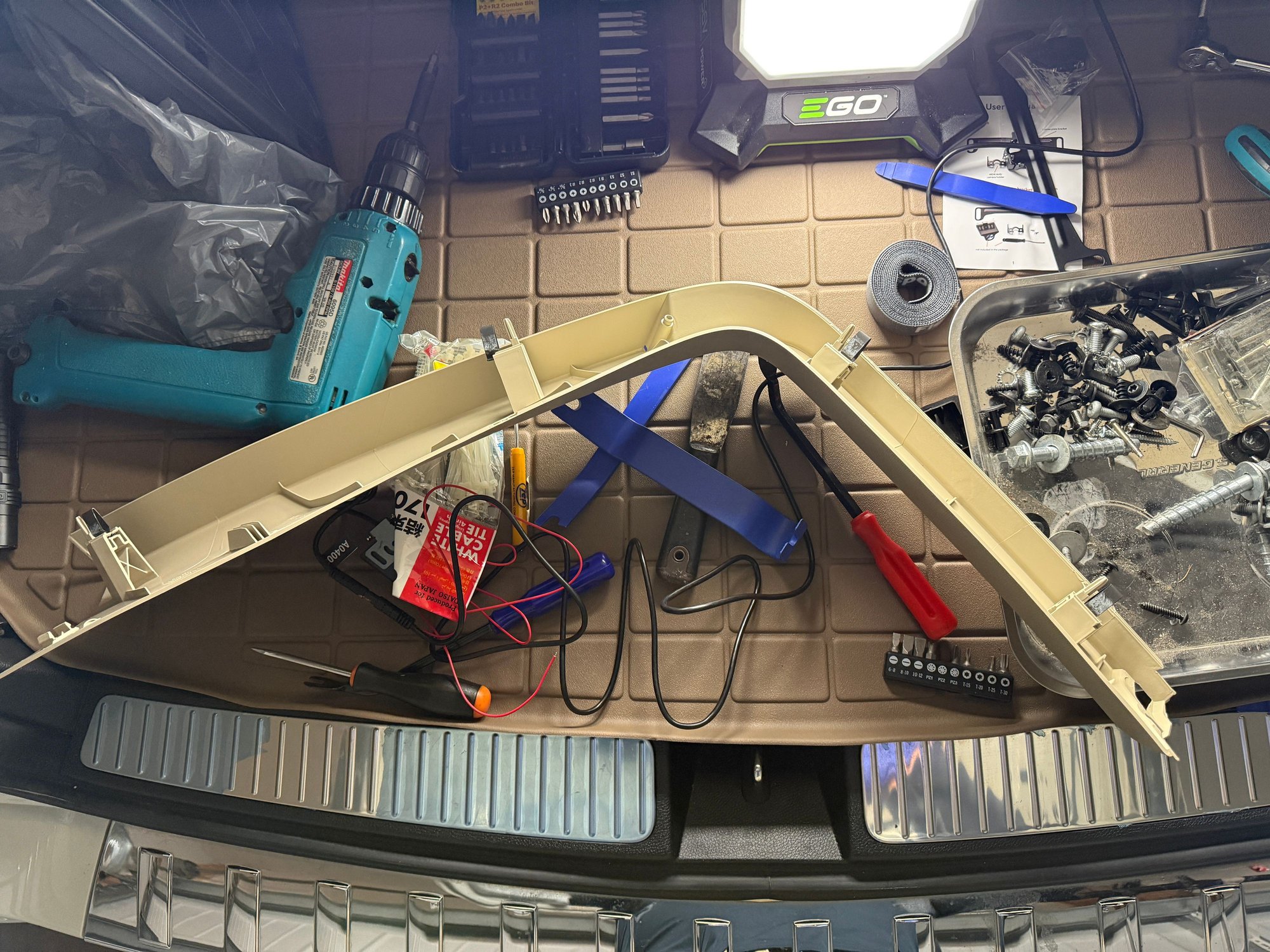

Passenger side rear glass frame plastic that has to be removed in order to run the rear dashcam wiring to the rear.

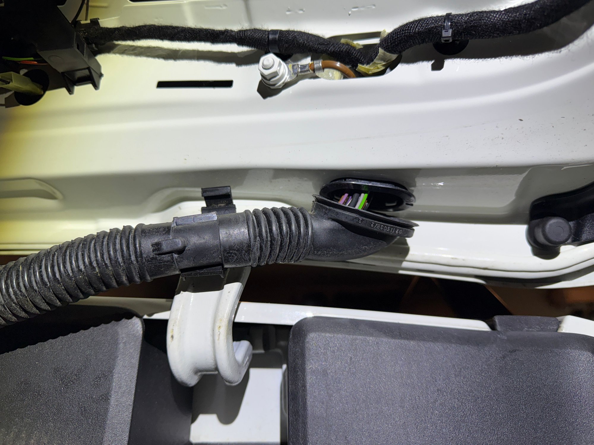

The rubber boot that the electrical wiring loom has to be routed through.
Passenger side rubber boot detail for wiring loom routing.

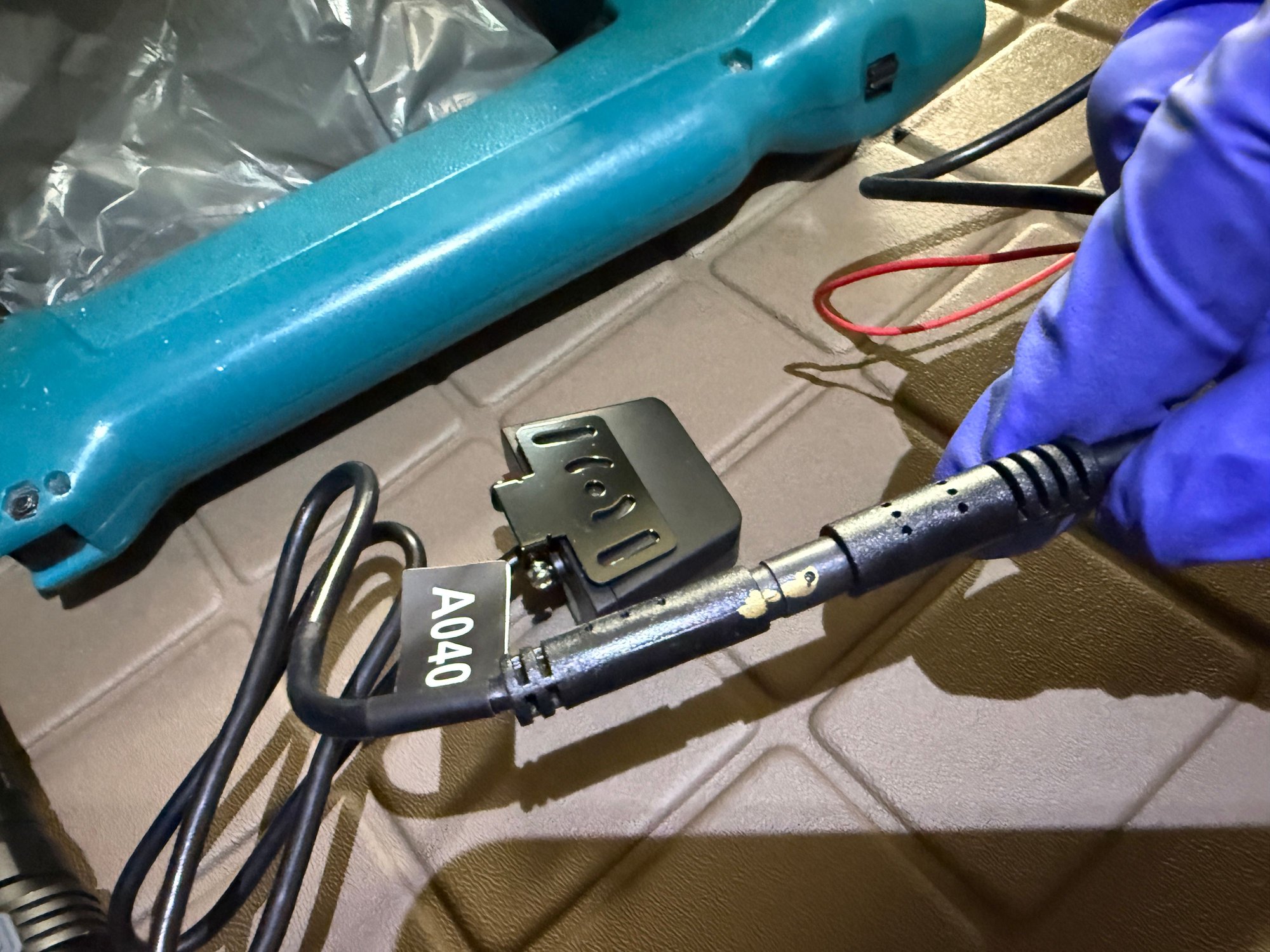

Rear dashcam red wire that has to connect to the reverse light wire so that the Wolfbox G900 Pro mirror knows to trigger reverse parking lines in its display.
The Wolfbox rear dashcam can be disconnected so that you don’t have to try and route a dashcam  through the rubber boots. Recommend using a permanent marker to illustrate where the cable lines up to prevent damage due to incorrect positioning of the very small guidance tab.
2 top bumps on top of the stock 2012 GLK350 mirror. Not sure what they’re for.
The offset of the Wolfbox G900 Pro if you don’t have the rubber directly over the two top bumps of the stock mirror.
Side view of the chunkiness of the Wolfbox G900 and the stock 2012 GLK350 mirror.
Backside view of the stock mirror with Wolfbox G900 Pro mounted. Wires to be cleaned up after finalizing hardwire connections.
Drill bits used to create a hole in the rear dashcam popout plate to allow the rear dashcam cable to be connected. NOTE: will need to caulk/waterseal any gaps to prevent water from entering this hole after running the cable through.
Drill bits used to drill the hole in the pop out rear cover large enough to allow the rear dashcam cable to go through.
