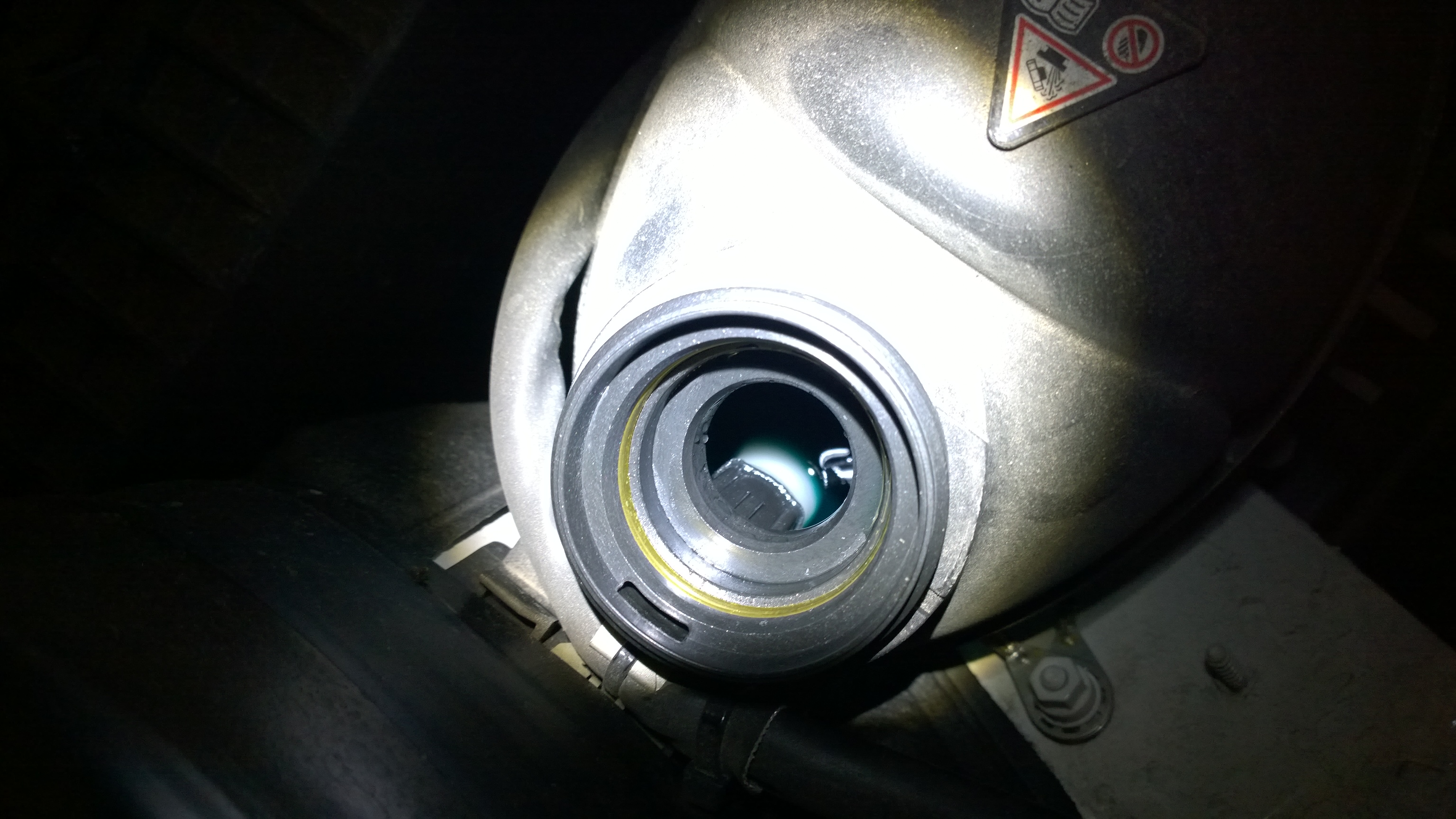

Hi, i received a check coolant warning in the speedometer window, and then I checked the coolant when the engine was cold (below 40C), and I took pictures because I don't know whether it's at a normal level or not. The pictures are in the attachments. Do i need to go to the dealer to fill it up?

I had same problem, the level of the coolant you can see from the side of coolant container. My problem was plastic holder of fuel filter, it deformed somehow and caused coolant leak. Repair cost me in MB dealer 190 € (Slovakia).

I guess i should take it to the dealer and fill it up right?

If your car is under warranty take it to the dealer...if no, buy bottle of coolant (same as you have, so you will probably have to visit mb dealer anyway), fill it and check the level permanently...if there is a leak, visit your dealer asap...as I mentioned before, in my case it was a plastic holder of fuel filter. My car is out of warranty so I paid 190 € for all.
