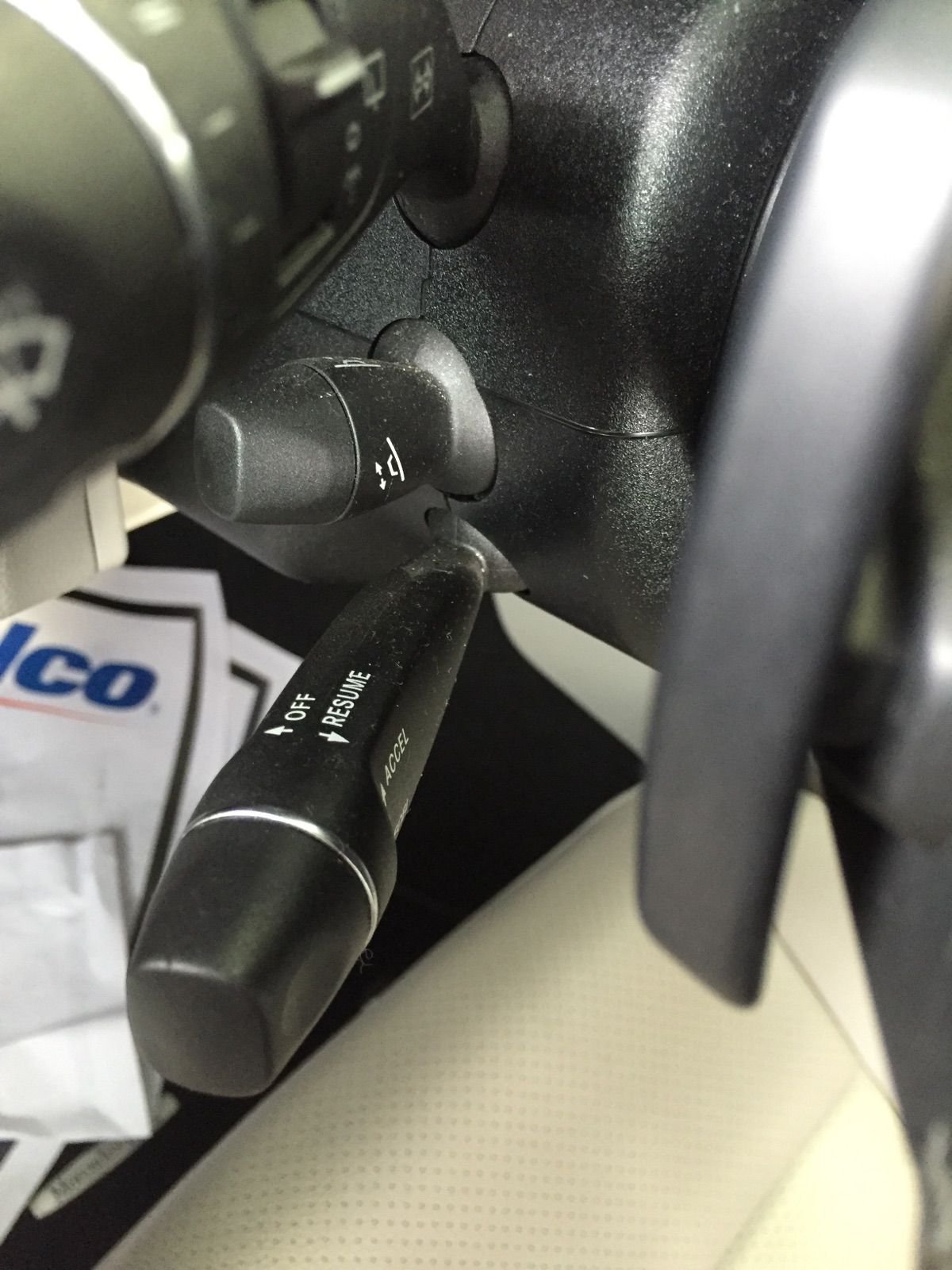

Does this 2013 GLK have Distronic Plus
Old Apr 9, 2016 | 02:36 PM
listy's Avatar
Joined: Dec 2015
Posts: 14
ford explorer
Here a photos of the cruise control. This not being sold at a Mercedes dealership, so they don't know. The Vin Decoder says
234 - BLIND SPOT ASSISTANT
615 - BI-XENON HEADLICHT W.ACTVIE CURVELIGHT RIGHT-DRIVE
476 - AUTOMATIC LANE RECOGNITION
My guess is no. What do you look for on the dash console?
http://www.mbusa.com/vcm/MB/DigitalA...l/2013_GLK.pdf page 171, the stalk looks different.
From the brochure it looks like this GLK has Lane Tracking Package and not Driver Assistant Package.

take a look at the emblem on the front if its flat its distrionic if its indented its not... the radar is located there....

Thank you, yes much simpler to determine.
