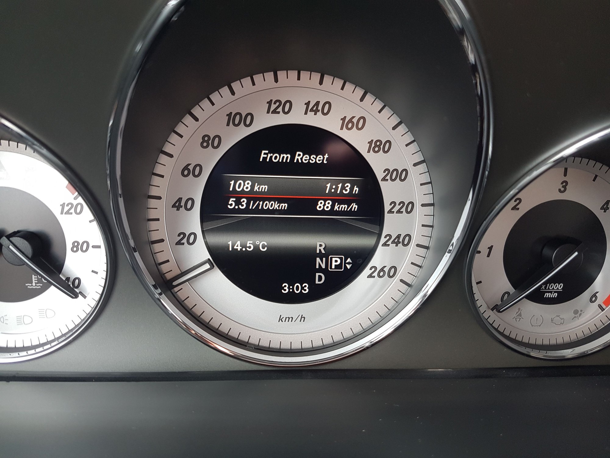

Hey guys, haven't make any post for a while now. Lately i have been focus on tuning my glk 250 for better mileage, and here is what i got so far

So hard to post a thread with my phone. Anyway, here is what I done so far. Lately i have been noticed vibrations and irregular rpm when I start my vehicle. I then cleaned my my K&N filter, maf sensor, changed fuel filter, ask Sam my tunnee to clean the manifold intake, throttle body and EGR, which still did not solve the vibration abd irregular rpm problem during the start of the vehicle. Sam suspected maybe the injectors was and he recommended a bottle of highly concentrated injector cleaner for me. After few tanks of fuel, the vibrations and irregular rpm during the start disappeared. After all the cleaning and injector clean up, now i can consistently get over 900km per tank. And today after i drove approximately 100km at speee between 100km to 110km, it said i get 5.3l per 100km and approximately 1260km left. i doubt i can get 1260, but that was really impressive to see. My next modification will be the low resistance tires. If the advertisement is true, i should be able to save additional 10% of fuel cost, which can put me under 5L per 100km, and that is my ultimate goal. Here is the picture of the injector cleaner.
