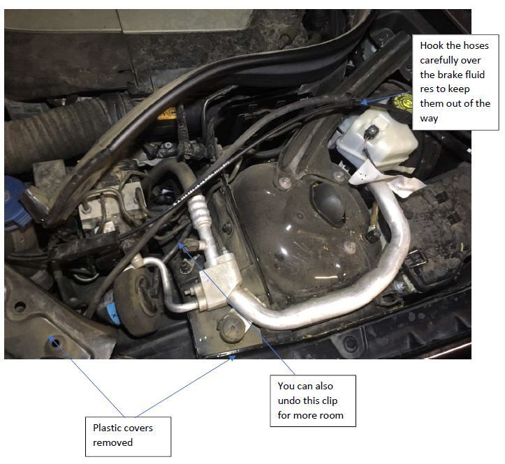

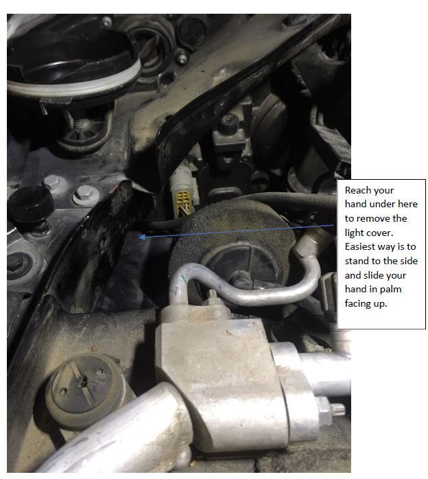

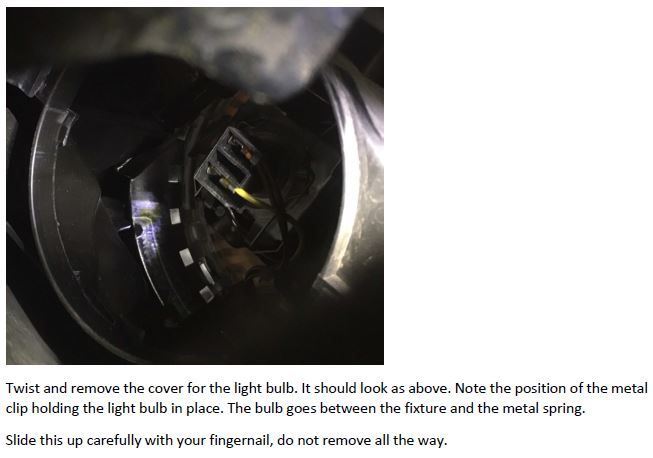

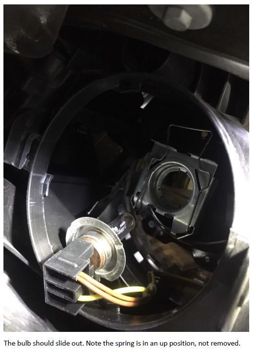

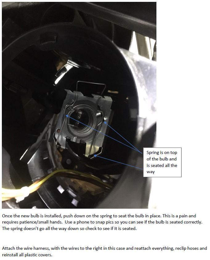

2012 GLK350 Dipped Beam Replacement WITHOUT Wheel Removal
