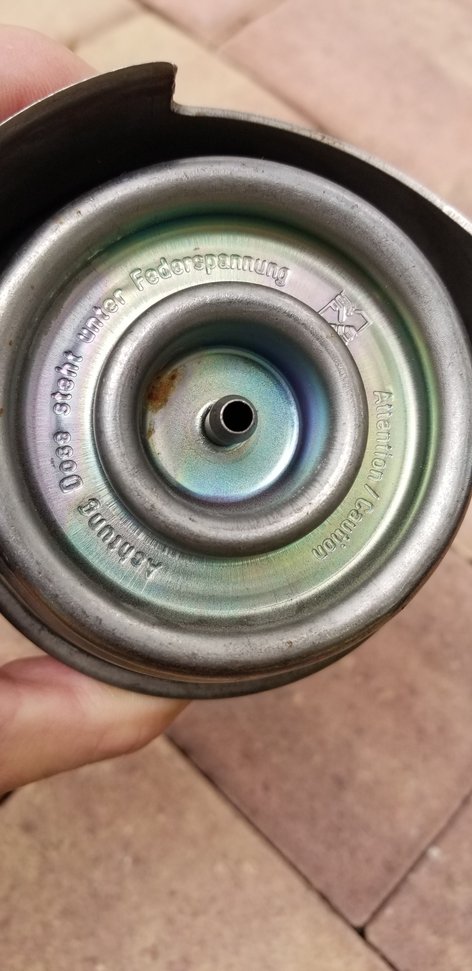

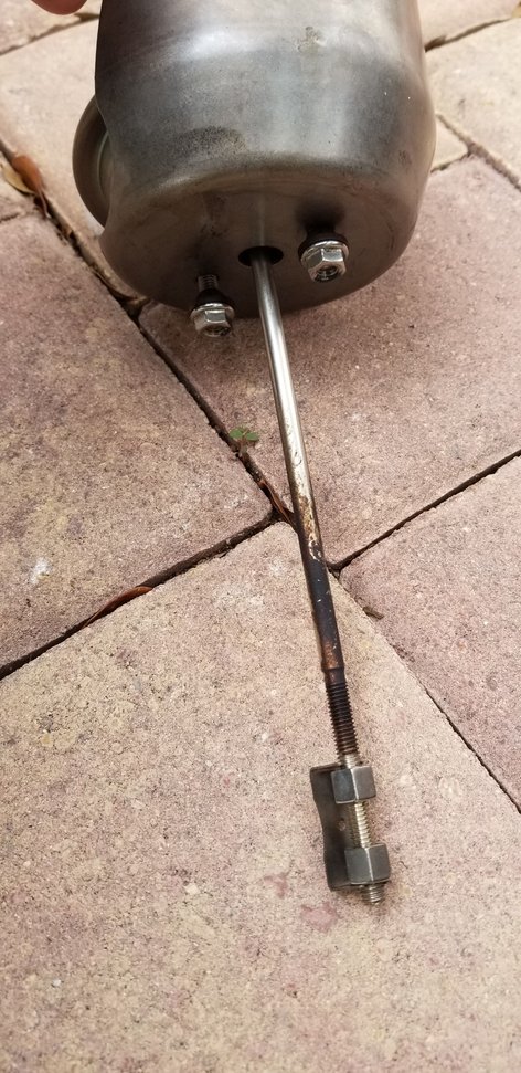

As you can see from the pictures above my car has the all plastic version of the pump and it basically seeps everywhere at this point. I have in the meantime disconnected the vacuum hose and plugged it so I don't lose any vacuum AND don't introduce any more coolant into the vacuum system. The new all aluminum pump should be here today so I can follow up once installed.
Now back to the issue with underboost - luckily for me, I also own GLK250 which has the same engine as my E250 so I would change a component one at a time (vacuum splitter first, then N75 valve) but there was no change. I only went to these lengths because the wastegate actuator for the small turbo tested good at first. Upon retesting it I noticed that it was leaking vacuum. Once i swapped the one from GLK all is well. Now I am on mission on sourcing a replacement that is not $350! I am in contact with Borg Warner directly and hoping they will answer my request for part number (the one on the car only has their logo not part number). These units are normally $60 but they are all different (spring rates) so it is important to get the right one so I don't overboost. Here are pictures of the faulty unit. As you can see it has baked oil on the rod. The unit itself was oily when removed so I am not sure if this was in the unit from factory or I am possibly dealing with oil leak into the vacuum system elsewhere. The GLK unit was dry and clean.

Interesting, thanks for the pics. Now I have more things to look for on my GLK250...
Curious what you'll find with the wastegate actuator, keep us posted and good luck.
