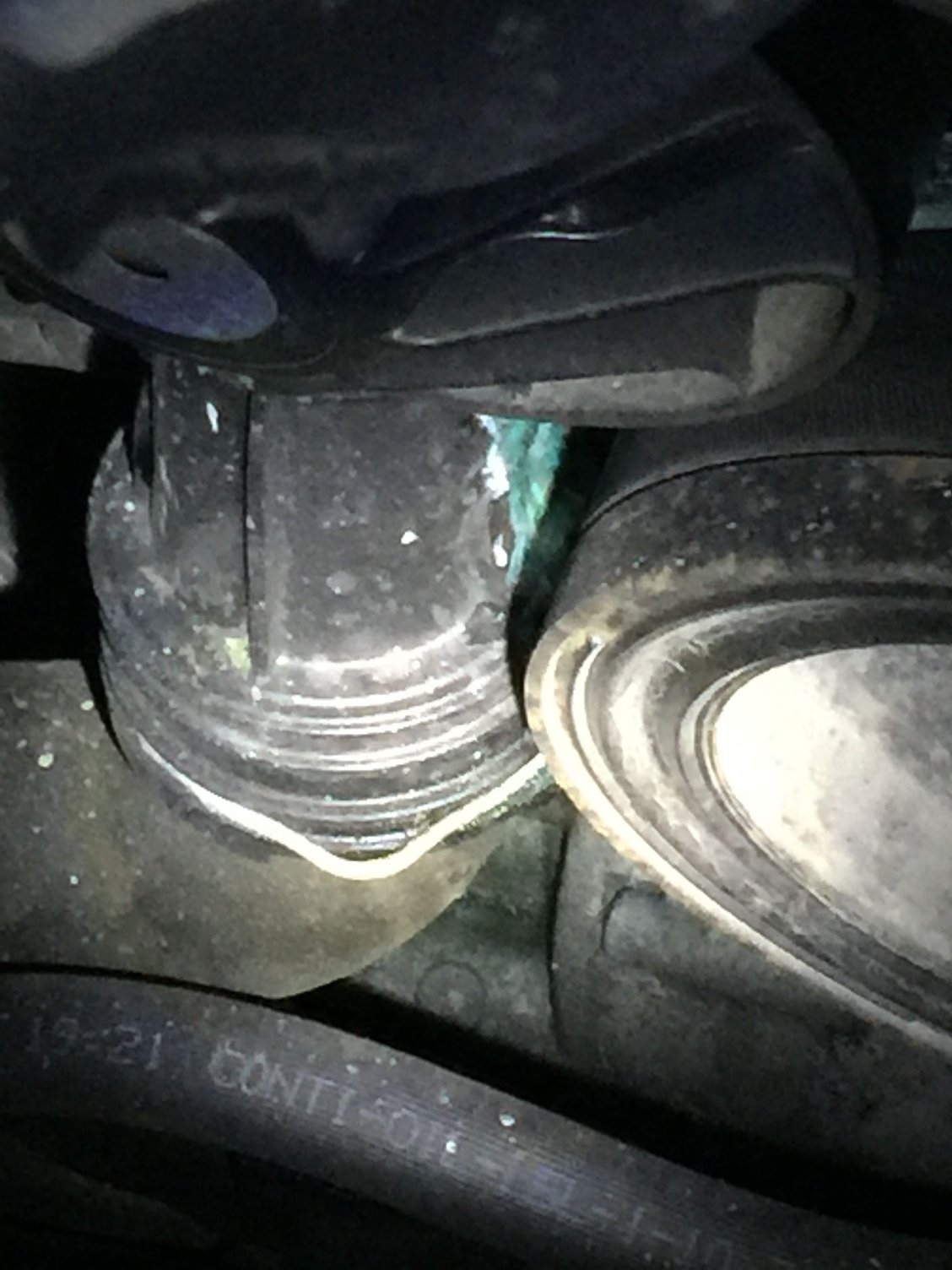

Old Nov 4, 2019 | 07:30 PM
jmow's Avatar
Joined: Oct 2017
Posts: 14
2014 e350 4matic
Old Nov 5, 2019 | 12:53 PM
bop11's Avatar
Joined: Aug 2011
Posts: 861
Likes: 38
From: Philly area
350 GLK, C280
Start looking at the dealers shop. This car is under warranty. It could be anything from a hose, water pump seal blown head gasket or cracked block or many other things. Get it on record and let an expert find the problem and fix it until it is fixed. Worst case water gets into the cylinders and you break a rod or destroy a piston.
