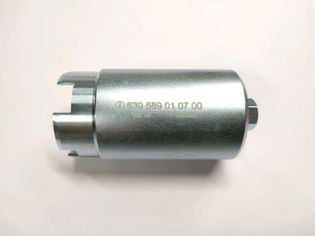

It is super easy replacement. You just need a Torx 20, a wedge, and the special mercedes four prong claw socket.

Would you happen to have a part number for the claw socket you're referring to? I'm assuming the wedge you speak of is a trim removal tool. I may attempt this myself if I can gather enough information to feel comfortable doing so. I appreciate any advice you could share. I figured there would be more DIY videos on Youtube but I haven't found many that are very good.

The socket is 639-589-01-07-00. It is also referred to as the ignition socket. I recommend picking up a cheap one on amazon.
There's a few videos that show the head unit being replaced that are insightful. Google those on youtube and if those don't help I will make one for you.

Hey I got two of them replaced. Your knowledge was very helpful. I hate prying panels off but it went well. The ignition tool was a must have item. Thanks again!!
