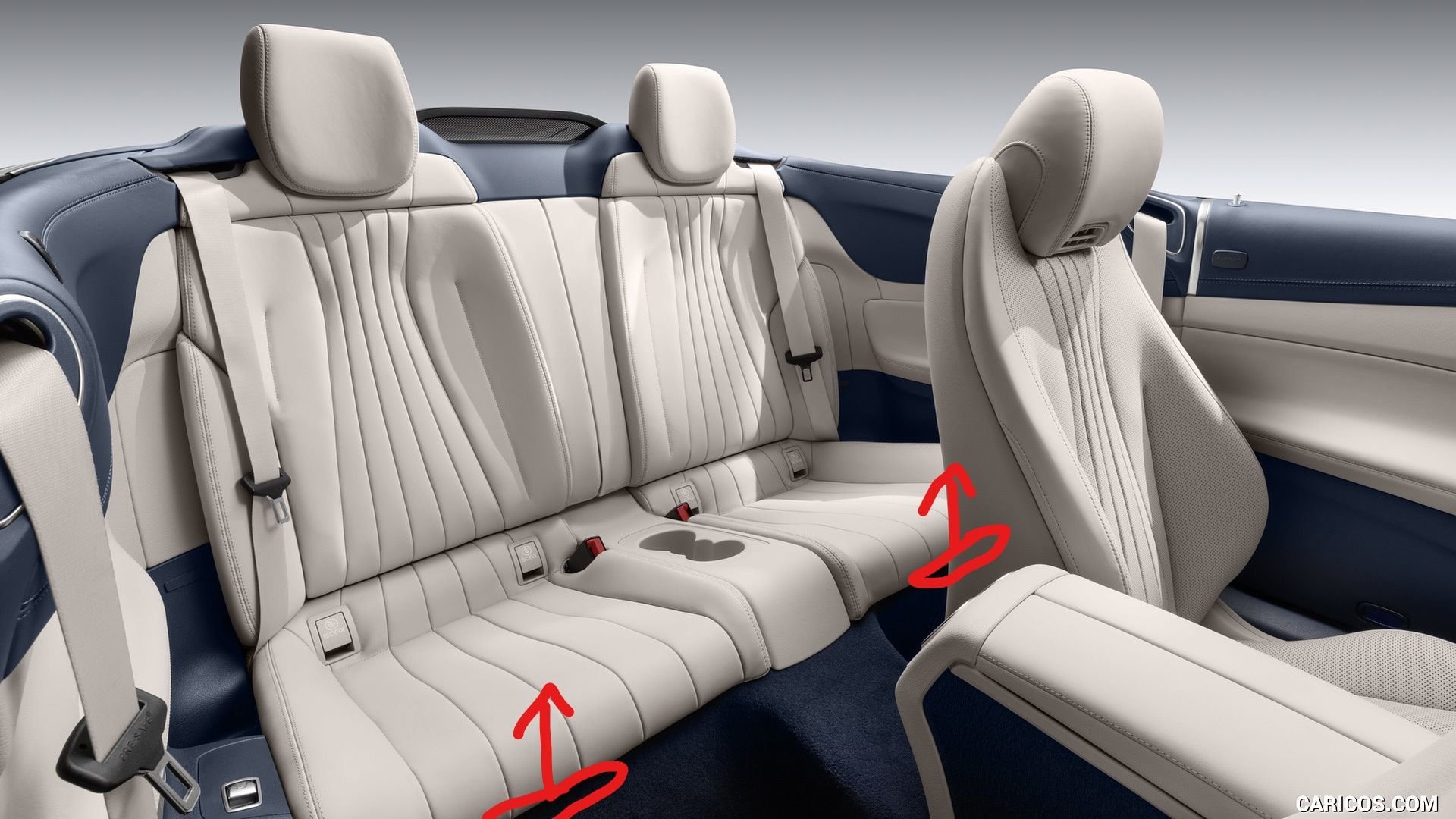

Pull up on the front left and right front of the bench seat. It will pop up and then you can just pull it our forward. Grab it with both hands together and do a hard tug up. Thats how I got it off.
Here is a pic I just used a random car.
