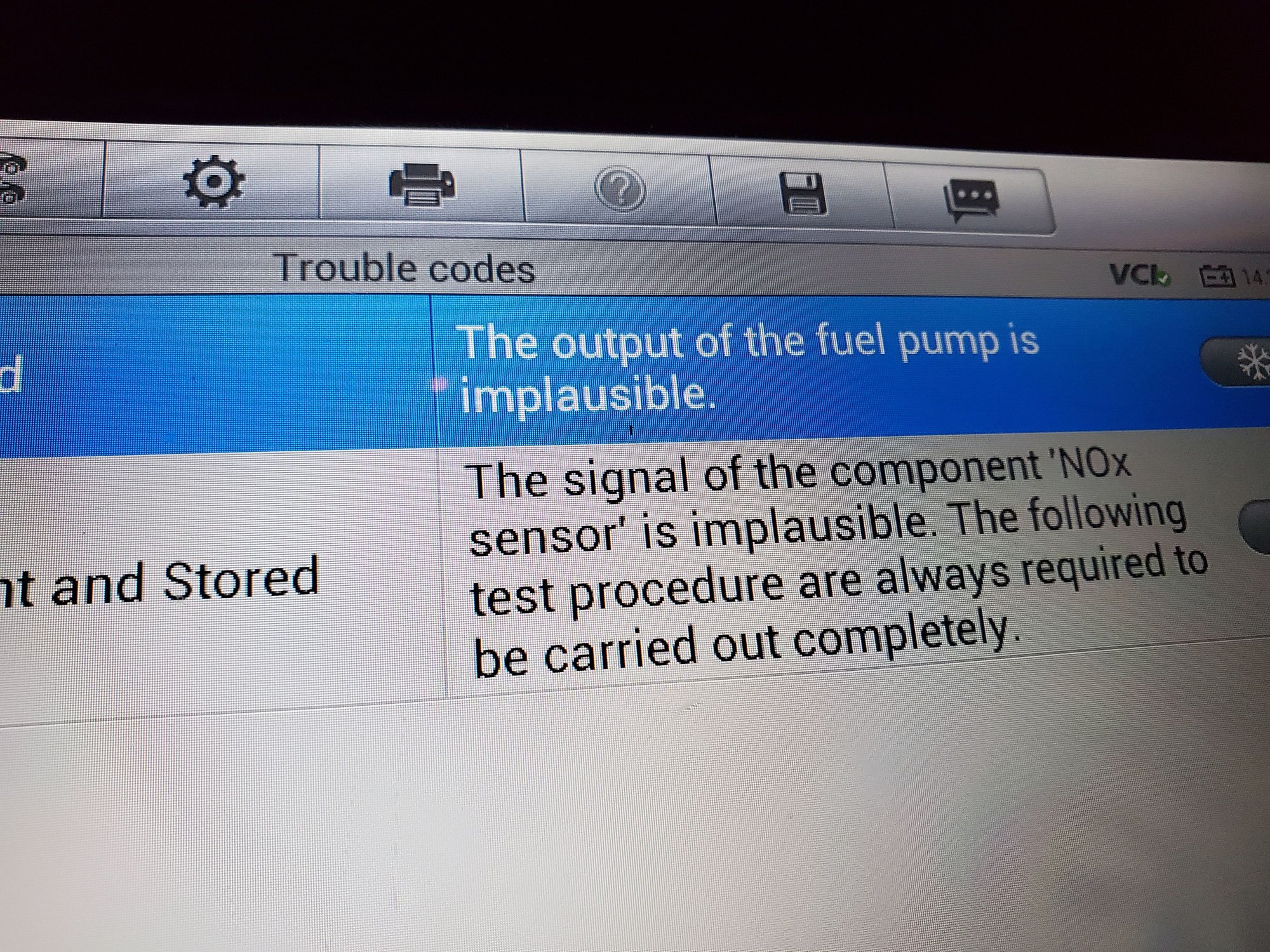

so the check light came on last Wednesday.
No problem i thought.
I was able to get access to autel maxisys scanner (original verdion with no maxiflash adapter just regular wireless breakout dongle)
Scan the codes p229fe
Thursday i swapped the sensor with a used one from wreckers.
Still no go.

Sunday i had to return the naxisys to the shop so i bought autel ap200.
reads the same live data as maxisys
Under eobd menu access the onboard diagnostics then benz then this
Exhsust temperature sensor failed one of the parameters
( which one what does it mean?)
Am i correct in thinking that this one is the one that activates the nox sensors?
Both of them?
Rear only?
