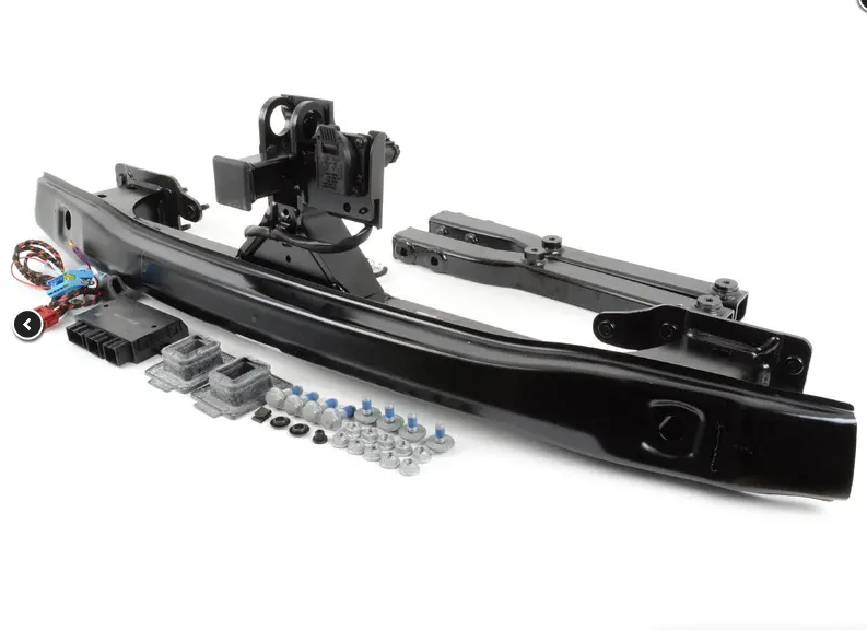

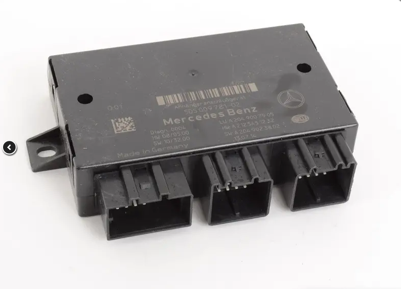

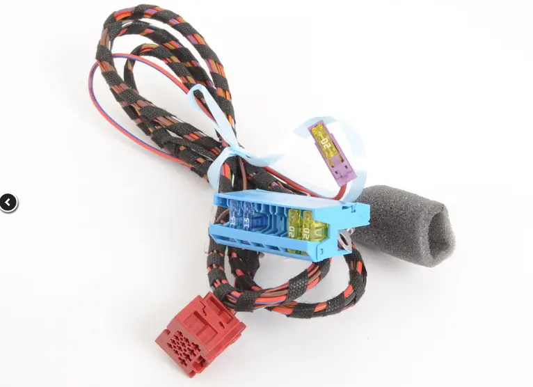

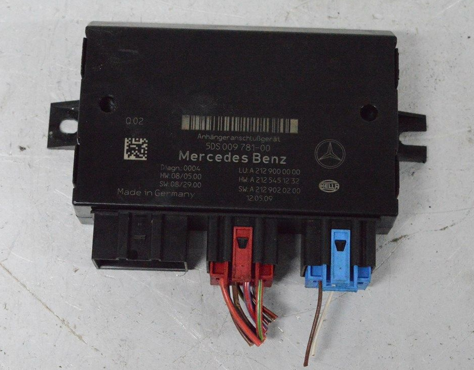

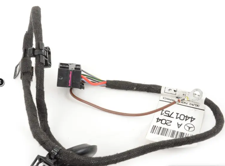

There is a lot to do here. I did this and I actually found some instructions on this forum where someone did all the work. I can't find the thread but i have the instructions. Let me know if you want them and i can send them to you through email or something. Its a word document. Also here are all the parts you need.
Attached Thumbnails GLK Tow Help-1.png   GLK Tow Help-2.png   GLK Tow Help-3.png   GLK Tow Help-4.png   GLK Tow Help-5.png
