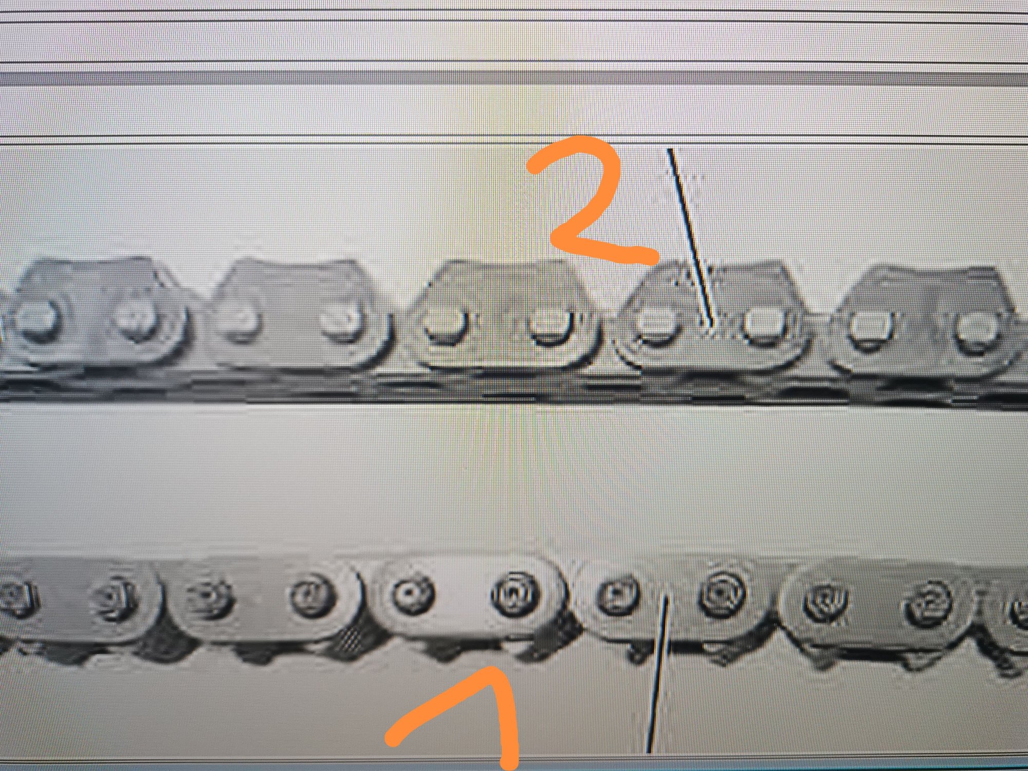

1. "old"
2. "new"
Hi
After timing chain replacement I've had troubles to find correct vvt gears because old ones (for example exhaust site A276 050 14 47) won't fit with "new" chain....
First ordered set of new ones (A276 05 03 (600, 700, 800, 900))... Did not fit at all with chain
I found only on eBay something called bergkraft(made in China??) also with parts nr. Like above but only on the bag they were put in, ordered
fitted perfect with chain, but both exhaust don't hold camshaft correct (off the tolerance).
Now I want to order new one from Mercedes part dealer, they can't say which one should be right.
Can someone give some idea how to find right parts ??
