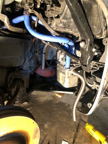

Area where the webasto will go

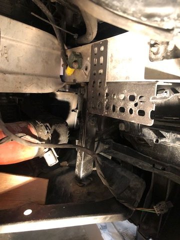

Made some aluminum brackets to bolt on to the crash bar just to test fit - will make them out of something stronger when I have everything together for the final fit.
I made 2 of these after I measured the height I wanted it installed
Here's the mock fit with a 3/4" (19mm) hose
Mock fitted
This was as far as I got. I removed the heater and reinstalled the fender liners - will need the car for work tomorrow. I still need to find harness connectors for the X1 (control wiring) and X2 (power/ground), Relay and fuses, and all the fuel side components. As mentioned before, I will use the OEM circulating pump - splice in the control relay or wiring with a diode or something. Will post more as I go.

So the webasto is in. I ended up making a bracket to permanently mount the heater, semi wired the harness and plumbed the coolant lines. I have not tap into the fuel tank yet nor have I finish wiring my controller inside the cab. Will upload more info when I get the motivation to finish.

Homemade bracket for the heater

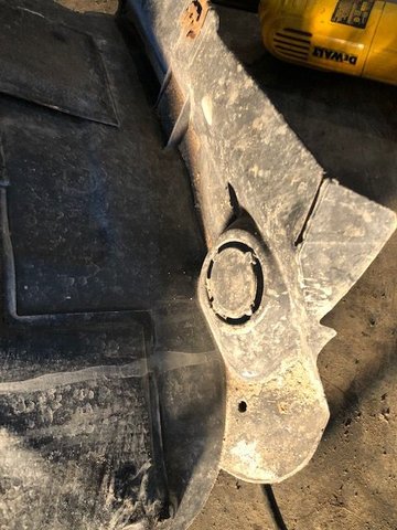

Hole already there from factory for the exhaust in the plastic liner
Coolant route
