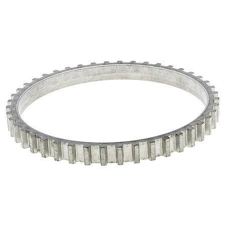

I have never heard of using a magnet for a wheel speed sensor. As stated above, there is a thing called a "tone ring" which is a big disk with regular slots cut in the outer edge creating "teeth" that pass the sensor. The sensor senses the frequency at which the cuts pass the face of the sensor and the ABS controller converts frequency into wheel RPM. It looks like this:
The only thing you can do is make sure the slots and the faces of the high spots are clean. The distance between the ring and the sensor is important. If the sensor is lifted away from the ring even a little it will give false readings.

I have seen tone wheels incorporated into bearings, but they are not magnetized. Magnets and bearings generally don't mix well. The magnet is in the sensor and the tone wheel distorts the magnetic field around the sensor which induces a current in the sensor coil.

Is this what we also call the reluctor ring? If so, seems to be a common issue on older GLKs.
