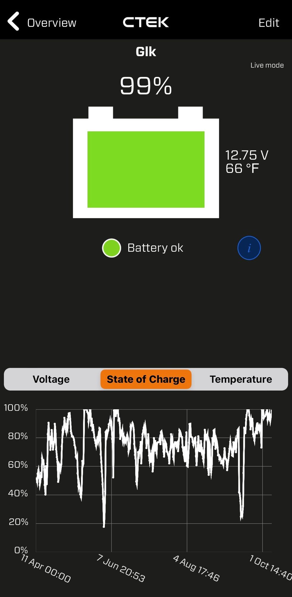

I’ve had an intermittent battery not charging, and draining for a long time , many years, it was a bad regulator that attaches to the alternator. 2013 Glk 350. The part was 100$ at fcp. Alternators are 500.00 for a Valeo, and 1,100 for MB. But the part that fails is usually the regulator , for 50- 100$.
I know it doesn’t sound like that, but what you describe doesn’t make sense to me . You should have your own volt meter and battery tester.
I had mine professionally tested, the alternator and battery tested fine. But doing my own load tests I found out it was not ok. It was never charging more than 80% and constantly dropping to 20-40%, and CCA was down by 120 over what my CTEK battery charger would bring it to, which is 99%.
I only have 72000 miles , but the Brushes only had 1/8” when the minimum is 1/4”. With mainly city driving , my 72000 miles equaled about 150,000 on the alternator . Mechanics rarely recommend replacing the Regulator. But that’s what fails.
Maybe your battery was low when you jumped it, then the alternator kicked back in.
I found my problem and diagnosed it using a remote battery monitor, that your phones Bluetooth connects to. CTEK battery monitor . Do your own tests.
When you drove it to get it tested , it just charged up. I think after sitting overnight is when tests should be done again. Maybe you have something draining it. Maybe the battery is not actually holding the charge over time. I had a new battery totally fail after about 5 months.
The graph is what a bad regulator does, all driving on the graph is the same every day , all daytime, one hour a day. A good regulator would not have those dips. Now it holds 95-99% capacity. I only replaced the regulator one week ago . Total cost with labor 150$.
MB would have been 2000.00$ ! But free coffee and donuts!

Is this the ctech?
CTEK (40-149) CTX Battery Sense - Smart Battery Monitoring on Your Mobile Phone
from Amazon
https://a.co/d/eG7ksVF
