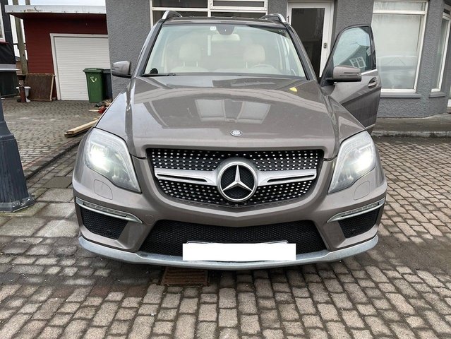

So I've got this Benz that more likely has been customised after an accident and all was okay, except windshield fluid not working. I took it to the dealership and had them replace my SAM module which they stated was faulty.
Since then, Ive received my car with a working washer, but the issue with the lights.

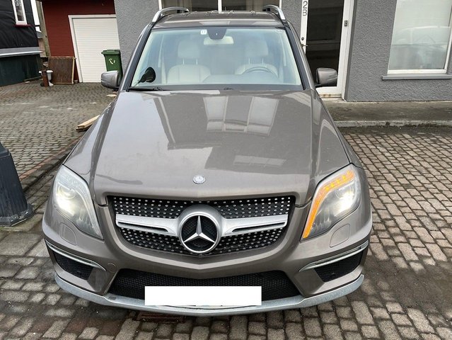

  • Currently, the only lights in the front working are low beams and main turn indicators.
  • Not working:
    • high beams
    • lower day
      led lights/running lights
    • cornering lights
    • mirror indicators
The car gives dashboard error of left and right indicators being burnt out when they are being used. And there are days when before the error appears, high beams are working.
The dealership basically said there is nothing they can do and it has something to do with the LED lights and coding. Their only suggestion would be to put the original lights back or contact the person who mounted current lights (impossible).
Since the dealership is no use, I need to go around local workshops and kinda explain to them where might be the problem and direct them to the solution. Please advise.
